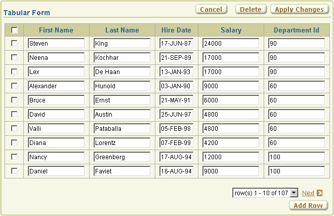

Next, run the page to view your new form.
To run the page:
  1. Click the Run Page icon as shown in Figure 2-1.
  2. If prompted to enter a user name and password, enter your workspace user name and password and click Login. See "About Application Authentication".
    The tabular form appears as shown in Figure 2-2.
As shown in Figure 2-2, note that the tabular form contains four buttons. Cancel, Delete, and Apply Changes display in the upper right corner and Add Row displays in the bottom right corner. Additionally, a check box appears to the left of each row to enable the user to select the current row. Users can also select all rows at once by selecting the check box to the left of the column headings. The same check box is also used in conjunction with the Delete button to identify the rows to be deleted.
Note that the overall form layout (that is, the color scheme, button placement, region header placement, and so on) are controlled by templates in the currently selected theme.
