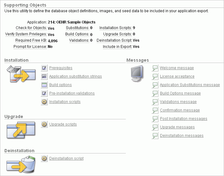

Accessing the Supporting Objects Page
You access the Supporting Object Utility on the Supporting Objects page.
To go to the Supporting Objects page:
  1. On the Workspace home page, click Application Builder.
  2. Click OEHR Sample Objects.
  3. On the Application home page, click Supporting Objects.
    The Supporting Objects page appears.
    Description of pck_supobj.gif follows
    The top of the Supporting Objects page displays a detailed report about the currently selected application, including the number of scripts and the amount of required free space. After that, the page is divided into these sections:
    • Installation
    • Upgrade
    • Deinstallation
    • Messages

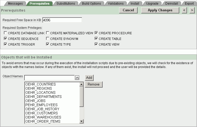

Prerequisites
Prerequisites include anything that must be valid for the installation process to continue.
To review the prerequisites:
  1. On the Supporting Object Messages page, click the Prerequisites tab.
    The Prerequisites page displays the following sections:
    • Required Free Space in KB
    • Required System Privileges
    • Objects that will be Installed
Description of pck_prerq.gif follows
About Required Free Space
If you are creating tables and loading data during the installation, you should specify the amount of required free space. If there is not enough free space available, specifying this prerequisite prevents an error during the installation of supporting objects. For the OEHR Sample Objects application, the required free space is 4800 kilobytes (KB).

About Required System Privileges
The Required System Privileges section contains a list of system privileges. If you are creating objects through installation scripts, you need to select the appropriate system privileges. Selecting these privileges runs a pre-installation check to determine if the user has the appropriate privileges. This prevents the user from creating some objects but not others due to a lack of privileges.
For the OEHR Sample Objects application, required system privileges include: CREATE SEQUENCE, CREATE TRIGGER, CREATE TYPE, CREATE PROCEDURE, CREATE TABLE, and CREATE VIEW.
About Objects Installed
The Objects that will be Installed section lists all objects that your installation script creates. If the target schema contains an object with the same name, an error displays to the user. This prerequisite prevents the user from getting errors during installation that result in some objects being created while others are not created because an object of the same name exists.
This prerequisite is important because of the deinstallation implications. If a user installs and already has an object with the same name, the deinstallation script might drop the previously existing object.
For example, if a PROJECTS table already exists and the installation script creates a table with the same name, you would want to alert users before they start the installation process. This warning provides them with the opportunity to rename their table or decide to not install supporting objects.

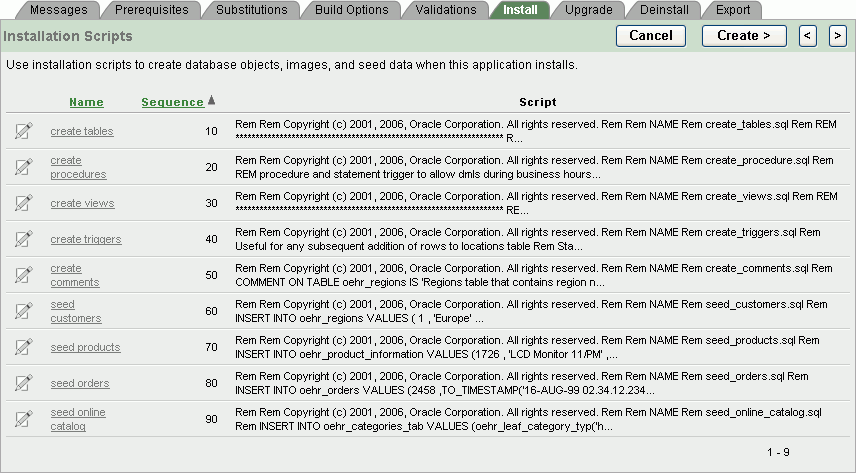

Installation Scripts
Installation scripts are the core of a supporting object installation. Each application can have several installation scripts.
The OEHR Sample Objects application contains nine installation scripts. These scripts create objects and load data.
Tip:
You can also create a custom installation script that loads files. See "About Creating Scripts to Install Files".
Topics in this section include:
View Installation Scripts
To review the installation scripts in the OEHR Sample Objects application:
  • On the Supporting Object Messages page, click the Install tab.
    The Installation Scripts page shows the list of scripts.
Description of pck_instscrpts.gif follows
Notice that each script has a name and a sequence. It is very important to order your installation scripts so that dependent objects are created or compiled correctly.
