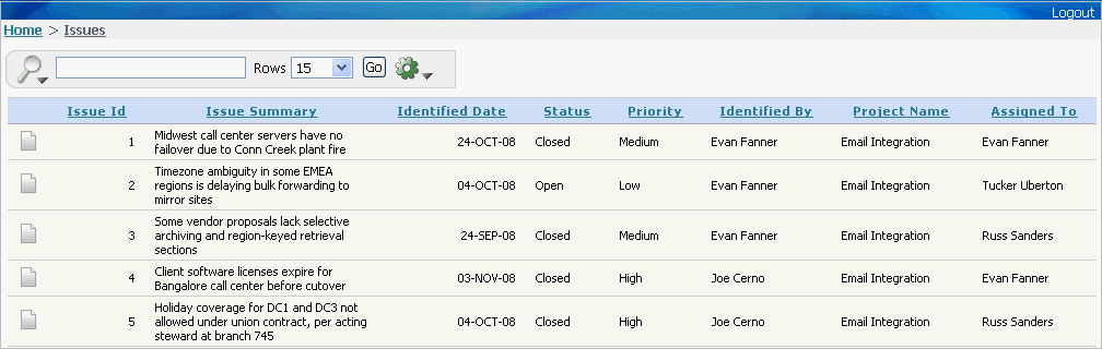

Next, run the Issues interactive report page and use the Select Columns action to include the three additional name value columns to the display.
To add columns to the display:
  1. Click the Run Page 2 icon at the top right corner of the page.
  2. Click the Actions menu to the right of the Go button as shown in Figure 4-5.
  3. Select the Select Columns action.
    Your page should look similar to Figure 4-6.
    Figure 4-6 Select Columns Action Options Page
    Description of Figure 4-6 follows
    Description of "Figure 4-6 Select Columns Action Options Page"
  4. Highlight Identified By in the Do Not Display box and click the Move icon (>).
  5. Repeat the previous step for Project Name, and Assigned To.
    The only column left in the Do Not Display box is Project Id. All other columns appear in the Display in Report list.
  6. Click Apply at the bottom right of the Select Columns area.
    Your Issues page should now look like Figure 4-7.
    Figure 4-7 Issues Report with Person and Project Names
    Description of Figure 4-7 follows
    Description of "Figure 4-7 Issues Report with Person and Project Names"

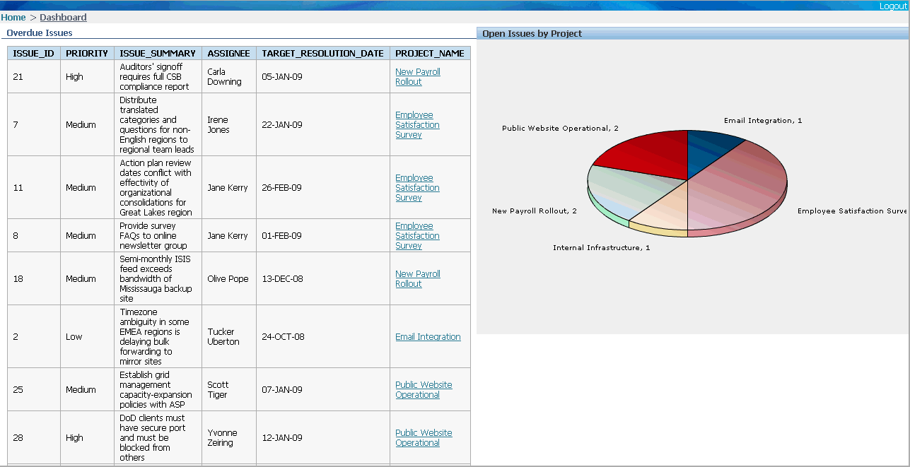

Add a Dashboard Page
The Dashboard provides a quick snapshot of important issue tracking statistics. Regions displayed on the Dashboard include:
Upon completion of this section, the application will have a Dashboard page similar to the one shown in Figure 4-8, "Dashboard".

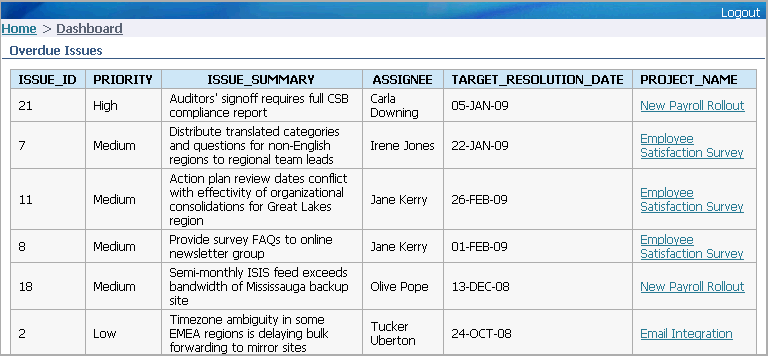

Add an Overdue Issues Report Region to the Dashboard
Next, you add a report region to the Dashboard page that displays overdue issues and then add a link from the report to the Issues interactive report.
Create an Overdue Issues Report Region
The query for this report retrieves all unclosed issues with a past target resolution date.
To add a report region:
  1. Click Edit Page 3 on the Developer Toolbar.
  2. Under Regions, click the Create icon.
  3. Select Report and click Next.
  4. For Report Implementation, select SQL Report and click Next.
  5. For Display Attributes:
    • Title - Enter Overdue Issues.
    • Region Template - Select Reports Region, Alternative 1.
    • Sequence - Enter 5.
    • Click Next.
  6. For Source, enter the following in Enter SQL Query:
    SELECT i.issue_id, i.priority, i.issue_summary,
        p.person_name assignee, i.target_resolution_date, r.project_name
    FROM it_issues i, it_people p, it_projects r
    WHERE i.assigned_to_person_id = p.person_id (+)
        AND i.related_project_id = r.project_id
        AND i.target_resolution_date < sysdate
        AND i.status != 'Closed'
    The outer join is necessary because the assignment is optional.
  7. Click Create Region.

  2. Click the Dashboard link.
    You should see the Dashboard page with the Overdue Issues region added as shown in Figure 4-10, "Dashboard with Overdue Issues Region Added". Notice the Project Names are displayed as links.
    Figure 4-10 Dashboard with Overdue Issues Region Added
    Description of Figure 4-10 follows
    Description of "Figure 4-10 Dashboard with Overdue Issues Region Added"

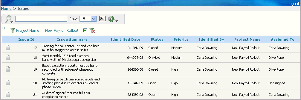

  3. Click the New Payroll Rollout project name.
    The Issues interactive report displays showing all issues categorized under the New Payroll Rollout project name.
    Figure 4-11 Issues for New Payroll Rollout
    Description of Figure 4-11 follows
    Description of "Figure 4-11 Issues for New Payroll Rollout"
    Notice the 'New Payroll Rollout' filter at the top of the report. The filter was created when the user clicked the Project Name link column.

  1. Click the Run Page 3 icon.
    The Dashboard displays with the added pie chart region.
    Figure 4-12 Final Dashboard with Both regions Added
    Description of Figure 4-12 follows
    Description of "Figure 4-12 Final Dashboard with Both regions Added"

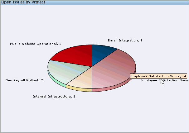

  2. On the pie chart, locate the Employee Satisfaction Survey project link as shown in Figure 4-13.
    Figure 4-13 Dashboard Open Issues by Project Pie Chart
    Description of Figure 4-13 follows
    Description of "Figure 4-13 Dashboard Open Issues by Project Pie Chart"

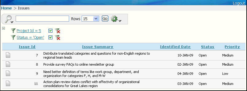

  3. Click the Employee Satisfaction Survey project link.
    The Issues report for all Employee Satisfaction Survey issues with a status of Open appears as shown in Figure 4-14.
    Figure 4-14 Issues Report for Open Employee Satisfaction Survey Issues
    Description of Figure 4-14 follows
    Description of "Figure 4-14 Issues Report for Open Employee Satisfaction Survey Issues"
    Notice the filters in the report settings section. The Issues report has been filtered by project and by status.
