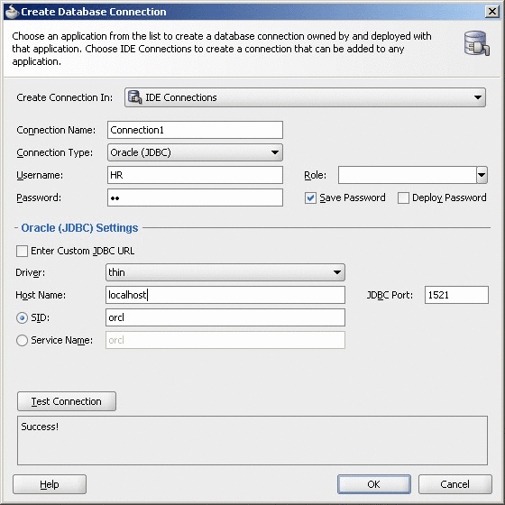

3.1.2 Creating a Database Connection
You can connect to any database for which you have connection details. When you create a database connection, you must specify a user name and a password. By default, the connection allows you to browse only the schema of the user that you specify in the connection.
To create a connection, follow these steps:
  1. Start JDeveloper.
  2. From the View menu select Database Navigator. The Database Navigator is displayed, showing you a list of available connections.
  3. Right-click IDE Connection, and from the shortcut menu, select New Connection. The Create Database Connection screen is displayed.
  4. On the Connection screen, do not change the default values for the connection name and type, Connection1 and Oracle (JDBC). Enter HR in both the Username and Password fields. Do not enter a value for Role, and select Deploy Password. You must provide information about the computer where your database is located. Your database administrator should provide you with this information.
    Enter the following information:
    • Driver: thin
    • Host Name: Host name of the computer where Oracle Database is installed
      If database is on the same computer, then for the Host Name parameter, enter localhost.
    • JDBC Port: 1521
    • SID: ORCL
    Click Test Connection. If the connection is successful, the word Success! is displayed in the Status field.
    Figure 3–1 shows the Connection screen where you enter these details.
    Figure 3-1 Specifying Connection Details
    Description of Figure 3-1 follows
    Description of "Figure 3-1 Specifying Connection Details"
  5. Click Finish to create the connection and close the screen.

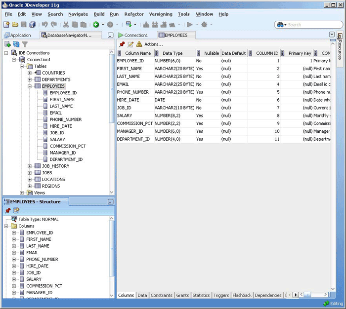

3.1.3 Browsing the Data Using the Database Navigator
After you have successfully established a connection to the database, you can browse its contents through the Database Navigator. The Database Navigator displays a navigable, hierarchical tree structure for the database, its objects, their instances, and the contents of each. To view the contents at each level of the hierarchy of the database connection that you created, do the following:
  1. The IDE Connections node in the Database Navigator now shows a node with the name of your connection. Click the plus symbol (+) to the left of the connection name to expand the navigation tree. To display a list of the instances of an object type, for example Tables, expand the Table navigation tree.
  2. The Structure window below the navigator shows the detailed structure of any object selected in the navigator. Select a table in the navigator (for example Employees) to see the columns of that table in the Structure window.
    Figure 3-2 Accessing Database Objects in the Database Navigator
    Description of Figure 3-2 follows
    Description of "Figure 3-2 Accessing Database Objects in the Database Navigator"
  3. Figure 3-3 Viewing the Table Structure and Data
    Description of Figure 3-3 follows
    Description of "Figure 3-3 Viewing the Table Structure and Data"
  4. If you double-click a table in the navigator, the structure of that table is displayed in the main editing area of the window. It includes details about all the columns, such as Name, Type, and Size, so you can browse the table definition.
    To view the data from a table, select the Data tab below the table structure. You can now view and browse through the table data.
  5. You can also edit the objects in the Database Navigator. To edit a table, right-click the table and select Edit from the shortcut menu. A dialog box allows you to make changes to the selected table.

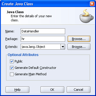

3.3.3 Creating a Java Class in JDeveloper
The first step in building a Java application is to create a Java class. The following instructions describe how you create a class called DataHandler, which will contain the methods for querying the database and modifying the data in it.
  1. In the Application Navigator, right-click the View project, and from the shortcut menu, select New.
  2. In the New Gallery, select the General category. In the Items list, select Java Class, and click OK. The Create Java Class dialog box is displayed.
  3. In the Create Java Class dialog box, enter DataHandler as the class Name, and hr as the Package. Do not change the default values of the Optional Attributes, and click OK. The Create Java Class dialog box with the appropriate values specified is shown in Figure 3-6.
    Figure 3-6 Creating a Java Class
    Description of Figure 3-6 follows
    Description of "Figure 3-6 Creating a Java Class"
  4. The skeleton DataHandler class is created and is displayed in the Java Source Editor. The package declaration, the class declaration, and the default constructor are created by default. Figure 3-7 shows the class displayed in the Java Source Editor, ready for you to add your Java code:

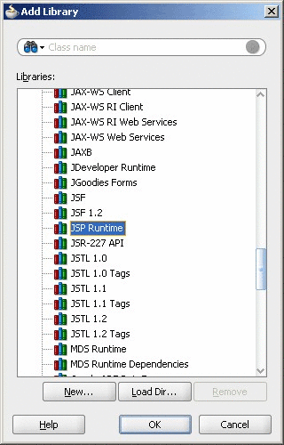

3.3.4 Java Libraries
Oracle JDeveloper comes with standard libraries to help Java application programming. These libraries include API support for Application Development Framework (ADF), Oracle libraries for JDBC, JSP, and so on.
To use JDBC in your project, you import the Oracle JDBC library into the project. Similarly, to use JSP technology, you import the JSP Runtime library.

3.3.5 Adding JDBC and JSP Libraries
To include libraries in your project, perform the following steps:
  1. Double-click the View project in the Application Navigator to display the Project Properties dialog box.
  2. Click Libraries and Classpath, and then click Add Library. The Add Library dialog box is displayed with a list of the available libraries for the Java2 Platform, Standard Edition (J2SE) version is displayed.
  3. In the Add Library dialog box, scroll through the list of libraries in the Extension folder. Select the JSP Runtime library and click OK to add it to the list of selected libraries for your project. Similarly, add the Oracle JDBC library. Figure 3-8 shows the Oracle JDBC library added to the view project.
    Figure 3-8 Importing Libraries
    Description of Figure 3-8 follows
    Description of "Figure 3-8 Importing Libraries"
  4. Click OK.
