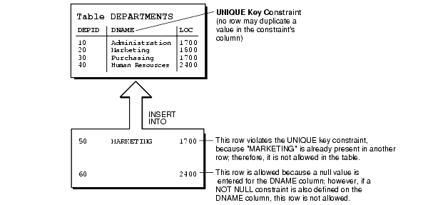

Use a UNIQUE constraint (which designates a unique key) on any column or combination of columns (except the primary key) where duplicate non-NULL values are not allowed. For example:
| Unique Key | Primary Key |
| Employee Social Security Number | Employee number |
| Truck license plate number | Truck number |
| Customer phone number (country code column, area code column, and local phone number column) | Customer number |
| Department name column and location column | Department number |
Figure 5-1 shows a table with a UNIQUE constraint, a row that violates the constraint, and a row that satisfies it.
Figure 5-1 Rows That Violate and Satisfy a UNIQUE Constraint

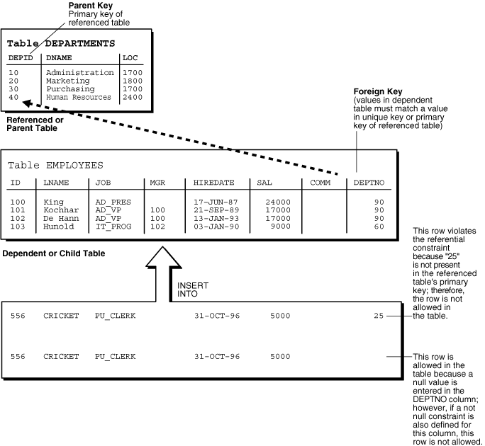

When two tables share one or more columns, you use can use a FOREIGN KEY constraint to enforce referential integrity—that is, to ensure that the shared columns always have the same values in both tables.
AFOREIGN KEY constraint is also called a referential integrity constraint, and its CONSTRAINT_TYPE is R in the static data dictionary views *_CONSTRAINTS.Designate one table as the referenced or parent table and the other as the dependent or child table. In the parent table, define either a PRIMARY KEY or UNIQUE constraint on the shared columns. In the child table, define a FOREIGN KEY constraint on the shared columns. The shared columns now comprise a foreign key. Defining additional constraints on the foreign key affects the parent-child relationship—for details, see "Defining Relationships Between Parent and Child Tables".
Figure 5-2 shows a foreign key defined on the department number. It guarantees that every value in this column must match a value in the primary key of the department table. This constraint prevents erroneous department numbers from getting into the employee table.
Figure 5-2 shows parent and child tables that share one column, a row that violates the FOREIGN KEY constraint, and a row that satisfies it.
Figure 5-2 Rows That Violate and Satisfy a FOREIGN KEY Constraint

Foreign keys allow key values that are all NULL, even if there are no matching PRIMARY or UNIQUE keys.
By default (without any NOT NULL or CHECK clauses), the FOREIGN KEY constraint enforces the match none rule for composite foreign keys in the ANSI/ISO standard.
To enforce the match full rule for NULL values in composite foreign keys, which requires that all components of the key be NULL or all be non-null, define a CHECK constraint that allows only all nulls or all non-nulls in the composite foreign key. For example, with a composite key comprised of columns A, B, and C:
CHECK ((A IS NULL AND B IS NULL AND C IS NULL) OR
(A IS NOT NULL AND B IS NOT NULL AND C IS NOT NULL))
In general, it is not possible to use declarative referential integrity to enforce the match partial rule for NULL values in composite foreign keys, which requires the non-null portions of the key to appear in the corresponding portions in the primary or unique key of a single row in the referenced table. You can often use triggers to handle this case, as described in Oracle Database PL/SQL Language Reference.

FOREIGN KEY constraints enforce relationships between columns in different tables. Therefore, they cannot be enabled if the constraint of the referenced primary or unique key is not present or not enabled.
You must use the same data type for corresponding columns in the dependent and referenced tables. The column names need not match.
Because foreign keys reference primary and unique keys of the parent table, and PRIMARY KEY and UNIQUE key constraints are enforced using indexes, composite foreign keys are limited to 32 columns.
If the column list is not included in the REFERENCES option when defining a FOREIGN KEY constraint (single column or composite), then Oracle Database assumes that you intend to reference the primary key of the specified table. Alternatively, you can explicitly specify the column(s) to reference in the parent table within parentheses. Oracle Database automatically checks to verify that this column list references a primary or unique key of the parent table. If it does not, then an informative error is returned.
To create a FOREIGN KEY constraint, the creator of the constraint must have privileged access to the parent and child tables.
Parent Table The creator of the referential integrity constraint must own the parent table or have REFERENCES object privileges on the columns that constitute the parent key of the parent table.
Child Table The creator of the referential integrity constraint must have the ability to create tables (that is, the CREATE TABLE or CREATE ANY TABLE system privilege) or the ability to alter the child table (that is, the ALTER object privilege for the child table or the ALTER ANY TABLE system privilege).
In both cases, necessary privileges cannot be obtained through a role; they must be explicitly granted to the creator of the constraint.
These restrictions allow:
The owner of the child table to explicitly decide which constraints are enforced and which other users can create constraints
The owner of the parent table to explicitly decide if foreign keys can depend on the primary and unique keys in her tables
Oracle Database allows different types of referential integrity actions to be enforced, as specified with the definition of a FOREIGN KEY constraint:
Prevent Delete or Update of Parent Key The default setting prevents the deletion or update of a parent key if there is a row in the child table that references the key. For example:
CREATE TABLE Emp_tab ( FOREIGN KEY (Deptno) REFERENCES Dept_tab);
Delete Child Rows When Parent Key Deleted The ON DELETE CASCADE action allows parent key data that is referenced from the child table to be deleted, but not updated. When data in the parent key is deleted, all rows in the child table that depend on the deleted parent key values are also deleted. To specify this referential action, include the ON DELETE CASCADE option in the definition of the FOREIGN KEY constraint. For example:
CREATE TABLE Emp_tab ( FOREIGN KEY (Deptno) REFERENCES Dept_tab ON DELETE CASCADE);
Set Foreign Keys to Null When Parent Key Deleted The ON DELETE SET NULL action allows data that references the parent key to be deleted, but not updated. When referenced data in the parent key is deleted, all rows in the child table that depend on those parent key values have their foreign keys set to null. To specify this referential action, include the ON DELETE SET NULL option in the definition of the FOREIGN KEY constraint. For example:
CREATE TABLE Emp_tab ( FOREIGN KEY (Deptno) REFERENCES Dept_tab ON DELETE SET NULL);
