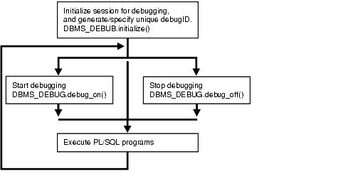

There are two ways to ensure that debug information is generated: through a session switch, or through individual recompilation.
To set the session switch, enter the following statement:
ALTER SESSION SET PLSQL_DEBUG = true;
This instructs the compiler to generate debug information for the remainder of the session. It does not recompile any existing PL/SQL.
To generate debug information for existing PL/SQL code, use one of the following statements (the second recompiles a package or type body):
ALTER [PROCEDURE | FUNCTION | PACKAGE | TRIGGER | TYPE] <name> COMPILE DEBUG;
ALTER [PACKAGE | TYPE] <name> COMPILE DEBUG BODY;
Figure 52-1 and Figure 52-2 illustrate the flow of operations in the session to be debugged and in the debugging session.
Figure 52-1 Target Session
Description of Figure 52-1 follows
Description of "Figure 52-1 Target Session"

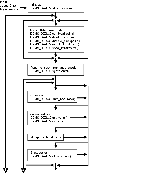

Figure 52-2 Debug Session
Description of Figure 52-2 follows
Description of "Figure 52-2 Debug Session"

Control of the Interpreter
The interpreter pauses execution at the following times:
  1. At startup of the interpreter so any deferred breakpoints may be installed prior to execution.
  2. At any line containing an enabled breakpoint.
  3. At any line where an interesting event occurs. The set of interesting events is specified by the flags passed to DBMS_DEBUG.CONTINUE in the breakflags parameter.
