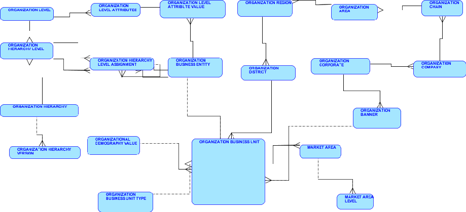

In this business use case you build up the organization SuperTelco as a PARTY in the data model. The SuperTelco Communications organization comprises two business units:
Oracle Communications Data Model captures the following administrative functions for the Mobile and Broadband business units:
Sample Use Case 2: Setting Up the Business Unit Organization
To work with the sample use case you need to fill in table details and organize tables. In this sample business use case you build up the organization SuperTelco as a PARTY in the Oracle Communications Data Model. SuperTelco Communications comprises two business units, as shown in Figure B-1.
Figure B-1 Organization Business Units in Sample Use Case
Description of Figure B-1 follows
Description of "Figure B-1 Organization Business Units in Sample Use Case"
To work with the sample use case you build up the organization SuperTelco as a PARTY in the Oracle Communications Data Model:
  1. There are two ways to store the information for an ORGANIZATION BUSINESS UNIT:
    • Using a standard pre-defined hierarchy
    • Using a flexible hierarchy
  2. As shown in Figure B-1, the business unit follows a simple hierarchy stored in the corresponding tables:
  3. As shown in Figure B-1, the business unit follows a flexible hierarchy stored in the corresponding tables:
Of these two choices: simple hierarchy and flexible hierarchy, the SuperTelco sample use case uses the flexible hierarchy. This is the preferred hierarchy for this sample because for this sample, the historic growth of SuperTelco specifies that the hierarchy changes over time. To deal with the geographical organization of the SuperTelco stores dispatched in the country however, the standard hierarchy could be used. Such a hierarchy would support a detailed analysis of the local and geographical differences for the impact of a national marketing campaign.

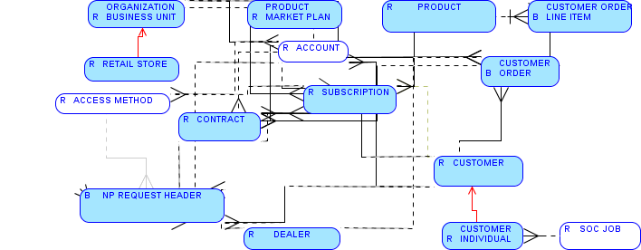

Sample Use Case 3: Acquiring a New Customer (with Family Plan)
To provide a new customer for the sample use case, the father goes to a SuperTelco dealer and asks for a Family Plan offering with the following features:
The father is moving his service from a competitor and wants to keep his current mobile number (number portability required). This example provides details on the information stored in the various contract, account, customer, and party entities. The actions covered in this area include the following, as shown in Figure B-2.
Figure B-2 Customer Acquisition: Family Plan Model
Description of Figure B-2 follows
Description of "Figure B-2 Customer Acquisition: Family Plan Model"
New Family Plan Data:
  1. The ORGANIZATION BUSINESS UNIT information was previously setup, as described in "Sample Use Case 2: Setting Up the Business Unit Organization".
  2. To acquire a customer, using a custom ETL to the CRM or to the billing system to feed Oracle Communications Data Model, one record in CUSTOMER is inserted with a name, for example "Tom Daniels", of type "individual". Usually customers are not required to provide additional user information when purchasing multiple numbers. If this information is provided, you can save the information with the PARTY entity.
  3. Save the related information about a customer, such as profession, age, education, and other information in the related CUSTOMER tables, the referential lookup tables, such as SOC JOB ("Standard Occupational Classification" system for the work activity of the individual customer). Note that you save confidential information such as the date of birth in a special table called CUSTOMER RESTRICTED INFO.
  4. A contract between Tom Daniels and SuperTelco is set up in the CONTRACT table. The customer has a contract with the Service Provider which defines the accounts (normally with a unique login or a unique identifier). For example this sample contract is based on a special package "PKG_Mobile_300". The product packages available to individual consumers are saved in the PRODUCT MARKET PLAN entity.
  5. One customer account is inserted into the ACCOUNT entity, with the customer key pointing to the new customer instance.
  6. The customer, Tom Daniels, has selected four different handsets (stored in the EQUIPMENT table; this is not visible on the diagram shown in Figure B-2).
  7. Four Mobile phone numbers are saved into the table ACCESS METHOD and the associated handset. Each phone number uses the current date for the effective date and also has the account ID pointing to the account (as the account ID was set up).
  8. A customer order, stored in the CUSTOMER ORDER entity, is generated with all the items that the customer ordered including mobile numbers, product packages, and so on.
  9. A number portability request is triggered by the order and number portability event is stored in the NP REQUEST HEADER table. Due to the number portability request, the customer order may be processed with some delay; the old network provider must respond positively to SuperTelco's number portability request. In this case, either only Tom Daniels's IMSI or all IMSIs related to Tom Daniels will be activated after the contract date ("today"). In this case, an additional, custom ETL to the mediation or provisioning system may be necessary.
  10. Four subscriptions are inserted into the SUBSCRIPTION table. A subscription is considered a "non-network event" as opposed to a call, which is a "network event". Each subscription associates one product, one customer, one account, and one ACCESS METHOD (mobile number).
  11. Once the customer order is fulfilled in the BSS/OSS systems, the customer order is loaded into Oracle Communications Data Model through the Extract-Transform-Load scripts (ETL).
  12. A customer order fulfillment automatically impacts the data mining tables related to the customer segmentation, market share, and the revenue OLAP cubes (due to the number portability the competitor looses one customer and SuperTelco wins one customer in the given segment).
  13. In the pure prepaid case, no bill is created. However, the purchase of a voucher for any type of prepaid services: PayTV, Music downloads, Prepaid card with handset, and so on, or the recharge will be recorded and an account is created, similarly to the postpaid case.

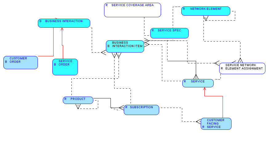

Sample Use Case 4: Service Implementation
After Tom Purchased the family plan, made the payment, and the customer order is generated, the provisioning engine take over.
The service implementation is stored with Oracle Communications Data Model as shown in Figure B-4.
Figure B-3 Service Implementation
Description of Figure B-3 follows
Description of "Figure B-3 Service Implementation"
For the service implementation, the provisioning engine does the following:
  1. Each "customer Order" is disassembled into multiple "Service Order", each of which is used by the provisioning engine to orchestrate the whole system. Each "Service Order" is normally corresponding to a specific "Network Element" or a group of "Network Element". For example, one customer order of Prepaid GSM phone can be fulfilled by multiple "Service Order", including setup account in BRM system, setup account in Intelligent Network system, fill in account information into CRM system, and so on.
  2. Once the "Service Order" is executed, some services may be generated. The service may be "customer facing service", which is an internal presentation of "Subscription". The business user sees each product realization on each customer as a "subscription" to track the business usage, while the technical take a customer usage of a "network element" (including logical "network element" like phone numbers) as a "Service".
  3. In case any "Network Element" failed, technical support can easily track which customers or accounts may be affected by following relationships from "network element" to "Service" and then to "Subscription".

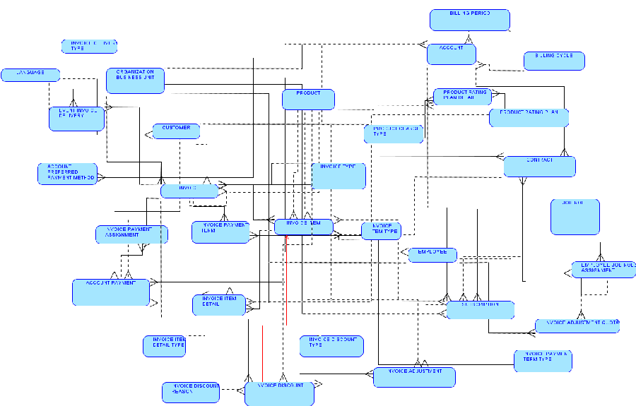

Sample Use Case 6: Customer Billing
At the end of each month SuperTelco runs the billing process over the calling records for the customer and generates an invoice. For example, the customer then receives an invoice of $100 for all the phone numbers. Then the customer, Tom Daniels, pays SuperTelco within one month or the service could be suspended.
Oracle Communications Data Model stores the customer billing, invoice, and payment information as shown in Figure B-5.
Figure B-5 Billing and Payment Data Model
Description of Figure B-5 follows
Description of "Figure B-5 Billing and Payment Data Model"
Billing Data in Oracle Communications Data Model:
  1. The section, "Sample Use Case 5: Storing Customer Call Data", describes the collection of call data records data.
  2. To store the details of the product charging information, Oracle Communications Data Model uses the PRODUCT sub-entities such as: PRODUCT RATING PLAN, PRODUCT RATING PLAN DETAIL and PRODUCT CHARGE TYPE.
  3. Each ACCOUNT is billed independently. If a customer owns multiple accounts, multiple INVOICEs are generated in the same month.
  4. An account may have a different billing period than other associated accounts. A billing period may be specified monthly, bi-weekly, and so on.
  5. After the billing and invoicing has occurred in the billing system, for each postpaid customer, the INVOICE, INVOICE ITEM and INVOICE ITEM DETAIL store all the information for the invoice for the given billing period (usually this is a month). The term at which the customer has to pay the invoice is saved in the INVOICE PAYMENT TERM TYPE associated with each invoice (for example, one month). The term is fixed when the contract is signed.
  6. In case a discount or adjustment is applied on the invoice, this information is stored in the corresponding table (INVOICE DISCOUNT or INVOICE ADJUSTMENT). An EMPLOYEE can make invoice adjustments to the amount limited by INVOICE ADJUSTMENT QUOTA.
  7. Once the invoice is delivered to Tom Daniels, this "non-network event" is stored in the EVENT INVOICE DELIVERY.
  8. The ACCOUNT PREFERRED PAYMENT METHOD stores the payment method chosen when the contract was signed and this method is the default for the payment transaction.
  9. When Tom Daniels pays the invoice, for example using a bank transfer, the payment is stored in ACCOUNT PAYMENT and assigned to the corresponding open invoice. The ACCOUNT PAYMENT is stored into the INVOICE PAYMENT ASSIGNMENT.
  10. The difference between the INVOICE amount and the payment adds to the debt (the debt is not shown in Figure B-5).
Note: for the revenue assurance sub-area and its corresponding reports, it is important to store the itemized bill in Oracle Communications Data Model. The usage items can then be compared, one by one, with the rated CDRs and using this method you can find the difference between rated and billed revenue.

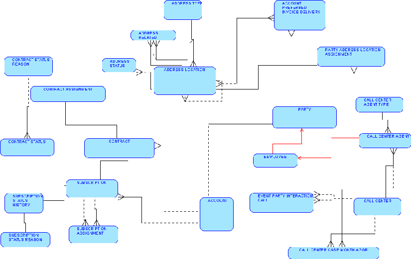

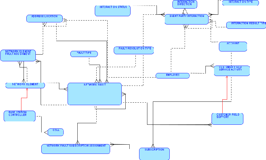

Sample Use Case 7: Changing Plan and Billing Address
After acquiring the broadband business, SuperTelco launches a campaign to promote a package with converged broadband and mobile services. Tom Daniels sees the promotion message, delivered through an SMS campaign, and decides to take advantage of the promotion. He calls the call center and asks to change his product package to obtain the new converged family plan that includes broadband services. Also, using the SuperTelco Web Self-Service Interface he changes his billing address.
The section, "Sample Use Case 8: Targeted Promotion for Video-on-Demand Services" shows a campaign set-up with the prospect choice. For this campaign, a measure of the campaign success could be obtained by analyzing the number of subscribers who contact the call center and request a product change based on the promotion, as a factor of time, in hours or days, between sending the promotion and customer call-back.
SuperTelco uses Oracle Communications Data Model to store this customer interaction as shown in Figure B-6 and as outlined in the corresponding steps.
Figure B-6 Changing Plan and Billing Address Data Model
Description of Figure B-6 follows
Description of "Figure B-6 Changing Plan and Billing Address Data Model"
  1. The section, "Sample Use Case 1: SuperTelco Business Unit Organization" covers information about the call center.
    The call center agent, stored in CALL CENTER AGENT and possibly EMPLOYEE, and the team and department, in CALL CENTER table, are uniquely identified in Oracle Communications Data Model. The call center agent may be an employee of SuperTelco or an employee of a partner company that runs the call center for SuperTelco. For this example the CALL CENTER AGENT is a subtype of EMPLOYEE. All INTERACTION CHANNELs need to be configured, such as the CALL CENTER and any Web or Online business system, or a counter.
  2. The details for interaction information for the call center are stored as a "non network event". Depending on the method Tom Daniels uses to contact the call center, the corresponding code from INTERACTION TYPE is stored with the event:
  3. When the customer confirms the contract change the product change process occurs in the CRM and billing system. This process triggers two SUBSCRIPTION events for the ACCOUNT (when the converged product is a complete package which cannot be split). Oracle Communications Data Model stores the following events:
    1. The first event is a cancellation for the existing SUBSCRIPTION ("PKG_Mobile_300"). The effective_to_date attribute changes to the current date.
    2. The second event for the SUBSCRIPTION is a new product subscription for the converged package (as described in "Sample Use Case 2: Setting Up the Business Unit Organization").
    3. The third event involves creating the link between the two subscriptions and uses the table SUBSCRIPTION ASSIGNMENT which stores the relationship between two events.
  4. If, as part of the commercial process for this offering defined by the Service Provider the CONTRACT requires changes, then do the following:
    • Close the old contract with a "cancellation reason" specified (find the cancellation reason in the lookup table CONTRACT STATUS REASON). Create a new contract with the corresponding CONTRACT TERM VALUE supplied.
    • If the CONTRACT does not need to be replaced and the new product uses the same contract, then change the product assignment for the existing contract in the table CONTRACT PRODUCT ASSIGNMENT with a specific assignment code.
    Note that a product change impacts several other tables on the next automatic data movement (and their corresponding reports):
    • The CANNIBALIZATION DETAIL MONTH AGGR table which captures the individual record related to the tariff and package change. This table fills the Cross and Up-sell mining model.
    • The CHURN PREDICT SOURCE DERIVED "Churn Predict Source". The contract or product has changed and this change impacts the likelihood to churn.
    • Customer Lifetime Value associated table is also updated. The contract or product has changed and this change impacts the likelihood to churn.
    • The Revenue Forecast OLAP cube also changes for this customer.
  5. The details for the product charge information are stored in the various PRODUCT sub-entities, including: PRODUCT RATING PLAN and PRODUCT RATING PLAN DETAIL.
    Note: the Oracle Communications Data Model does not rate, from the monetary perspective, any kind of event (no "shadow billing" as such), although one could customize Oracle Communications Data Model for this purpose.
  6. The customer table, using the entity CUSTOMER and the attribute Billing Address Location Code, stores the customer's billing address. This attribute links to the actual address entity ADDRESS LOCATION. The billing address is one type with a value from the ADDRESS TYPE for the new address. For example when Tom Daniels changes the billing address, using the SuperTelco Web Self-Service Interface, the change is captured by the ETLs and is stored in Oracle Communications Data Model as a the non-network event (from the source Web Interface, the Web based customer self-care system, typically where you login to obtain your offer).
  7. If Tom Daniels has two addresses the two addresses are linked with the ADDRESS RELATED entity. With two addresses, there are changes required in the ADDRESS RELATED and CUSTOMER entities:
    1. The current billing address in ADDRESS RELATED has the value "Old Billing Address" as reason.
    2. The new billing address reason is assigned: if this is a new home address the new address exists in Oracle Communications Data Model and becomes the new billing address.
    3. The ADDRESS STATUS of new address is set to "Active" while the ADDRESS STATUS for the old address becomes "Inactive".
    4. In the CUSTOMER table, the new billing address location is overwritten and the billing address effective date is updated to the correct date.
    5. The change of address may impact the customer profiling mining model.
  8. Additionally, the PARTY STATUS HISTORY could be updated (depending on what information the Service Provider requires).

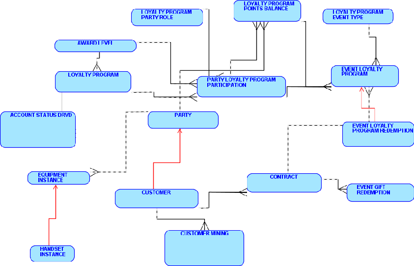

SuperTelco analyzes the current customer base to identify the customers who are most likely to purchase the Video-On-Demand service. The Marketing department would also like to increase the number of customers in the loyalty program (this can help limit churn). Using the Data Mining tool for target promotion the business analyst in the SuperTelco Marketing generates a list of customers that are likely to be interested in this service and that are not currently members of a loyalty program ("supervised" mining).
A sample of the target list of customers is selected to test the promotion. Customer Tom Daniels is among the target list of customers. SuperTelco sends the target customers an email. In order to collect customer feedback, SuperTelco decides that the test promotion customers must contact the call center to get the Video-On-Demand service and one free DVD.
Tom Daniels decides to buy the service and calls the CALL CENTER to get the new promotion, including:
The section, "Sample Use Case 7: Changing Plan and Billing Address" covers the impact of a product change.
The business analyst prepares the campaign, selects the prospects, and measures the campaign success as follows:
  1. The marketing manager determines the number of customers that are members of the loyalty program. Membership in the loyalty program seems to be a factor in reducing churn and increasing SuperTelco's knowledge of a customer's preferences. To increase the number of customers in the loyalty program the marketing manager decides to contact existing customers to proposing a new offering, the Video-On-Demand product, and bind the offering to the loyalty program membership. The loyalty program membership is proposed whether the customer takes advantages of the Video-On-Demand promotion or not. Thus, the promotion includes two promotions:
    1. Service Offering: Video-On-Demand
    2. Loyalty Program Membership
  2. The product setting for Video-On-Demand is specified in the PRODUCT and PRODUCT MARKET PLAN tables. The purpose and summary information for each promotion is specified in the PROMOTION table. Some PROMOTIONs may serve a single strategic purpose (the CAMPAIGN tracks the promotion purpose).

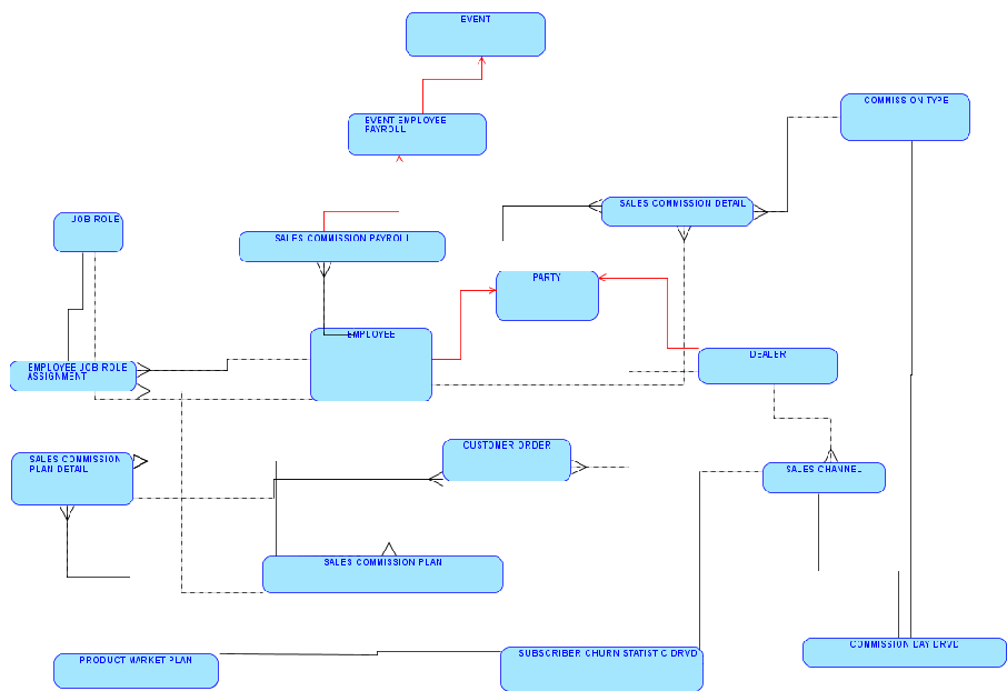

Sample Use Case 10: Dealer and Employee Sales Commission
This use case expands the details for customer information, as described in the section, "Sample Use Case 3: Acquiring a New Customer (with Family Plan)". This use case provides details for how sales information from a dealer is stored. Recall that in the use case in "Sample Use Case 3: Acquiring a New Customer (with Family Plan)", the customer Tom Daniels asked for a family plan offering with the following features:
During the interaction the customer calls the call center to get the phone and broadband offering and the Video On Demand Service. Assuming that SuperTelco rewards dealers depending on customer revenue, the number of services, and the customer loyalty, then, consider the commissions and costs spending for dealers and for a campaign:
Actions for the dealer and employee sales commission use case include the following:
SuperTelco uses Oracle Communications Data Model to store this dealer and customer interaction as shown in Figure B-8 and as outlined in the corresponding steps.
Figure B-8 Dealer and Employee Sales Commission Model
Description of Figure B-8 follows
Description of "Figure B-8 Dealer and Employee Sales Commission Model"
  1. The information for the customer and account setup is described in "Sample Use Case 3: Acquiring a New Customer (with Family Plan)".
  2. At implementation time or when the dealer first appeared, the dealer is entered as a DEALER, for example John Dealer, a sub-type of the PARTY table. A DEALER includes the associated entities:
    1. An address.
    2. A SALES CHANNEL and a channel to identify the dealer. The SALES CHANNEL is an abstracted umbrella that unifies both an external DEALER and the internal sales agents as an EMPLOYEE. The JOB ROLE for each employee is in EMPLOYEE JOB ROLE ASSIGNMENT. For example, the job role for a Sales Employee should be "Sales Agent".
    3. An organization structure or a relationship to individuals.
    4. A discount group in the DISCOUNT GROUP entity within the DEALER DISCOUNT GROUP ASSIGNMENT table. All the discounts the provider allows for a dealer are defined in DEALER DISCOUNT GROUP ASSIGNMENT (as a group). This entity feeds the dealer cost and customer cost table.
  3. As an employee in sales, John Dealer is associated with a sales commission plan code from the SALES COMMISSION PLAN table (using JOB ROLE). The details of the plan SALES COMMISSION PLAN DETAIL or the type of commission COMMISSION TYPE are stored in associated entities so that the full commissions and rewards for the item, equipment, services, and product market plan sold are set-up. The EMPLOYEE JOB ROLE ASSIGNMENT.
  4. The Party interaction between John Dealer and Tom Daniels generates a new CUSTOMER ORDER. The customer order is generated in the BOSS/OSS system and loaded into Oracle Communications Data Model. For each customer order the SALES COMMISSION DETAIL is loaded to track how much commission should be granted to the DEALER in this sales transaction. Once the CUSTOMER ORDER is fulfilled in the provisioning system, a contract is settled with four activations, four handsets (ITEMs) and probably five products (one per mobile and the shared Friends and Family offering (even if there is only one contract). This has the following consequences in Oracle Communications Data Model:
    1. John Dealer generated revenue increases and the number of customer and subscriptions: the revenue is compared to the quota the dealer had at the beginning of the month on each of these items, revenue, number of customers, and subscriptions, for the calculation of the dealer's commission and potential bonus and for the final dealer report.
    2. John Dealer "costs" increase correspondingly, as he wins a percentage of the generated revenue.
    3. The number of handsets available at John's shop is reduced by four (two Postpaid and two Prepaid). The out-of-stock forecast mining model is automatically fed and correspondingly updated.
    4. The commission associated with the handsets through the commission indicator attribute ("Commission Ind") will trigger the calculation of an extra commission for the items sold, aggregated on the monthly basis (using COMMISSION DAY DRVD and SALES MONTH AGGR).
  5. Assuming SuperTelco rewards on the effective revenue generated by the customer, depending on the ARPU band of the account associated with the customer, the special bonus for John Dealer is updated with Tom Daniel's profile and added as a supplementary cost for the dealer and for the customer. Note that often at this stage a fraud detection mechanism is applied to limit dealer or customer fraud.
  6. As Tom Daniels changes the package to the convergent offering, due to a campaign, SuperTelco does not reward John Dealer. The campaign cost may be increased by the cost of creating and sending the SMS, in general, and by the cost of the call center agent interaction. Whereas the customer cost may be increased by the cost of the call center agent interaction only (assuming the SMS sent to Tom Daniels is not considered). Note that the fact that Tom Daniels changes his package will probably impact the Band ARPU that would also change the bonus for John Dealer.
  7. As Tom Daniels's contract comes to an end SuperTelco may decide to reward only the call center as a successful clawback action rather than granting further John Dealer with a bonus for the loyalty of the customer, as the later was not involved at all in the action. The customer cost for Tom Daniels would still increase. The employee and call center cost would also correspondingly increase (here, probably only the employee cost, as the call center cost must be considered to be the sum of the labor, employee, costs and other costs). For example the rent for the building or of the call center service is typically associated with the location of the call center only. Note that its total margin, due to the revenue generation through the contract renewal, is increasing even if the relative margin will probably decrease over the month.
  8. At each end of month when the sales agent commissions are paid by payroll, the information in SALES COMMISSION PAYROLL is populated.
  9. Sometimes certain dealers may commit fraud when bringing in new customers. For example, a dealer may have friends sign contracts to win a gift but then terminate the contract. The new customers brought in by the fraudulent dealer may be identified by SUBSCRIBER CHURN STATISTIC DRVD. In this derived table some statistical functions are applied to find a high churn rate by a possibly cheating DEALER, compared to all other dealers.
Sample Use Case 11: Handling a Network Fault
The Network Monitoring System detects a failure at a switch. SuperTelco wants to understand how many customers are affected by the incident. The Network Monitoring System queries the Network Inventory to get the resource ID of the faulty element. The Network Monitoring System then generates a "network failure" event and Oracle Communications Data Model captures this event.
SuperTelco includes the full network structure as specified in Oracle Communications Data Model and both the network operating and the network inventory applications provide information to Oracle Communications Data Model once a day.
SuperTelco uses Oracle Communications Data Model to handle a network fault, as shown in Figure B-9 and as outlined in the corresponding steps.
Figure B-9 Handling a Network Fault Model
Description of Figure B-9 follows
Description of "Figure B-9 Handling a Network Fault Model"
Consider the case and steps required to handle a network fault:
  1. One evening at 8pm a network cell suffers a power outage after being hit by lightning, and the network cell goes out and does not restart. The real-time network monitoring system alerts SuperTelco maintenance central. This allows SuperTelco to quickly identify where the failure is (site, location, default configuration before the break-down) and SuperTelco sends a team to look at the issue. Assume that this outage is a cell which is difficult to reach, despite being in a high density population area; thus it takes the repair team four hours to repair and restart the network cell.
  2. While the network is down SuperTelco customers call the call center from fixed lines to complain. Some customers threaten to quit the service if the problem persists.
  3. Up to this stage, Oracle Communications Data Model does not play a role. Assume Oracle Communications Data Model gets this summary information events, status, and so on, daily (at 2am the following morning). Note if the ETLs for the network controlling applications are configured such that Oracle Communications Data Model is updated in near real-time for example hourly, then Oracle Communications Data Model may know about the event sooner.
  4. The SuperTelco manager gets the network fault information in real-time from the network applications team.
    The first questions for the manager after identifying the issue are:
    • Where is the cell located?
    • Whose qualified team is in charge now?
    • Which services are impacted?
    • Which customers may be impacted?
    • What is the average revenue impact if nothing is done?
  5. Network applications should be able to answer directly where the cell is located and the team in charge. Note that Oracle Communications Data Model could also identify this information if the ID of the cell that broke down is supplied (even if Oracle Communications Data Model does not yet know that it broke down). A simple adhoc query on the NETWORK ELEMENT table, and its sub-tables, could answer the question:
    "Where is my network element ID xxx?"
    To answer the question:
    "Who is in charge according to the maintenance plan?"
    Oracle Communications Data Model can supply this information with a customization of the model (this information is not available out-of-the-box). If the network fault happens to multiple NETWORK ELEMENTs, all the faulted network elements are tracked in NETWORK ELEMENT FAULT ASSIGNMENT.
  6. Each occurrence of a network failure is recorded in NETWORK FAULT. When a network fault happens at customer site, technical support activities to solve the problem are saved in the CUSTOMER FIELD SUPPORT when loaded into Oracle Communications Data Model. The CUSTOMER FIELD SUPPORT entity is a subtype of CUSTOMER FIELD SERVICE ACTIVITY.
  7. Once the network fault is resolved the resolution type of the network fault is loaded according to FAULT RESOLUTION TYPE.
  8. The list of services impacted is related to the list of elements which were out. In the sample use case, with a lightning strike, consider the full wireless traffic is down in the area near the antenna. Because this area is a high density area, one could expect that other antennae may partly cover the geographic coverage. In a GSM network, geographic areas are divided into different CELLs which are served by the corresponding BASE STATION CONTROLLER. The BASE STATION CONTROLLER is a subtype of NETWORK ELEMENT. A simple report showing the affected areas and services also lists the services associated with the cell.
  9. You can obtain a list of impacted customers through the NETWORK FAULT SUBSCRIPTION ASSIGNMENT, which links the network fault to the SUBSCRIPTION table. The later contains the Circuit Component Code attribute that allows you to use the table CIRCUIT COMPONENT to get the NETWORK TOUCHPOINT concerned, the CELL SITE being a sub-table of NETWORK TOUCHPOINT. Consequently, a simple query on all subscriptions whose circuit component is tied to the cell ID that failed provides a list all the customer information associated with the given cell.
  10. Similarly, the exact list of products impacted, per customer, can easily be provided (related to the service that is down and the subscriptions concerned).
  11. With a list of products impacted, the manager can check how many calls normally run Friday evening between 8pm and 12pm, and get the average revenue generated at that time for those customers. This provides the average revenue loss within the four hours of time-off. The manager may send an email to the call center with the list of potential customers, to warn the call center that within the next three to four hours, those customers may be complaining about a loss of coverage.
  12. When a customer calls the call center, an interaction event is created in EVENT PARTY INTERACTION, with an interaction type of Complain.
  13. With the email and the customer list, a call center manager can warn the call center employees, and possibly ask for a additional personnel to manage the potential increase of complaint calls. Not that it is important to identify all the customer calls to the call center, associated with the failed cell that may be related to the network issue. This identification can be done either upfront in real-time by the call center agent or on a later with analysis from Oracle Communications Data Model. Note: the call center manager may have then an explanation ready for the next monthly meeting when he shows the customer satisfaction report.
  14. For the most valuable customers that complain and threaten to churn, the customer care manager may decide to run a compensation program. For example, by providing ten free SMS or ten minutes for free next month for private customers and provide a 10% discount for business customers at risk of churning.
  15. Later, if these procedures were not carried out, an increase in churn for the following month may be quickly related to the network issue: the default reports might show an alert due to an unusual increase in churn in a specific area (using the outlier function of the database associated to the alert functionality of Oracle Business Intelligence Suite Enterprise Edition).
  16. With Oracle Communications Data Model, there are therefore several ways to come to the same conclusion, in our case:
    • The network cell ID (near real-time).
    • The abnormally limited geographic distribution of origin of some complaints (most probably the next two days).
    • The abnormally increase of churn in a limited region (a month later).
