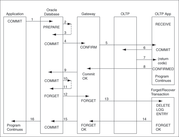

The flow of control for a successful commit between an Oracle application and an OLTP transaction is described in the following section and illustrated in Figure 5-1, "Commit-Confirm Flow with Synclevel 1". The figure assumes that both Oracle and OLTP resources have been updated. The following steps in Section 5.6.1 outline the commit-confirm logic flow.

  1. The application issues a COMMIT to the Oracle database.
  2. The Oracle database sends PREPARE to each participant in the distributed transaction other than the gateway.
  3. Each participant prepares its database updates and responds PREPARE OK to the Oracle database.
  4. The Oracle database sends COMMIT to the gateway. The gateway receives the COMMIT from the Oracle database and inserts a new pending transaction row into the PGA_CC_PENDING table.
  5. The gateway sends an APPC CONFIRM to the OLTP application. The OLTP application receives the CONFIRM request in the form of a status from the last APPC RECEIVE.
  6. The OLTP application issues a COMMIT using an appropriate OLTP function. The OLTP commits all database updates made by the application since the last COMMIT, including the commit-confirm transaction log update.
  7. Once the database updates have been committed, the OLTP returns control to the application with a return code indicating the status of the COMMIT.
  8. The OLTP application sends an APPC CONFIRMED to the gateway.
  9. The gateway receives the CONFIRMED and returns COMMIT OK to the Oracle database.
  10. The Oracle database sends COMMIT to each participant in the distributed transaction other than the gateway.
  11. Each participant commits its database updates and responds COMMIT OK to the Oracle database.
  12. The Oracle database sends a FORGET to the gateway.
  13. The gateway receives the FORGET and starts a new APPC conversation with the FORGET/RECOVERY transaction at the OLTP, sends it a FORGET request and an APPC CONFIRM. The FORGET/RECOVERY transaction receives the FORGET request and deletes the entry from the commit-confirm transaction log for the current Oracle transaction, and commits the delete.
  14. The FORGET/RECOVERY transaction sends an APPC CONFIRMED to the gateway to indicate that the FORGET was processed, and then terminates. The gateway receives the CONFIRMED and deletes the pending transaction row from the PGA_CC_PENDING table.
  15. The gateway returns FORGET OK to the Oracle database.
  16. The Oracle database returns control to the Oracle application.
Figure 5-1, "Commit-Confirm Flow with Synclevel 1" illustrates the Commit-Confirm logic flow described in the previous section.
Figure 5-1 Commit-Confirm Flow with Synclevel 1
Description of Figure 5-1 follows
Description of "Figure 5-1 Commit-Confirm Flow with Synclevel 1"
