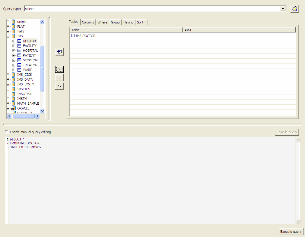

Perform the following procedure to test the IMS data source by query:
  1. Open Oracle Studio for IMS, VSAM, and Adabas Gateways.
  2. Expand the node of the required computer.
  3. Expand the node of the required binding.
  4. Expand the Data sources node.
  5. Right-click the required data source entity, and select Query Tool.
    The Select Workspace screen opens.
  6. Select Navigator and click OK.
    The Query Tool opens in the Editor pane, with the Build Query tab displayed (see Figure 7-1).
  7. Select the required query type from the Query Type list. The default is a SELECT-type query.
  8. Locate and expand the node of the required data source entity.
    The data source tables are listed.
  9. Select the required table and move it to the Table column by using the arrow button.
    Figure 7-1 The Query Tool screen
    Description of Figure 7-1 follows
    Description of "Figure 7-1 The Query Tool screen"
  10. Click Execute query.
    The Query Result tab opens, displaying the results of the query.
  11. Close the Query Tool in the Editor pane.

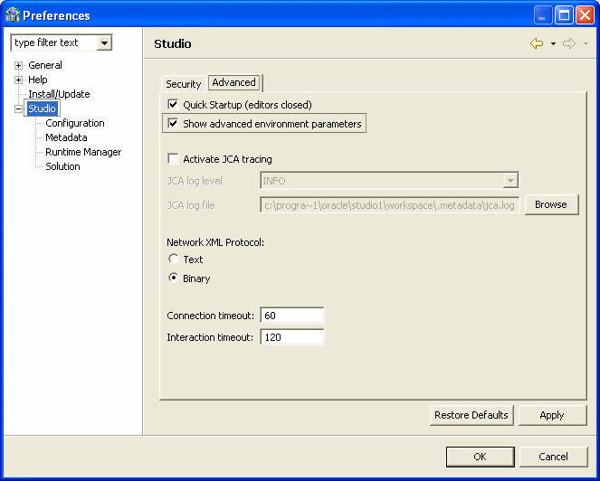

  2. From the main menu, click Windows, Preferences.
    The Preferences screen is displayed.
    Figure 7-2 Studio Preferences
    Studio Preferences
    Description of "Figure 7-2 Studio Preferences"
  3. In the left pane, click the Studio node.
  4. Click the Advanced tab.
  5. Click the Show advanced environment parameters check box.
  6. Click OK.

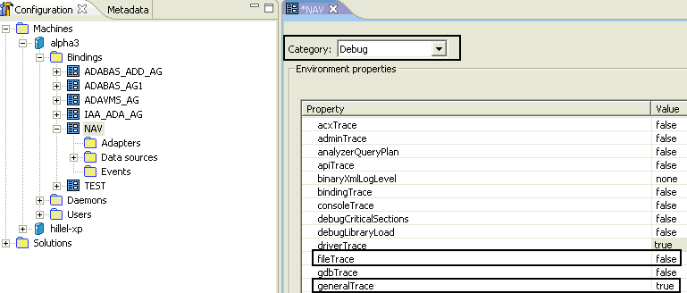

  7. In the Design Perspective Configuration view, right-click the binding under which the data source is located, and select Edit Binding.
  8. In the Category combo box, select Debug.
  9. Set the driverTrace and generalTrace parameters to TRUE.
    Figure 7-3 Binding Properties
    Binding Properties
    Description of "Figure 7-3 Binding Properties"
  10. Execute the following query: Select * from nation limit to 3 rows.
