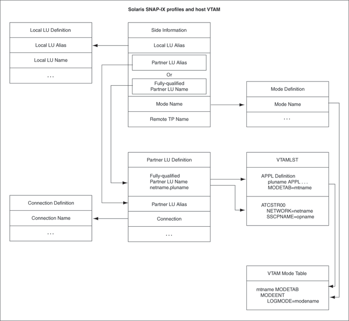

9.2.9 Testing the Connection
Before proceeding with gateway configuration tasks, ensure that your connection is working. Perform this by starting the SNAP-IX Node and then starting the individual link stations.
Figure 9-1 shows the relationship between SNAP-IX definitions and the VTAM definitions on the remote host.
Figure 9-1 Relationship Between SNAP-IX Definitions and Host VTAM Definitions
Description of Figure 9-1 follows
Description of "Figure 9-1 Relationship Between SNAP-IX Definitions and Host VTAM Definitions"
