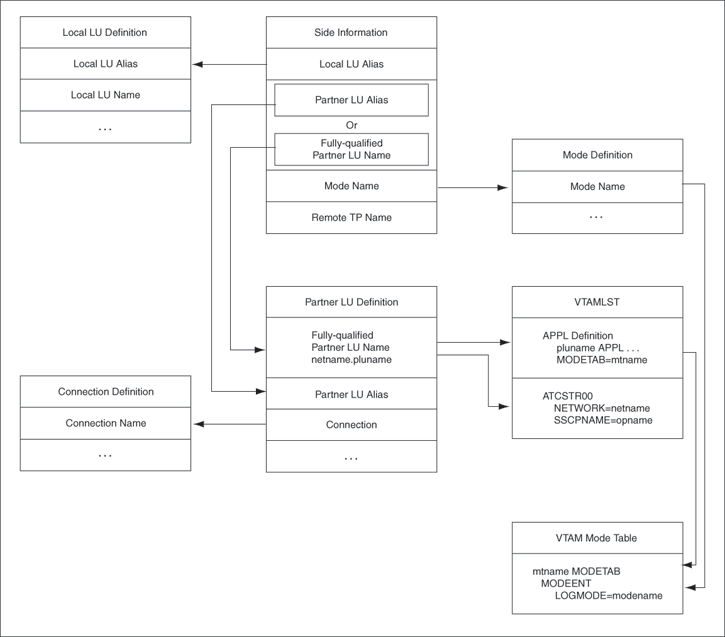

6.3.3 HIS Definition Types
Several types of SNA Server definitions are relevant to gateway APPC/LU6.2 operation. Each definition can be created and edited using a corresponding Microsoft Host Integration Server (formerly SNA Server Manager) menu.
The definitions relevant to the gateway are presented here in hierarchical order. Those definition types that are lowest in the hierarchy are discussed first. This matches the logical sequence in which to create the definitions.
Refer to the Windows HIS online documentation for a complete discussion of HIS definitions. This section provides an overview of HIS definitions in relation to the Oracle Database Gateway for APPC.

6.4.7 CPI-C Symbolic Destination Name
When the Local and Remote Partner definitions and Mode definitions have been created, you can create CPI-C Symbolic Destination Names, also called side information. The side information is used to identify target OLTP systems to be accessed through the gateway. From the Insert menu, select APPC CPIC Symbolic Name. The CPIC Name Properties dialog box appears.
Select the General tab. Enter a Name for the side information. From the Mode Name drop-down list, select the suitable mode.
Now, select the Partner Information tab. Select Application TP and enter the TP name. If you plan to define one CPI-C Symbolic Destination Name for accessing multiple transaction programs at an OLTP, then you can enter a dummy TP Name at this time. The TP Name is overridden by the gateway at run time.
Enter the Partner LU Name Alias.
Click OK to save the side information.

6.6.13 Creating the CPI-C Side Information Profile
Next, define the CPI-C profile that will be used to create the gateway. Follow these instructions:
  1. Click the CPI-C Side Information Definitions.
  2. Click Create.
6.7 Testing the Connection
Before proceeding with the gateway configuration tasks, ensure that your connection is working. You can do this by using the Microsoft Host Integration Server (SNA Server Manager).
Figure 6-1 shows the relationship between SNA Server definitions and the VTAM definitions on the host.
Figure 6-1 Relationship Between SNA Server Definitions and Host VTAM
Description of Figure 6-1 follows
Description of "Figure 6-1 Relationship Between SNA Server Definitions and Host VTAM"
