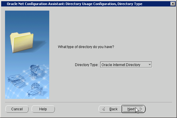

  2. Select Directory Usage Configuration. Click Next.
    The Directory Type screen appears.
    Description of netca2.gif follows
  3. Click Next.

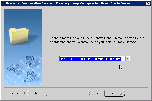

  4. Enter the name of the host on which the Oracle Internet Directory server is running. Also enter the LDAP non-SSL and SSL port numbers. These port numbers are 389 and 636 by default. Click Next.
    The Select Oracle Context screen appears.
    Description of netca4.gif follows
  5. Select the default Oracle Context to use. You need to select this if there are multiple identity management realms on the directory server. Click Next.
    The Directory Usage Configuration, Done screen is displayed.

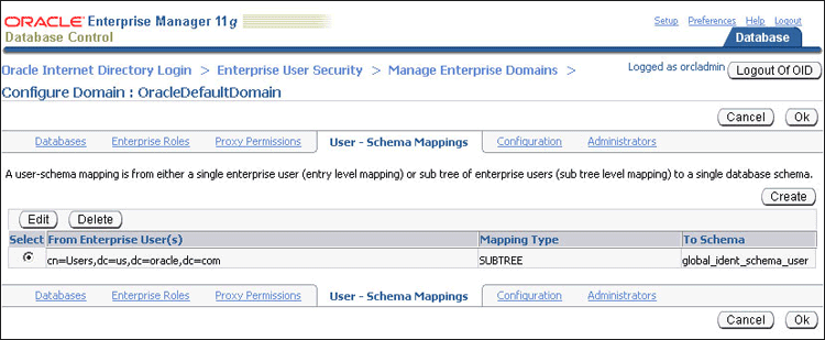

  8. Under the From section, select Subtree. Click the Search icon. Select the DN, cn=Users, dc=us,dc=oracle,dc=com.
  9. Under the To section, enter global_ident_schema_user in the Schema field. Click Continue.
    The user-schema mapping is added in the Configure Domain page.

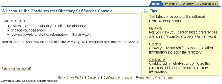

  1. Connect to the Oracle Internet Directory Self Service Console. Use the following URL:
    http://hostname:port/oiddas/
    Here, hostname is the name of the host that is running the Oracle Internet Directory server. The port number is the TCP port number on which the Oracle Internet Directory Self Service Console is running. This is 7777 by default.
    Description of getstrtd7.gif follows
  2. Click the Directory tab.
    The Sign In page appears.
    Description of getstrtd8.gif follows

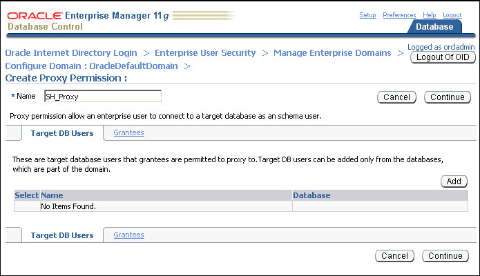

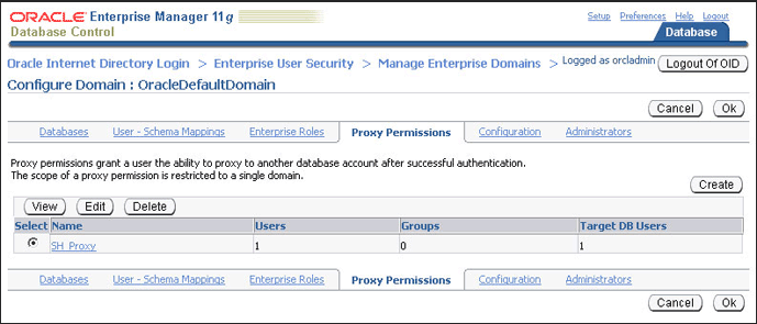

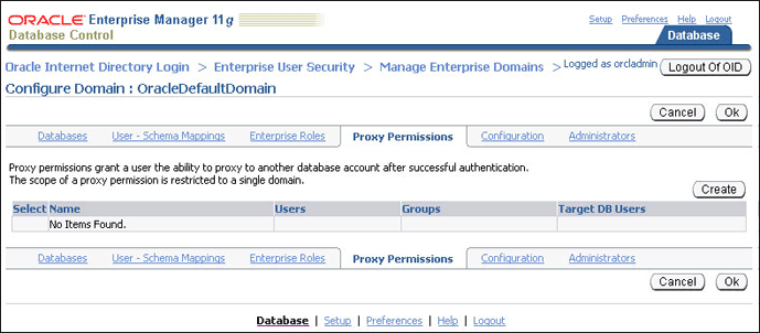

2.7 Using Proxy Permissions
Proxy permissions are created at the enterprise domain level. Proxy permissions allow an enterprise user to proxy a local database user, which means that the enterprise user can log in to the database as the local database user. You can grant proxy permissions to individual enterprise users or groups. Proxy permissions are especially useful for middle-tier applications that operate across multiple databases as enterprise users.
Example 2-5 illustrates the use of proxy permissions. The enterprise user, joe is a sales manager and needs to log in to enterprise databases as the target database user, SH. The SH user owns the sample SH schema that contains Sales History related tables.
Example 2-5 Using Proxy Permissions

    The Configure Domain page appears.
  6. Click the Proxy Permissions tab.

  7. Click Create to create a new proxy permission.
    The Create Proxy Permission page appears.
  8. Enter SH_Proxy, as the name of the proxy permission, in the Name field.
    Description of getstrtd14.gif follows
  9. Ensure that the Target DB Users tab is selected. Click Add.
    The Search and Select window appears.
  10. Log in to the database that contains the SH user. A list of all database users that have been altered to allow enterprise user proxy is displayed.
  11. Select the SH user. Click Select.
    The SH user is added under Target DB Users in the Create Proxy Permission page.
    Description of getstrtd15.gif follows

  16. Click Continue in the Create Proxy Permission page.
    The proxy permission, SH_Proxy is added in the Configure Domain page.
    Description of getstrtd18.gif follows
  17. Click OK.
The enterprise user, joe can now log in as the local database user SH. The following SQL statements illustrate this:
