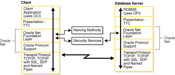

Figure 4-1 illustrates the various layers on the client and on the database server after a connection has been established.
Figure 4-1 Layers Used in a Client/Server Application Connection
Description of Figure 4-1 follows
Description of "Figure 4-1 Layers Used in a Client/Server Application Connection"

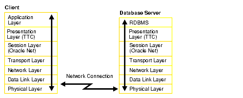

This communication architecture is based on the Open Systems Interconnection (OSI) model. In the OSI model, communication between separate computers occurs in a stack-like fashion with information passing from one node to the other through several layers of code, including:
  1. Physical layer
  2. Data link layer
  3. Network layer
  4. Transport layer
  5. Session layer
  6. Presentation layer
  7. Application layer
Figure 4-2 shows how Oracle Net software consisting of the Oracle Net Foundation layer and Oracle Protocol Support fits into the session layer of the OSI model.
Figure 4-2 OSI Communication Layers
Description of Figure 4-2 follows
Description of "Figure 4-2 OSI Communication Layers"

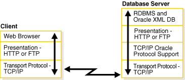

Using Oracle Net Stack Communication for Web Clients
The Oracle database server supports many other implementations for the presentation layer that can be used for Web clients accessing features inside the database in addition to TTC. The listener facilitates this by supporting any presentation implementation requested by the database.
Figure 4-4 shows the stack communication layers used in an HTTP or FTP connection to Oracle XML DB in the Oracle database instance. WebDAV connections use the same stack communication layers as HTTP and FTP.
Figure 4-4 Layers Used in Web Client Connections
Description of Figure 4-4 follows
Description of "Figure 4-4 Layers Used in Web Client Connections"

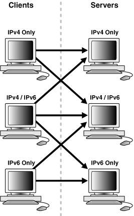

Figure 4-5 shows possible host and interface configurations. The dual-stack host in the center of the diagram can communicate with IPv4 hosts over IPv4 and with IPv6 hosts over IPv6.
Figure 4-5 Supported Host and Interface Configurations
Description of "Figure 4-5 Supported Host and Interface Configurations"

Figure 4-6 Client/Server Connectivity
Description of "Figure 4-6 Client/Server Connectivity"
Table 4-1 summarizes the IP protocols used for client/server connectivity with different host and network configurations.
