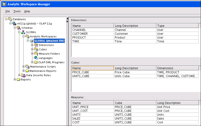

Figure 3-1 shows the main window of Analytic Workspace Manager. It contains menus, a toolbar, a navigation tree, and property sheets. When you select an object in the navigation tree, the property sheet to the right provides detailed information about that object. When you right-click an object, you get a choice of menu items with appropriate actions for that object.
Analytic Workspace Manager has a full online Help system, which includes context-sensitive Help.
Figure 3-1 Analytic Workspace Manager Main Window
Main window in Analytic Workspace Manager
Description of "Figure 3-1 Analytic Workspace Manager Main Window"

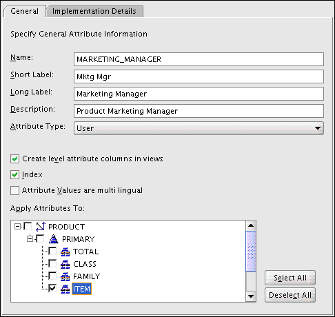

To create an attribute:
  1. Expand the folder for the dimension.
  2. Right-click Attributes, then choose Create Attribute.
    The Create Attribute dialog box is displayed.
  3. Complete the General tab of the Create Attribute dialog box.
    Some attributes apply to all dimension members, and others apply to only one level. Your selection in the Apply Attributes To box controls the mapping of the attribute to one column or to multiple columns.
    Click Help for information about these choices.
  4. To change the data type from the default choice of VARCHAR2, complete the Implementation Details tab.
  5. Click Create.
    The attribute appears as an item in the Attributes folder.
Figure 3-5 shows the creation of the Marketing Manager attribute for the Product dimension. Notice that this attribute applies only to the Item level.
Figure 3-5 Creation of the Product Marketing Manager Attribute
Description of "Figure 3-5 Creation of the Product Marketing Manager Attribute"

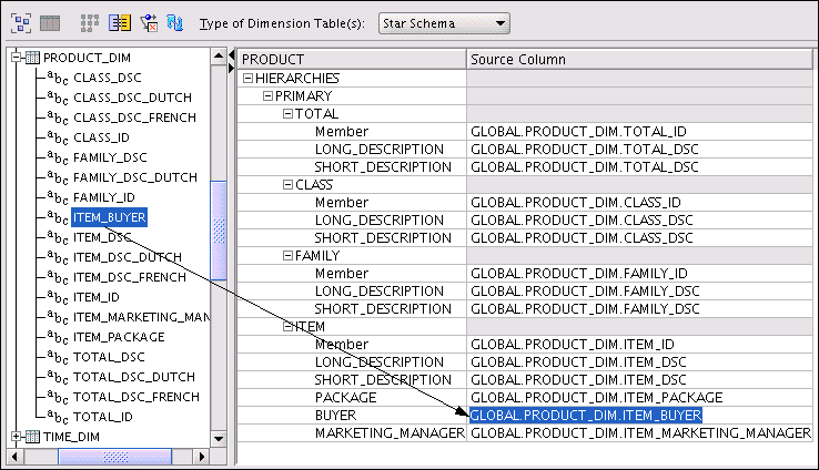

Dimension Mapping Window
The mapping window has a tabular view and a graphical view. You can switch between the two views, using the icons at the top of the canvas.
  • Tabular view: Drag-and-drop the names of individual columns from the schema navigation tree to the rows for the dimensional objects.
  • Graphical view: Drag-and-drop icons, which represent tables and views, from the schema navigation tree onto the mapping canvas. Then draw lines from the columns to the dimensional objects.
You can use the OLAP expression syntax when mapping dimensions in the tabular view. This capability enables you to create the top level of a dimension without having a source column in the dimension table.
You can also map attributes from different tables. OLAP automatically joins the tables on columns with the same name.
Click Help on the Mapping window for more information.
To map a dimension:
  1. In the navigation tree, expand the dimension folder and click Mappings.
    The Mapping window contains a schema navigation tree on the left and a mapping table for the dimension with rows for the levels and their attributes. This is the tabular view.
  2. For normalized dimension tables, select Snowflake Schema for the Type of Dimension Table.
  3. To enlarge the Mapping Window, drag the divider to the left.
  4. In the schema tree, expand the tables, views, or synonyms that contain the dimension members and attributes.
  5. Drag-and-drop the source columns onto the appropriate cells in the mapping table for the dimension.
  6. After you have mapped all levels and attributes, click Apply.
  7. Drag the divider back to the right to reveal the navigation tree.
Figure 3-6 shows the Product dimension mapped in the tabular view. The arrow highlights how the PRODUCT_DIM.ITEM_BUYER column maps to the PRODUCT.ITEM.BUYER attribute.
Figure 3-6 Product Dimension Mapped in Tabular View
Dimension mapping in tabular view
Description of "Figure 3-6 Product Dimension Mapped in Tabular View"

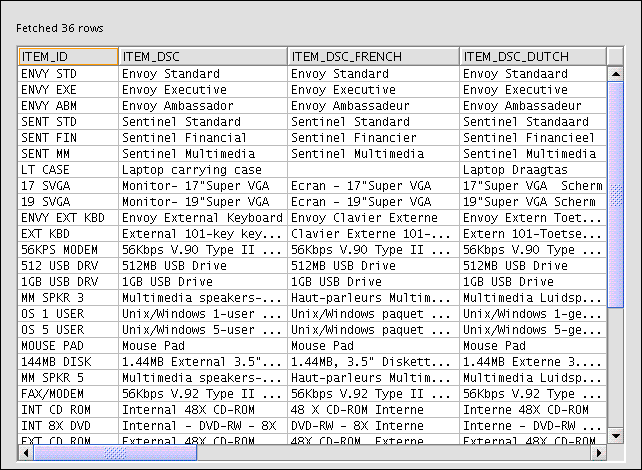

You can view the contents of a particular source column without leaving the mapping window. The information is readily available, eliminating the guesswork when the names are not adequately descriptive.
To see the values in a particular source table or view:
  1. Right-click the source object in either the schema tree or the graphical view of the mapping canvas.
  2. Choose View Data from the shortcut menu.
Figure 3-7 shows the data stored in the PRODUCT_DIM table.
Figure 3-7 Data in the PRODUCT_DIM Table
GLOBAL.PRODUCT_DIM Data
Description of "Figure 3-7 Data in the PRODUCT_DIM Table"

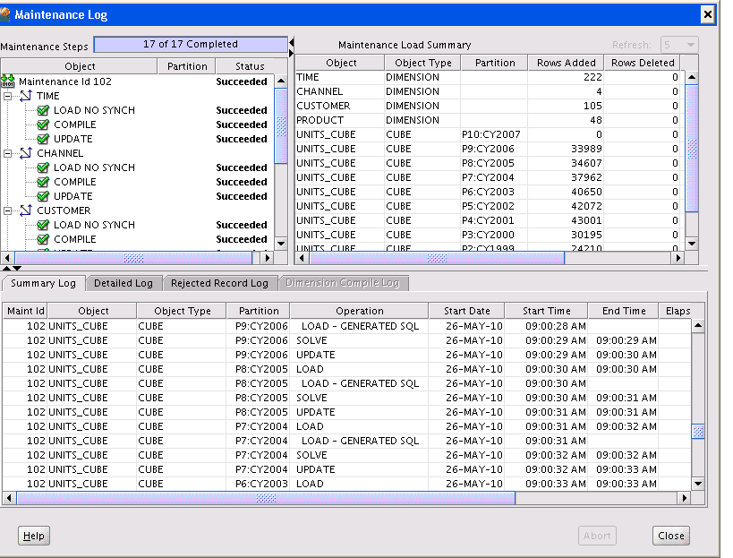

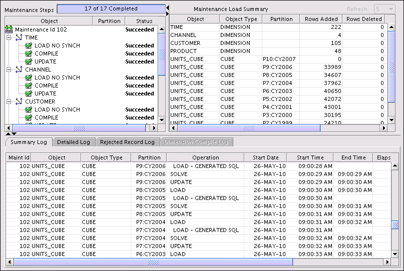

Figure 3-9 shows the Maintenance log for a dimension displayed by Analytic Workspace Manager. It refreshes throughout the build to provide you with the most up-to-date information.
Figure 3-9 Maintenance Log for the Product Dimension
Screen capture of Maintenance Log
Description of "Figure 3-9 Maintenance Log for the Product Dimension"

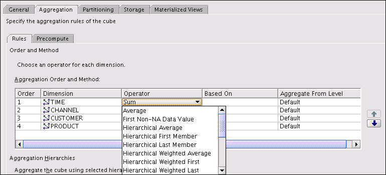

Figure 3-12 shows the Rules subtab for the Units cube with the list of operators displayed.
See Also:
"Aggregation Operators" for descriptions of the aggregation operators.
Figure 3-12 Selecting an Aggregation Operator
Create Cube dialog box Aggregation tab
Description of "Figure 3-12 Selecting an Aggregation Operator"

Example 3-2, "Maintenance Log for the Units Cube" shows the maintenance log displayed by Analytic Workspace Manager for a cube. The log refreshes throughout the build to provide you with the most up-to-date information. The maintenance log is displayed automatically for maintenance tasks that run immediately in the session. When you submit a job to the Oracle job queue, you can track its progress through the various reports in the Maintenance Reports folder: Jobs Scheduled, Jobs Running, and Jobs History. The reports in Jobs Running and Jobs History are the same as the one shown in Example 3-2.
Figure 3-18 Maintenance Log for the Units Cube
Description of Figure 3-18 follows
Description of "Figure 3-18 Maintenance Log for the Units Cube"

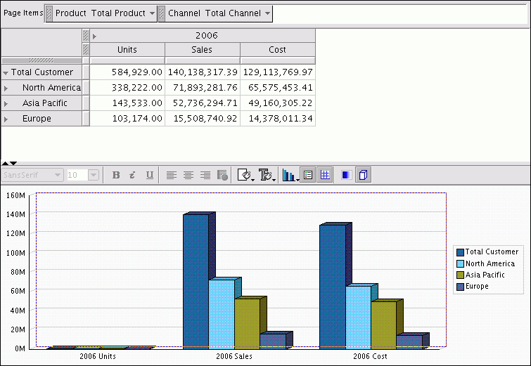

Figure 3-19 shows the Units cube in the Measure Viewer.
Figure 3-19 Displaying the Units Cube
Measure Data Viewer
Description of "Figure 3-19 Displaying the Units Cube"

Choosing a Data Maintenance Method
While developing a dimensional model of your data, mapping and loading each object immediately after you create it is a good idea. That way, you can detect and correct any errors that you made to the object definition or the mapping.
However, in a production environment, you want to perform routine maintenance as quickly and easily as possible. For this stage, you can choose among data maintenance methods.
You can refresh all cubes using the Maintenance Wizard. This wizard enables you to refresh a cube immediately, or submit the refresh as a job to the Oracle job queue, or generate a PL/SQL script. You can run the script manually or using a scheduling utility, such as Oracle Enterprise Manager Scheduler or the DBMS_SCHEDULER PL/SQL package.
The generated script calls the BUILD procedure of the DBMS_CUBE PL/SQL package. You can modify this script or develop one from the start using this package.
The data for a partitioned cube is loaded and aggregated in parallel when multiple processes have been allocated to the build. You are able to see this in the build log.

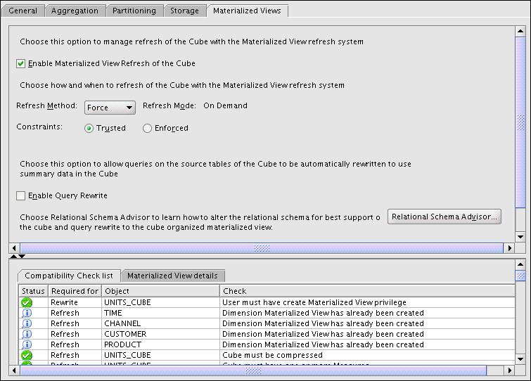

Adding Materialized View Capability to a Cube
Oracle OLAP cubes can be enhanced with materialized view capabilities. Cubes can be incrementally refreshed through the Oracle Database materialized view subsystem, and they can serve as targets for transparent rewrite of queries against the source tables. A cube that has been enhanced in this way is called a cube materialized view.
The OLAP dimensions associated with a cube materialized view are also defined with materialized view capabilities.
A cube must conform to these requirements, before it can be designated as a cube materialized view:
  • All dimensions of the cube have at least one level and one level-based hierarchy. Ragged and skip-level hierarchies are not supported. The dimensions must be mapped.
  • All dimensions of the cube use the same aggregation operator, which is either SUM, MIN, or MAX.
  • The cube has one or more dimensions and one or more measures.
  • The cube is fully defined and mapped. For example, if the cube has five measures, then all five are mapped to the source tables.
  • The data type of the cube is NUMBER, VARCHAR2, NVARCHAR2, or DATE.
  • The source detail tables support dimension and rely constraints. If they have not been defined, then use the Relational Schema Advisor to generate a script that defines them on the detail tables.
  • The cube is compressed.
  • The cube can be enriched with calculated measures, but it cannot support more advanced analytics in a cube script.
To add materialized view capabilities:
  1. In the navigation tree, select a cube.
    The property sheets for the cube are displayed.
  2. Choose the Materialized Views tab.
  3. Review the checklist and, if some tests failed, fix the cause of the problem.
    You cannot define a cube materialized view until the cube is valid.
  4. For automatic refresh, complete just the top half page. For query rewrite, complete the entire page.
    Click Help for information about the choices on this page.
  5. Click Apply.
The cube materialized views appear in the same schema as the analytic workspace. A materialized view is created for the cube and each of its dimensions. Unlike traditional materialized views, cube materialized views do not use relational tables to store data; the data is stored in the backing cube. A CB$ prefix identifies the tables as cube materialized views.
The initial state of a new materialized view is invalid, so it does not support query rewrite until after it is refreshed. You can specify the first refresh time on the Materialized View tab of the cube, or you can run the Maintenance Wizard.
Figure 3-23 shows the Materialized View tab of the Units Cube.
Figure 3-23 Defining a Materialized View
Cube Materialized View tab
Description of "Figure 3-23 Defining a Materialized View"

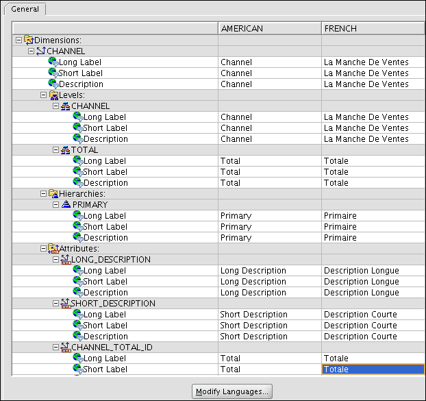

Supporting Multiple Languages
A single analytic workspace can support multiple languages. This support enables users of OLAP applications and tools to view the metadata in their native languages. For example, you can provide translations for the display names of measures, cubes, and dimensions. You can also map attributes to multiple columns, one for each language.
The number and choice of languages is restricted only by the database character set and your ability to provide translated text. Languages can be added or removed at any time.
To add support for multiple languages:
  1. In the navigation tree, expand the folder for the analytic workspace.
  2. Select Languages to display its property page.
  3. On the General tab, click Modify Languages.
  4. On the Modify Languages dialog box, select the languages that the analytic workspace must support. Use the shuttle keys to move them to the Selected Languages box.
  5. Click OK to return to the Languages property page.
  6. Enter the translations of the various labels and descriptions. Each language has a column where you can enter this information.
  7. For each dimension, open the Mappings window. Map the attributes to the source columns for each language.
Figure 3-24 shows the addition of French to the analytic workspace.
Figure 3-24 Adding a Language
Description of Figure 3-24 follows
Description of "Figure 3-24 Adding a Language"
