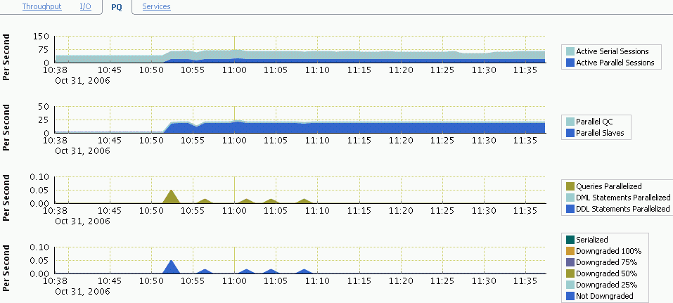

Monitoring Parallel Execution Performance
This section describes how to monitor parallel execution performance. Suppose that you see many parallel statements are being downgraded. This may indicate a performance problem. Statements that run with a degree of parallelism lower than expected can take much longer, and users may experience different execution times depending on whether or not statements were downgraded. Possible causes for downgraded parallel statements include the following:
  • The initial degree of parallelism is higher than it should be and should be lowered.
  • There are not enough parallel servers available, which may indicate the system is overloaded.
To monitor parallel execution performance:
  1. On the Database Home page, click Performance.
    The Performance page is displayed.
  2. Scroll down the page. Under the list of links, click PQ.
    The PQ page is displayed. Parallel query performance characteristics are shown for:
    • Parallel sessions
    • Parallel slaves
    • DML and DDL parallelization
    • Serialization and statement downgrades
Figure 9-1 Monitoring Parallel Execution
Description of Figure 9-1 follows
Description of "Figure 9-1 Monitoring Parallel Execution"

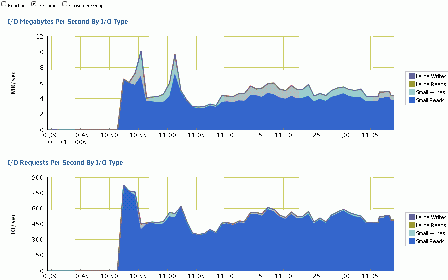

Monitoring I/O
This section describes how to monitor I/O performance. If the throughput on your system is significantly lower than what you expect based on the system configuration (see Chapter 2, "Setting Up Your Data Warehouse System") and your users complain about performance issues, then there could be a performance problem. In a well-configured system that runs a typical data warehouse workload, you expect a large portion of large I/Os and a relatively low latency (lower than 30 ms) for a single block I/O.
To monitor I/O performance:
  2. Scroll down the page. Under the list of links, click I/O.
    The I/O page is displayed, displaying I/O Megabytes per Second by Function and I/O Requests per Second by Function.
  3. For details regarding read and write operations, select IO Type.
    I/O details are shown for the following:
    • Large Writes
    • Large Reads
    • Small Writes
    • Small Reads
Figure 9-2 Monitoring I/O
Description of Figure 9-2 follows
Description of "Figure 9-2 Monitoring I/O"
