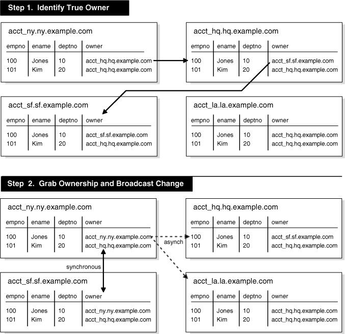

Using Dynamic Ownership Conflict Avoidance
This section describes a more advanced method of designing your applications to avoid conflicts. This method, known as token passing, is similar to the workflow method described in the following sections. Although this section describes how to use this method to control the ownership of an entire row, you can use a modified form of this method to control ownership of the individual column groups within a row.
Both workflow and token passing allow dynamic ownership of data. With dynamic ownership, only one site at a time is allowed to update a row, but ownership of the row can be passed from site to site. Both workflow and token passing use the value of one or more "identifier" columns to determine who is currently allowed to update the row.
Workflow
With workflow partitioning, you can think of data ownership as being "pushed" from site to site. Only the current owner of the row is allowed to push the ownership of the row to another site, by changing the value of the "identifier" columns.
Take the simple example of separate sites for ordering, shipping, and billing. Here, the identifier columns are used to indicate the status of an order. The status determines which site can update the row. After a user at the ordering site has entered the order, the user updates the status of this row to ship. Users at the ordering site are no longer allowed to modify this row — ownership has been pushed to the shipping site.
After shipping the order, the user at the shipping site updates the status of this row to bill, thus pushing ownership to the billing site, and so on.
To successfully avoid conflicts, applications implementing dynamic data ownership must ensure that the following conditions are met:
  • Only the owner of the row can update the row.
  • The row is never owned by more than one site.
  • Ordering conflicts can be successfully resolved at all sites.
With workflow partitioning, only the current owner of the row can push the ownership of the row to the next site by updating the "identifier" columns. No site is given ownership unless another site has given up ownership; thus ensuring there is never more than one owner.
Because the flow of work is ordered, ordering conflicts can be resolved by applying the change from the site that occurs latest in the flow of work. Any ordering conflicts can be resolved using a form of the priority conflict resolution method, where the priority value increases with each step in the work flow process. The priority conflict resolution method successfully converges for more than one master site as long as the priority value is always increasing.
Token Passing
Token passing uses a more generalized approach to meeting these criteria. To implement token passing, instead of the "identifier" columns, your replicated tables must have owner and epoch columns. The owner column stores the global database name of the site currently believed to own the row.
Once you have designed a token passing mechanism, you can use it to implement a variety of forms of dynamic partitioning of data ownership, including workflow.
You should design your application to implement token passing for you automatically. You should not allow the owner or epoch columns to be updated outside this application.
Whenever you attempt to update a row, your application should:
  1. Locate the current owner of the row.
  2. Establish ownership of the row.
  3. Lock the row to prevent updates while ownership is changing.
  4. Perform the update.
Oracle releases the lock when you commit your transaction.
For example, Figure 6-1 illustrates how ownership of employee 100 passes from the acct_sf database to the acct_ny database.
Figure 6-1 Grabbing the Token
Description of Figure 6-1 follows
Description of "Figure 6-1 Grabbing the Token "
Locating the Owner of a Row
To obtain ownership, the acct_ny database uses a simple recursive algorithm to locate the owner of the row. The sample code for this algorithm is shown as follows:
-- Sample code for locating the token owner.
-- This is for a table TABLE_NAME with primary key PK.
-- Initial call should initialize loc_epoch to 0 and loc_owner
-- to the local global name.
get_owner(PK IN primary_key_type, loc_epoch IN OUT NUMBER,
          loc_owner IN OUT VARCHAR2)
  -- use dynamic SQL (dbms_sql) to perform a select similar to
  -- the following:
  SELECT owner, epoch into rmt_owner, rmt_epoch
     FROM TABLE_NAME@loc_owner
     WHERE primary_key = PK FOR UPDATE;
  IF rmt_owner = loc_owner AND rmt_epoch >= loc_epoch THEN
   loc_owner := rmt_owner;
   loc_epoch := rmt_epoch;
   RETURN;
  ELSIF rmt_epoch >= loc_epoch THEN
   get_owner(PK, rmt_epoch, rmt_owner);
   RETURN;
  ELSE
   raise_application_error(-20000, 'No owner for row');
  END IF;}
Obtaining Ownership
After locating the owner of the row, the acct_ny site gets ownership from the acct_sf site by completing the following steps:
  1. Lock the row at the sf site to prevent any changes from occurring while ownership is being exchanged.
    This operation ensures that only one site considers itself to be the owner at all times. The update at the sf site should not be replicated using DBMS_REPUTIL.REPLICATION_OFF. The replicated change of ownership at the ny site in Step 4 will ultimately be propagated to all other sites in the replication environment, including the sf site, where it will have no effect.
  2. Synchronously update the owner information at both the sf and ny sites.
  3. Update the row information at the new owner site, ny, with the information from the current owner site, sf.
    This data is guaranteed to be the most recent. This time, the change at the ny site should not be replicated. Any queued changes to this data at the sf site are propagated to all other sites in the usual manner. When the sf change is propagated to ny, it is ignored because of the values of the epoch numbers, as described in the next bullet point.
  4. Update the epoch number at the new owner site to be one greater than the value at the previous site.
    Perform this update at the new owner only, and then asynchronously propagate this update to the other master sites. Incrementing the epoch number at the new owner site prevents ordering conflicts.
    When the sf changes (that were in the deferred queue in Step 2 preceding) are ultimately propagated to the ny site, the ny site ignores them because they have a lower epoch number than the epoch number at the ny site for the same data.
    As another example, suppose the hq site received the sf changes after receiving the ny changes, the hq site would ignore the sf changes because the changes applied from the ny site would have the greater epoch number.
