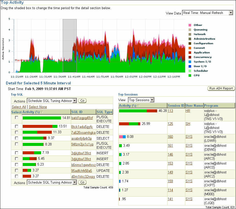

Figure 9-1 shows an example of the Top Activity page.
Figure 9-1 Top Activity Page
Description of Figure 9-1 follows
Description of "Figure 9-1 Top Activity Page"
To access the Top Activity page:
  1. From the Database Home page, click Performance.
    The Performance page appears.
  2. Under Additional Monitoring Links, click Top Activity.
    The Top Activity page appears.
    This page shows a 1-hour time line of the top activity running on the database. SQL statements that are using the highest percentage of database activity are listed under the Top SQL section, and are displayed in 5-minute intervals.
  3. To move the 5-minute interval, drag the shaded box to the desired time.
    The information contained in the Top SQL section will be automatically updated to reflect the selected time period. Use this page to identify high-load SQL statements that may be causing performance problems.
  4. To monitor SQL statements for a longer duration than one hour, select Historical from the View Data list.
    In Historical view, you can view the top SQL statements for the duration defined by the AWR retention period.

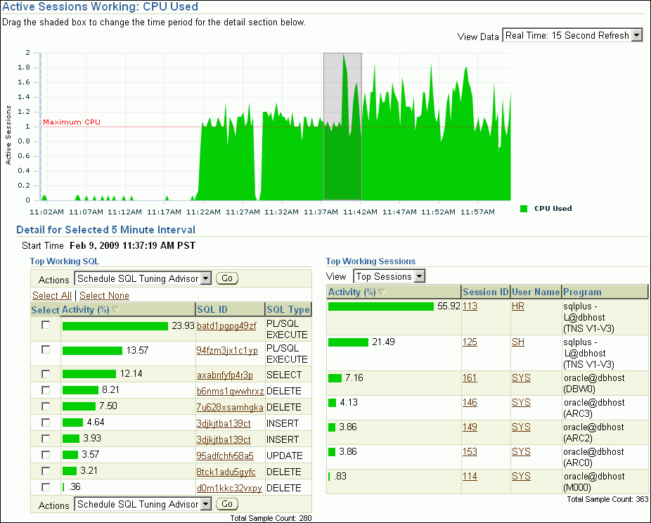

The SQL statements that appear in the Top SQL section of the Top Activity page are categorized into various wait classes, based on their corresponding class as described in the legend on the Top Activity chart.
To view the SQL statements for a particular wait class, click the block of color on the chart for the wait class, or its corresponding wait class in the legend. The Active Sessions Working page for the selected wait class appears, and the Top SQL section will be automatically updated to show only the SQL statements for that wait class.
The example in Figure 9-2 shows the Active Sessions Working page for the CPU Used wait class. Only SQL statements that are consuming the most CPU time are displayed in the Top Working SQL section.

The Top SQL section of the Top Activity page displays the SQL statements executed within the selected 5-minute interval in descending order based on their resource consumption. The SQL statement at the top of this table represents the most resource-intensive SQL statement during that time period, followed by the second most resource-intensive SQL statement, and so on.
In the example shown in Figure 9-2, "Viewing SQL Statements by Wait Class", the SELECT statement with the SQL ID axabnfyfp4r3p is consuming 12.14% of database activity and should be investigated.

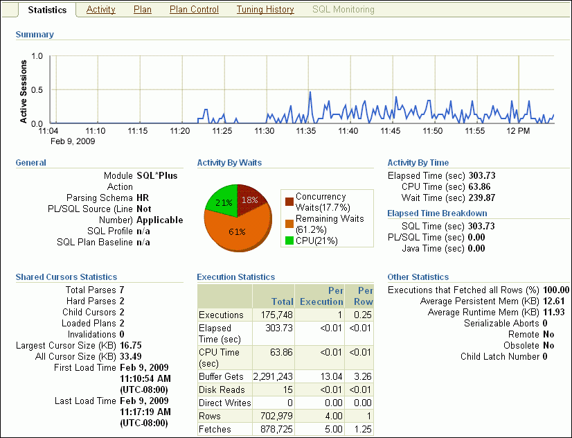

The Statistics subpage of the SQL Details page displays statistical information about the SQL statement.
To view statistics for the SQL statement:
  1. On the SQL Details page, under Details, click Statistics.
    The SQL Details page appears, showing the Statistics subpage.
    Description of sql_details_statistics.gif follows
  2. View the statistics for the SQL statement, as described in the following sections:
SQL Statistics Summary
The Summary section displays SQL statistics and activity on a chart.
In the Real Time view, the Active Sessions chart shows the average number of active sessions executing the SQL statement in the last hour. If the SQL statement has multiple plans and All is selected in the Plan Hash Value list, then the chart will display each plan in different colors, enabling you to easily spot if the plan changed and whether this may be the cause of the performance degradation. Alternatively, you can select a particular plan to display that plan only.
In the Historical view, the chart shows execution statistics in different dimensions. To view execution statistics, select the desired dimension from the View list:
  • Elapsed time per execution
  • Executions per hour
  • Disk reads per execution
  • Buffer gets per execution
This technique enables you to track the response time of the SQL statement using different dimensions. You can determine whether the performance of the SQL statement has degraded based on the dimension selected.
To view statistics of the SQL statement for a particular time interval, click the snapshot icon below the chart. You can also use the arrows to scroll the chart to locate a desired snapshot.
General SQL Statistics
The General section enables you to identify the origin of the SQL statement by listing the following information:
  • Module, if specified using the DBMS_APPLICATION_INFO package
  • Action, if specified using the DBMS_APPLICATION_INFO package
  • Parsing schema, or the database account used to execute the SQL statement
  • PL/SQL source, or the code line if the SQL statement is part of a PL/SQL program
Activity by Wait Statistics and Activity by Time Statistics
The Activity by Wait and Activity by Time sections enable you to identify how the SQL statement spent most of its time. The Activity by Wait section contains a graphical representation of how much elapsed time is consumed by CPU and by remaining waits. The Activity by Time section breaks out the total elapsed time into CPU time and wait time by seconds.
Elapsed Time Breakdown Statistics
The Elapsed Time Breakdown section enables you to identify if the SQL statement itself is consuming a lot of time, or if the total elapsed time is inflated due to the amount of time the originating program or application spent with the PL/SQL or Java engine. If the PL/SQL time or Java time makes up a significant portion of the elapsed time, then there may be minimal benefit gained by tuning the SQL statement. Instead, you should examine the application to determine how the PL/SQL time or Java time can be reduced.
Shared Cursors Statistics and Execution Statistics
The Shared Cursors Statistics and Execution Statistics sections provide information about the efficiency of various stages of the SQL execution process.
Other SQL Statistics
The Other Statistics section provides additional information about the SQL statement, such as average persistent and run-time memory.

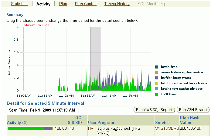

The Activity subpage contains a graphical representation of the session activity.
To view session activity for the SQL statement:
  1. On the SQL Details page, under Details, click Activity.
    The SQL Details page appears, showing the Activity subpage.
    Description of sql_details_activity.gif follows
    The Activity subpage displays details of various sessions executing the SQL statement. The Active Sessions chart profiles the average number of active sessions over time.
  2. Optionally, drag the shaded box to select a 5-minute interval.
    The Detail for Selected 5 Minute Interval section lists the sessions that executed the SQL statement during the selected 5-minute interval. The multicolored bar in the Activity % column depicts how the database time is divided for each session while executing the SQL statement.
  3. Optionally, click the link in the SID column of the session you want to view to display the Session Details page.

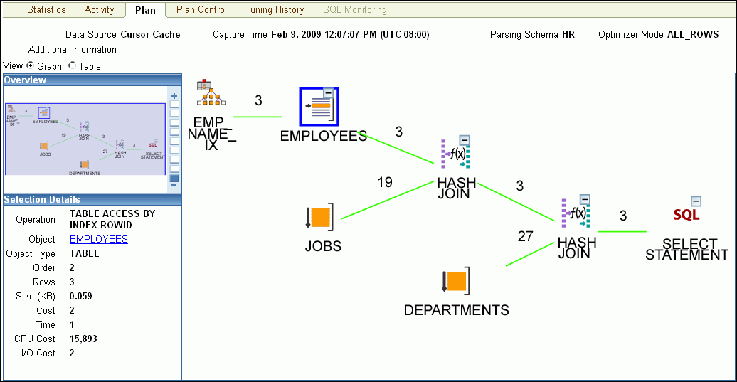

The execution plan for a SQL statement is the sequence of operations Oracle Database performs to run the statement. The Plan subpage displays the execution plan for the SQL statement in a graph view and a table view.
To view the execution plan for the SQL statement:
  1. On the SQL Details page, under Details, click Plan.
    The SQL Details page appears, showing the Plan subpage.
  2. Click Graph to view the SQL execution in a graph view.
    Description of sql_details_plan_graph.gif follows
  3. Optionally, select an operation in the graph to display details about the operations shown in the execution plan.
    The Selection Details section refreshes to show details about the selected operations.
  4. If the selected operation is on a particular database object (such as a table), then click the Object link to view further details about the database object.

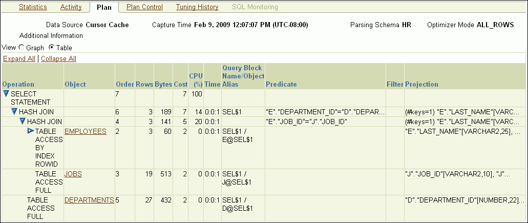

  5. To view the SQL execution in a table view, click Table.
    The Plan subpage refreshes to show the explain plan in a table.

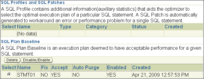

The Plan Control subpage contains information about the following items:
  • SQL profiles
    A SQL profile contains additional statistics for the SQL statement. The optimizer uses these statistics to generate a better execution plan for the statement.
  • SQL patches
    A SQL patch is automatically generated to work around an error or performance problem for a single SQL statement.
  • SQL plan baselines
    A SQL plan baseline is an execution plan proven to have acceptable performance for a given SQL statement.
To view plan control information:
  1. On the SQL Details page, under Details, click Plan Control.
    The SQL Details page appears, showing the Plan Control subpage.
  2. Review the plan-related information.
    In the following example, the optimizer used a SQL plan baseline named STMT01 for the SQL statement.
