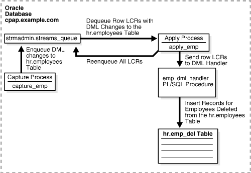

The example in this chapter illustrates using Oracle Streams to capture and apply data manipulation language (DML) changes at a single database named cpap.example.com. Specifically, this example captures DML changes to the employees table in the hr schema, placing row logical change records (LCRs) into a queue named streams_queue. Next, an apply process dequeues these row LCRs from the same queue, reenqueues them into this queue, and sends them to a procedure DML handler.
When the row LCRs are captured, they reside in the buffered queue and cannot be dequeued explicitly. After the row LCRs are reenqueued during apply, they are available for explicit dequeue by an application. This example does not create the application that dequeues these row LCRs.
This example illustrates a procedure DML handler that inserts records of deleted employees into an emp_del table in the hr schema. This example assumes that the emp_del table is used to retain the records of all deleted employees. The procedure DML handler is used to determine whether each row LCR contains a DELETE statement. When the procedure DML handler finds a row LCR containing a DELETE statement, it converts the DELETE into an INSERT on the emp_del table and then inserts the row.
Figure 4-1 provides an overview of the environment.
Figure 4-1 Single Database Capture and Apply Example
Description of Figure 4-1 follows
Description of "Figure 4-1 Single Database Capture and Apply Example"

Make DML Changes, Query for Results, and Dequeue Messages
Complete the following steps to confirm that apply process is configured correctly, make DML changes to the hr.employees table, query for the resulting inserts into the hr.emp_del table and the reenqueued messages in the streams_queue_table, and dequeue the messages that were reenqueued by the apply process:
  1. Confirm the Rule Action Context
  2. Perform an INSERT, UPDATE, and DELETE on hr.employees
  3. Query the hr.emp_del Table and the streams_queue_table
  4. Dequeue Messages Reenqueued by the Procedure DML Handler
Step 1   Confirm the Rule Action Context
Step 7 creates an apply process rule that specifies a destination queue into which LCRs that satisfy the rule are enqueued. In this case, LCRs that satisfy the rule are row LCRs with changes to the hr.employees table.

Step 3   Query the hr.emp_del Table and the streams_queue_table
After some time passes to allow for capture and apply of the changes performed in the previous step, run the following queries to see the results:
CONNECT strmadmin@cpap.example.com
Enter password: password
SELECT employee_id, first_name, last_name, timestamp
  FROM hr.emp_del ORDER BY employee_id;
SELECT MSG_ID, MSG_STATE, CONSUMER_NAME
  FROM AQ$STREAMS_QUEUE_TABLE ORDER BY MSG_ID;
When you run the first query, you should see a record for the employee with an employee_id of 207. This employee was deleted in the previous step. When you run the second query, you should see the reenqueued messages resulting from all of the changes in the previous step, and the MSG_STATE should be READY for these messages.
Step 4   Dequeue Messages Reenqueued by the Procedure DML Handler
Use the emp_dq procedure to dequeue the messages that were reenqueued by the procedure DML handler.
SET SERVEROUTPUT ON SIZE 100000
EXEC emp_dq('HR');
For each row changed by a DML statement, one line is returned, and each line states the command type of the change (either INSERT, UPDATE, or DELETE). If you repeat the query on the queue table in Step 3 after the messages are dequeued, then the dequeued messages should have been consumed. That is, either the MSG_STATE should be PROCESSED for these messages, or the messages should no longer be in the queue.
