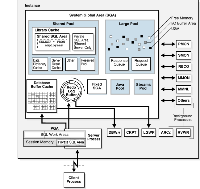

Multiple-process Oracle (also called multiuser Oracle) uses several processes to run different parts of the Oracle Database code and additional processes for the users—either one process for each connected user or one or more processes shared by multiple users. Most databases are multiuser because a primary advantages of a database is managing data needed by multiple users simultaneously.
Each process in a database instance performs a specific job. By dividing the work of the database and applications into several processes, multiple users and applications can connect to an instance simultaneously while the system gives good performance.
A database instance contains or interacts with the following types of processes:
Client processes run the application or Oracle tool code.
Oracle processes run the Oracle database code. Oracle processes including the following subtypes:
Background processes start with the database instance and perform maintenance tasks such as performing instance recovery, cleaning up processes, writing redo buffers to disk, and so on.
Server processes perform work based on a client request.
For example, these processes parse SQL queries, place them in the shared pool, create and execute a query plan for each query, and read buffers from the database buffer cache or from disk.
Server processes, and the process memory allocated in these processes, run in the instance. The instance continues to function when server processes terminate.Slave processes perform additional tasks for a background or server process.
The process structure varies depending on the operating system and the choice of Oracle Database options. For example, the code for connected users can be configured for dedicated server or shared server connections. In a shared server architecture, each server process that runs database code can serve multiple client processes.
Figure 15-1 shows a system global area (SGA) and background processes using dedicated server connections. For each user connection, the application is run by a client process that is different from the dedicated server process that runs the database code. Each client process is associated with its own server process, which has its own program global area (PGA).

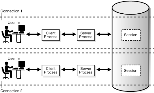

A connection is a physical communication pathway between a client process and a database instance. A communication pathway is established using available interprocess communication mechanisms or network software. Typically, a connection occurs between a client process and a server process or dispatcher, but it can also occur between a client process and Oracle Connection Manager (CMAN).
A session is a logical entity in the database instance memory that represents the state of a current user login to a database. For example, when a user is authenticated by the database with a password, a session is established for this user. A session lasts from the time the user is authenticated by the database until the time the user disconnects or exits the database application.
A single connection can have 0, 1, or more sessions established on it. The sessions are independent: a commit in one session does not affect transactions in other sessions.
If Oracle Net connection pooling is configured, then it is possible for a connection to drop but leave the sessions intact.Multiple sessions can exist concurrently for a single database user. As shown in Figure 15-2, user hr can have multiple connections to a database. In dedicated server connections, the database creates a server process on behalf of each connection. Only the client process that causes the dedicated server to be created uses it. In a shared server connection, many client processes access a single shared server process.
Figure 15-2 One Session for Each Connection

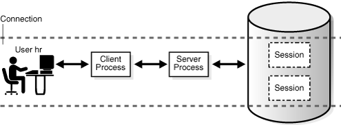

Figure 15-3 illustrates a case in which user hr has a single connection to a database, but this connection has two sessions.
Figure 15-3 Two Sessions in One Connection
Generating an autotrace report of SQL statement execution statistics re-creates the scenario in Figure 15-3. connects SQL*Plus to the database as user SYSTEM and enables tracing, thus creating a new session (sample output included).
Example 15-1 One Connection with Two Sessions
SQL> SELECT SID, SERIAL#, PADDR FROM V$SESSION WHERE USERNAME = USER; SID SERIAL# PADDR --- ------- -------- 90 91 3BE2E41C SQL> SET AUTOTRACE ON STATISTICS; SQL> SELECT SID, SERIAL#, PADDR FROM V$SESSION WHERE USERNAME = USER; SID SERIAL# PADDR --- ------- -------- 88 93 3BE2E41C 90 91 3BE2E41C ... SQL> DISCONNECT
The DISCONNECT command in actually ends the sessions, not the connection. Opening a new terminal and connecting to the instance as a different user, the query in shows that the connection from is still active.
