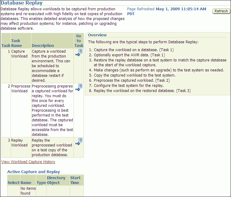

  1. On the Software and Support page, under Real Application Testing, click Database Replay.
    The Database Replay page appears.

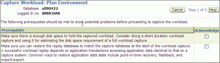

  3. Verify that all prerequisites are met before proceeding.
    For information about the prerequisites, see "Prerequisites for Capturing a Database Workload".
    For each verified prerequisite, check the box in the Acknowledge column. Once all prerequisites are verified, click Next.

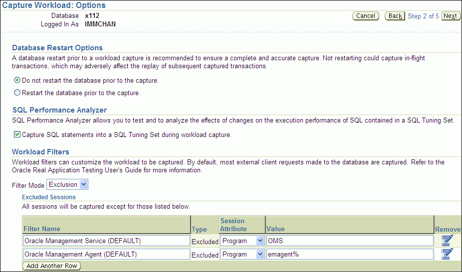

  4. Select the workload capture options:
    • Under Database Restart Options, select whether the database will be restarted before workload capture.
      It is recommended that the database be restarted before capturing a workload to enable a clean state for workload capture. Otherwise, potential problems may arise when replaying the workload. For more information, see "Restarting the Database".
    • Under SQL Performance Analyzer, select whether to capture SQL statements into a SQL tuning set during workload capture.
      While Database Replay provide analysis of how a change affects your entire system, you can use a SQL tuning set in conjunction with SQL Performance Analyzer to gain a more SQL-centric analysis of how the change affects SQL statements and execution plans.
      By capturing a SQL tuning set during workload capture and another SQL tuning set during workload replay, you can use SQL Performance Analyzer to compare these SQL tuning sets to each other, without having to re-execute the SQL statements. This enables you to obtain a SQL Performance Analyzer report and compare the SQL performance, before and after change, while running Database Replay.
      For information about comparing SQL tuning sets using SQL Performance Analyzer reports, see "Generating SQL Performance Analyzer Reports Using APIs".
      Capturing SQL statements into a SQL tuning set is the default and recommended workload capture option.
    • Under Workload Filters, select whether to use exclusion filters by selecting Exclusion in the Filter Mode list, or inclusion filters by selecting Inclusion in the Filter Mode list.
      To add filters, click Add Another Row and enter the filter name, session attribute, and value in the corresponding fields. For more information, see "Using Filters with Workload Capture".

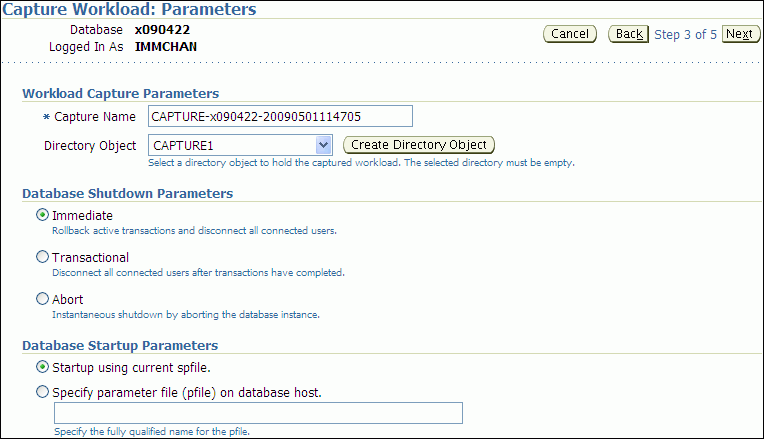

  5. Define the parameters for the workload capture:
    • Under Workload Capture Parameters, in the Capture Name field, enter a name for the workload capture. In the Directory Object list, select the directory where the captured workload will be stored. You must select a directory that does not already contain a workload capture. For more information, see "Setting Up the Capture Directory".
      To create a directory object, click Create Directory Object. The Create Directory Object page appears. In the Name field, enter a name for the directory object. In the Path field, enter the path to the directory object. To test if the directory exists in the file system, click Test File System. If the directory does not exist, it will need to be created first.
    • Under Database Shutdown Parameters, select the type of database shutdown method to perform. This option only appears if the database will be restarted before workload capture. The types of available database shutdown methods include:
      • Immediate
        An immediate shutdown will roll back all active transactions and disconnect all connected users before shutting down the database.
      • Transactional
        A transactional shutdown will first complete all active transactions and then disconnect the connected user before shutting down the database.
      • Abort
        An abort shutdown will shut down the database instantaneously by aborting all active transactions.
      • Force the database to shutdown
        A force shutdown will shut down the database if any cluster-managed database services are operational. This option only appears if you are running Oracle RAC.
    • Under Database Startup Parameters, select if the database will restart using the current default server parameter file (spfile) or a specific parameter file (pfile). To select a pfile, enter the fully qualified name for the pfile. This option only appears if the database will be restarted before workload capture.
    After defining the parameters for the workload capture, click Next.

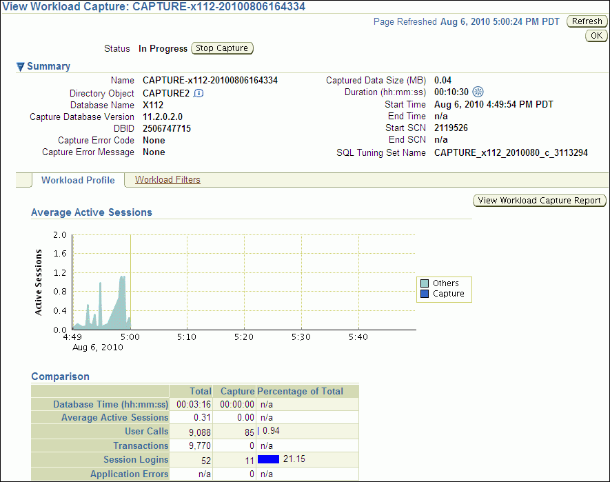

    The View Workload Capture page appears.
    Description of dbr_capture_view.gif follows
  3. Under Summary, information about the workload capture is displayed.
  4. To view the workload profile, click the Workload Profile tab.
    Under Average Active Sessions, the Active Sessions chart provides a graphic display of the captured session activity compared to the uncaptured session activity (such as background activities or filtered sessions).
    Under Comparison, various statistics for the workload capture are displayed, including database time, average active sessions, user calls, transactions, session logins, and application errors. The statistics for the total session activity are displayed in the Total column, and the statistics for the captured session activity are displayed in the Capture column. The Percentage of Total column displays the percentage of total session activity that are being captured in the workload.
    To view the workload capture report, click View Workload Capture Report.
  5. To view workload filters used by the workload capture, click the Workload Filters tab.
    Details about the workload filters used by the workload capture are displayed, including the workload filter name, type, session attribute, and value.
  6. To return to the Database Replay page, click OK.

  5. To view details about a workload capture, select the workload capture and click View.
  6. Under Summary, information about the workload capture is displayed.
  7. To view the workload profile, click the Workload Profile tab.
    Under Average Active Sessions, the Active Sessions chart provides a graphic display of the captured session activity compared to the uncaptured session activity (such as background activities or filtered sessions). This chart will be shown only when there is Active Session History (ASH) data available for the capture period.
    Under Comparison, various statistics for the workload capture are displayed, including database time, average active sessions, user calls, transactions, connects, and application errors. The statistics for the total session activity are displayed in the Total column, and the statistics for the captured session activity are displayed in the Capture column. The Percentage of Total column displays the percentage of total session activity that are being captured in the workload.
