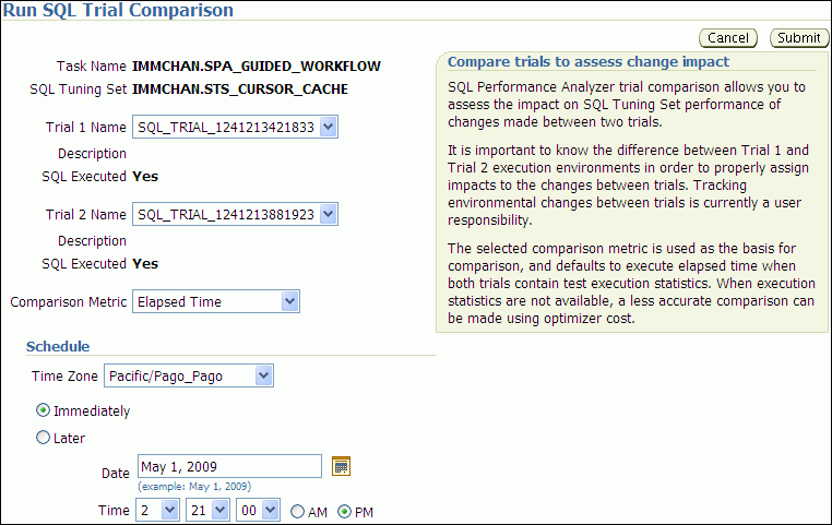

  1. On the Guided Workflow page, click the Execute icon for Compare Step 2 and Step 3.
    The Run SQL Trial Comparison page appears.
    Description of spa_run_trial_compare.gif follows
    In this example, the SQL_TRIAL_1241213421833 and SQL_TRIAL_1241213881923 trials are selected for comparison.
