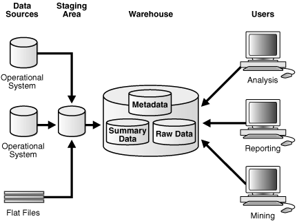

Data Warehouse Architecture: with a Staging Area
You must clean and process your operational data before putting it into the warehouse, as shown in Figure 1-3. You can do this programmatically, although most data warehouses use a staging area instead. A staging area simplifies building summaries and general warehouse management. Figure 1-3 illustrates this typical architecture.
Figure 1-3 Architecture of a Data Warehouse with a Staging Area
Description of Figure 1-3 follows
Description of "Figure 1-3 Architecture of a Data Warehouse with a Staging Area"

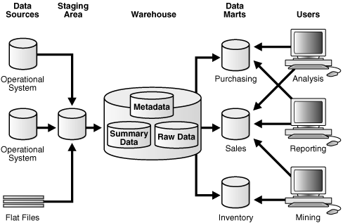

Data Warehouse Architecture: with a Staging Area and Data Marts
Although the architecture in Figure 1-3 is quite common, you may want to customize your warehouse's architecture for different groups within your organization. You can do this by adding data marts, which are systems designed for a particular line of business. Figure 1-4 illustrates an example where purchasing, sales, and inventories are separated. In this example, a financial analyst might want to analyze historical data for purchases and sales or mine historical data to make predictions about customer behavior.
Figure 1-4 Architecture of a Data Warehouse with a Staging Area and Data Marts
Description of Figure 1-4 follows
Description of "Figure 1-4 Architecture of a Data Warehouse with a Staging Area and Data Marts"
Data marts are an important part of many data warehouses, but they are not the focus of this book.
