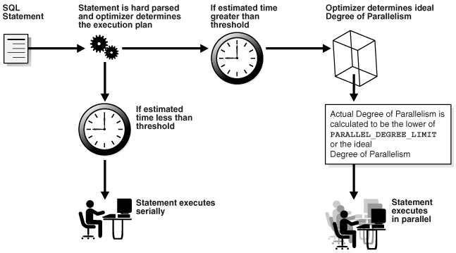

As the name implies, automatic degree of parallelism is where Oracle Database determines the degree of parallelism (DOP) with which to run a statement (DML, DDL, and queries) based on the fastest possible plan as determined by the optimizer. That means that the database parses a query, calculates the cost and then calculates a DOP to run with. The cheapest plan may be to run serially, which is also an option. Figure 6-1, "Optimizer Calculation: Serial or Parallel?" illustrates this decision making process.
Figure 6-1 Optimizer Calculation: Serial or Parallel?
Description of Figure 6-1 follows
Description of "Figure 6-1 Optimizer Calculation: Serial or Parallel?"
Should you choose to use automatic DOP, you may see many more statements running in parallel, especially if the threshold is relatively low, where low is relative to the system and not an absolute quantifier.
Because of this expected behavior of more statements running in parallel with automatic DOP, it becomes more important to manage the utilization of the parallel processes available. That means that the system should be intelligent about when to run a statement and verify whether the requested numbers of parallel processes are available. The requested number of processes in this is the DOP for that statement.
