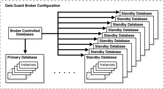

1.1.1 Data Guard Configurations and Broker Configurations
A Data Guard configuration consists of one primary database and up to thirty standby databases. The databases in a Data Guard configuration are connected by Oracle Net and may be dispersed geographically. There are no restrictions on where the databases are located as long as they can communicate with each other. For example, you can have a standby database on the same system as the primary database, along with two standby databases on another system.
The Data Guard broker logically groups these primary and standby databases into a broker configuration that allows the broker to manage and monitor them together as an integrated unit. You can manage a broker configuration using either the Oracle Enterprise Manager graphical user interface or the Data Guard command-line interface.

The broker supports one or more Data Guard configurations, each of which includes a profile for the primary database and each standby database. A supported broker configuration consists of:
Figure 1-1 shows the relationship of these objects.
Figure 1-1 Relationship of Objects Managed by the Data Guard Broker
Description of Figure 1-1 follows
Description of "Figure 1-1 Relationship of Objects Managed by the Data Guard Broker"
See also:
Chapter 3, Chapter 4, and Chapter 5 for more information about managing configuration and database objects

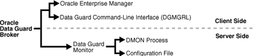

The Oracle Data Guard broker consists of the following components:
Oracle Enterprise Manager and the Data Guard command-line interface (DGMGRL) are the broker client interfaces that help you define and manage a configuration consisting of a collection of primary and standby databases. DGMGRL also includes commands to create an observer, a process that facilitates fast-start failover. Section 1.5 describes these interfaces in more detail.
The Data Guard monitor is the broker server-side component that is integrated with the Oracle database. Data Guard monitor is composed of several processes, including the DMON process, and broker configuration files that allow you to control the databases of that configuration, modify their behavior at runtime, monitor the overall health of the configuration, and provide notification of other operational characteristics. Section 1.6 describes the Data Guard monitor in more detail.

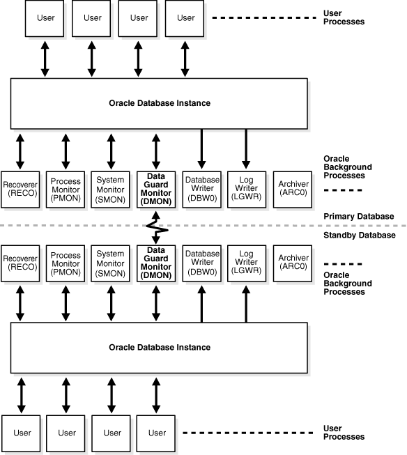

The Data Guard monitor process (DMON) is an Oracle background process that runs for every database instance that is managed by the broker. When you start the Data Guard broker, a DMON process is created.
See Also:
Section 3.3 for information on starting the broker
Whether you use Oracle Enterprise Manager or DGMGRL to manage a database, the DMON process is the server-side component that interacts with the local database and the DMON processes of the other databases to perform the requested function. The DMON process is also responsible for monitoring the health of the broker configuration and for ensuring that every database has a consistent description of the configuration.
See Also:
Oracle Database Concepts for more information about the memory structures and processes that are used with an Oracle database
Figure 1-3 shows the broker's DMON process as one of several background processes that constitute an instance of the Oracle database. Each database instance shown in the figure has its own DMON process.
Figure 1-3 Databases With Broker (DMON) Processes
Description of Figure 1-3 follows
Description of "Figure 1-3 Databases With Broker (DMON) Processes"
The zigzag arrow in the center of Figure 1-3 represents the two-way Oracle Net Services communication channel that exists between the DMON processes of two databases in the same broker configuration.
This two-way communication channel is used to pass requests between databases and to monitor the health of all of the databases in the broker configuration.
