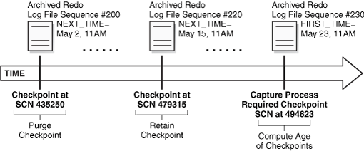

Figure 7-1 shows an example of a checkpoint being purged when the checkpoint retention time is set to 20 days.
Figure 7-1 Checkpoint Retention Time Set to 20 Days
Description of Figure 7-1 follows
Description of "Figure 7-1 Checkpoint Retention Time Set to 20 Days"
In Figure 7-1, with the checkpoint retention time set to 20 days, the checkpoint at SCN 435250 is purged because it is 21 days old, while the checkpoint at SCN 479315 is retained because it is 8 days old.

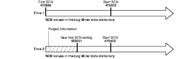

If you reset the first SCN value for an existing capture process, or if the first SCN is reset automatically when checkpoints are purged, then Oracle automatically purges LogMiner data dictionary information before the new first SCN setting. If the start SCN for a capture process corresponds to redo information that has been purged, then Oracle Database automatically resets the start SCN to the same value as the first SCN. However, if the start SCN is higher than the new first SCN setting, then the start SCN remains unchanged.
Figure 7-2 shows how Oracle automatically purges LogMiner data dictionary information prior to a new first SCN setting, and how the start SCN is not changed if it is higher than the new first SCN setting.
Figure 7-2 Start SCN Higher than Reset First SCN
Description of Figure 7-2 follows
Description of "Figure 7-2 Start SCN Higher than Reset First SCN"

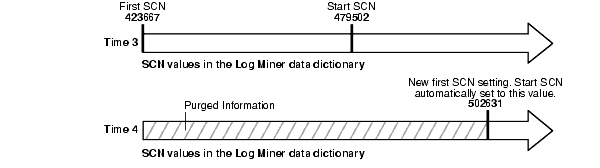

Given this example, if the first SCN is reset again to a value higher than the start SCN value for a capture process, then the start SCN no longer corresponds to existing information in the LogMiner data dictionary. Figure 7-3 shows how Oracle Database resets the start SCN automatically if it is lower than a new first SCN setting.
Figure 7-3 Start SCN Lower than Reset First SCN
Description of Figure 7-3 follows
Description of "Figure 7-3 Start SCN Lower than Reset First SCN"
As you can see, the first SCN and start SCN for a capture process can continually increase over time, and, as the first SCN moves forward, it might no longer correspond to an SCN established by the DBMS_CAPTURE_ADM.BUILD procedure.
