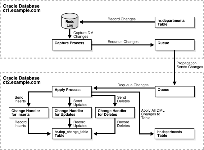

An Oracle Streams environment that records table changes has the following components:
  1. A capture process captures information about changes to the source table from the redo log. The capture process encapsulates the information for each row change in a row logical change record (row LCR). The database where the changes originated is called the source database. The database that contains the capture process is called the capture database.
  2. If the source table and change table are on different databases, then a propagation sends the captured row LCRs to the database that contains the change table. The propagation is not needed if the source table and change table are in the same database.
  3. An apply process records the information in the change table. The apply process uses statement DML handlers to insert the information in the row LCRs into the change table.
You can configure these components in the following ways:
  • Local capture and apply on one database: The source table, capture process, apply process, and change table are all in the same database. This option is the easiest to configure and maintain because all of the components are contained in one database.
  • Local capture and remote apply: The source table and capture process are in one database, and the apply process and change table are in another database. A propagation sends row LCRs from the source database to the destination database. This option is best when you want easy configuration and maintenance and when the source table and change table must reside in different databases.

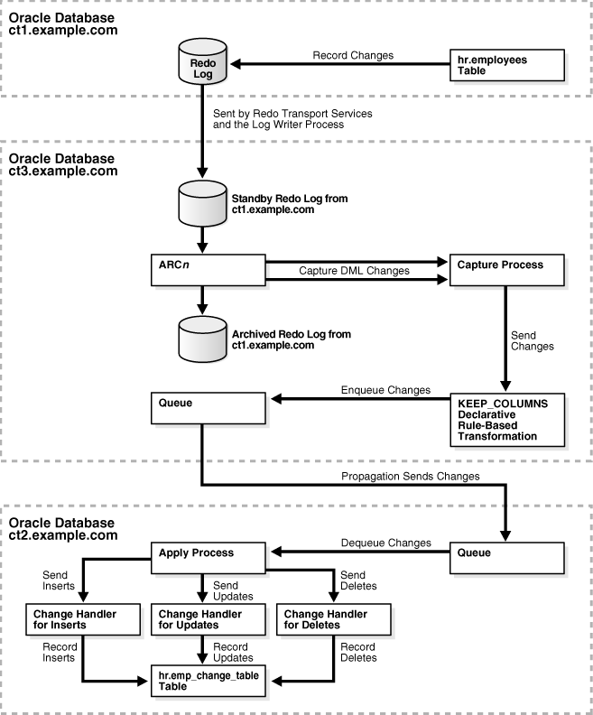

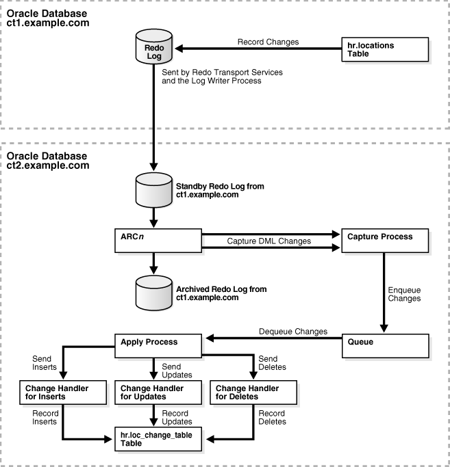

  • Downstream capture and local apply: The source table is in one database, and the capture process, apply process, and change table are in another database. This option is best when you want to optimize the performance of the database with the source table and want to offload change capture to another database. With this option, most of the components run on the database with the change table.
  • Downstream capture and remote apply: The source table is in one database, the apply process and change table are in another database, and the capture process is in a third database. This option is best when you want to optimize the performance of both the database with the source table and the database with the change table. With this option, the capture process runs on a third database, and a propagation sends row LCRs from the capture database to the destination database.
The capture database is always the database on which the MAINTAIN_CHANGE_TABLE procedure is run. Table 20-1 describes where to run the procedure to configure each type of environment.
On the source database that contains the source table
On the destination database that does not contain the source table but will contain the change table
On a third database that does not contain the source table and will not contain the change table

If you decide to configure a downstream capture process, then you must decide which type of downstream capture process you want to configure. The following types are available:
  • A real-time downstream capture process configuration means that redo transport services use the log writer process (LGWR) at the source database to send redo data to the downstream database, and a remote file server process (RFS) at the downstream database receives the redo data over the network and stores the redo data in the standby redo log.
  • An archived-log downstream capture process configuration means that archived redo log files from the source database are copied to the downstream database, and the capture process captures changes in these archived redo log files. These log files can be transferred automatically using redo transport services, or they can be transferred manually using a method such as FTP.
The advantage of real-time downstream capture over archived-log downstream capture is that real-time downstream capture reduces the amount of time required to capture changes made at the source database. The time is reduced because the real-time downstream capture process does not need to wait for the redo log file to be archived before it can capture changes from it. You can configure more than one real-time downstream capture process that captures changes from the same source database, but you cannot configure real-time downstream capture for multiple source databases at one downstream database.
The advantage of archived-log downstream capture over real-time downstream capture is that archived-log downstream capture allows downstream capture processes for multiple source databases at a downstream database. You can copy redo log files from multiple source databases to a single downstream database and configure multiple archived-log downstream capture processes to capture changes in these redo log files.

Recording Table Changes Using Local Capture and Remote Apply with Replication
This example illustrates how to record the changes to a table using local capture and remote apply. In addition to recording table changes, the Oracle Stream environment configured by this example also replicates the changes made to the table.
Specifically, this example records the changes made to a subset of columns in the hr.departments table. This example also replicates data manipulation language (DML) changes made to all of the columns in the hr.departments table. The Oracle Steams environment configured in this example captures the changes on the source database ct1.example.com and sends the changes to the destination database ct2.example.com. An apply process on ct2.example.com records the changes in a change table and applies the changes to the replica hr.departments table.
The following table lists the decisions that were made about the Oracle Streams environment configured in this example.
Decision Assumption for This Example
Decide Which Type of Environment to Configure This example configures local capture and remote apply using two databases: the source database is ct1.example.com and the destination database is ct2.example.com. The capture process will be a local capture process on ct1.example.com.
Decide Which Columns to Track This example tracks the department_id and manager_id columns in the hr.departments table.
Decide Which Metadata to Record This example records the command_type and value_type (OLD or NEW) metadata. This metadata is recorded by default when the extra_column_list parameter is not specified in MAINTAIN_CHANGE_TABLE.
Decide Which Values to Track for Update Operations This example tracks both the old and new column values when an update is performed on the source table.
Decide Whether to Configure a KEEP_COLUMNS Transformation This example does not configure a KEEP_COLUMNS declarative rule-based transformation because all of the table columns are replicated.
Decide Whether to Specify CREATE TABLE Options for the Change Table This example does not specify any CREATE TABLE options. The change table is created with the default CREATE TABLE options.
Decide Whether to Perform the Configuration Actions Directly or with a Script This example performs the configuration actions directly. It does not use a script.
Decide Whether to Replicate the Source Table This example replicates the source table at the destination database. Therefore, the hr.departments table exists on both the source database and the destination database, and the MAINTAIN_CHANGE_TABLE procedure configures a one-way replication environment for this table from the source database to the destination database.
Figure 20-2 provides an overview of the Oracle Stream environment created in this example.
Figure 20-2 Recording Changes Using Local Capture and Remote Apply with Replication
Description of Figure 20-2 follows
Description of "Figure 20-2 Recording Changes Using Local Capture and Remote Apply with Replication"
Complete the following steps to configure an Oracle Streams environment that records and replicates the changes to a table local capture and remote apply:
  1. Complete the required prerequisites before running the MAINTAIN_CHANGE_TABLE procedure. See "Prerequisites for the MAINTAIN_CHANGE _TABLE Procedure" for instructions.
    For this configuration, the following tasks must be completed:
  2. Connect to the source database ct1.example.com as the Oracle Streams administrator.
    See Oracle Database Administrator's Guide for information about connecting to a database in SQL*Plus.
  3. Run the MAINTAIN_CHANGE_TABLE procedure:
    BEGIN
      DBMS_STREAMS_ADM.MAINTAIN_CHANGE_TABLE(
        change_table_name       => 'hr.dep_change_table',
        source_table_name       => 'hr.departments',
        column_type_list        => 'department_id NUMBER(4),
                                    manager_id NUMBER(6)',
        capture_values           => '*',
        source_database          => 'ct1.example.com',
        destination_database     => 'ct2.example.com',
        keep_change_columns_only => FALSE,
        execute_lcr              => TRUE);
    END;
    This procedure uses the default value for each parameter that is not specified. The keep_change_columns_only parameter is set to FALSE because the execute_lcr parameter is set to TRUE. The row logical change records (LCRs) must contain information about changes to all of the columns in the table because all of the columns are replicated at the destination database. When the execute_lcr parameter is set to TRUE, the keep_change_columns_only parameter can be set to TRUE only if the column_type_list parameter includes all of the columns that are replicated, which is not the case in this example.
    When this procedure completes, the Oracle Streams environment is configured.
    If this procedure encounters an error and stops, then see Oracle Streams Replication Administrator's Guide for information about either recovering from the error or rolling back the configuration operation by using the DBMS_STREAMS_ADM.RECOVER_OPERATION procedure.
The resulting Oracle Streams environment has the following characteristics:
  • An unconditional supplemental log group includes the columns in the hr.departments table for which changes are recorded at the source database ct1.example.com. These columns are the ones specified in the column_type_list parameter of the MAINTAIN_CHANGE_TABLE procedure.
  • The destination database ct2.example.com has an hr.dep_change_table. This change table has the following definition:
    Name                                      Null?    Type
     COMMAND_TYPE$                                      VARCHAR2(10)
     VALUE_TYPE$                                        VARCHAR2(3)
     DEPARTMENT_ID                                      NUMBER(4)
     MANAGER_ID                                         NUMBER(6)
  • The source database ct1.example.com has a queue with a system-generated name. This queue is used by the capture process.
  • The destination database ct2.example.com has a queue with a system-generated name. This queue is used by the apply process.
  • The source database ct1.example.com has a local capture process with a system-generated name that captures data manipulation language (DML) changes made to the hr.departments table.
  • The destination database ct2.example.com has an apply process with a system-generated name. The apply process uses change handlers with system-generated names to process the captured row LCRs for inserts, updates, and deletes on the hr.departments table. The change handlers use the information in the row LCRs to populate the hr.dep_change_table.
    The apply process also includes change handlers with system-generated names to execute row LCRs for each type of operation (insert, update, and delete). The row LCRs are executed so that the changes made to the source table are applied to the replica hr.departments table at the destination database.
  • A propagation running on the ct1.example.com database with a system-generated name sends the captured changes from the ct1.example.com database to the ct2.example.com database.
Recording Table Changes Using Downstream Capture and Local Apply

Figure 20-3 provides an overview of the Oracle Stream environment created in this example.
Figure 20-3 Recording Changes Using Downstream Capture and Local Apply
Description of Figure 20-3 follows
Description of "Figure 20-3 Recording Changes Using Downstream Capture and Local Apply"
Complete the following steps to configure an Oracle Streams environment that records the changes to a table using downstream capture and remote apply:
    • Configure an Oracle Streams administrator on both databases. See "Configure an Oracle Streams Administrator on All Databases".
    • Configure network connectivity and database links:
      • Configure network connectivity between the source database ct1.example.com and the destination database ct2.example.com.
      • Because downstream capture will be configured at the destination database, create a database link from the source database ct1.example.com to the destination database ct2.example.com. The database link is used to send redo log data from ct1.example.com to ct2.example.com.
      • Because downstream capture will be configured at the destination database, create a database link from the destination database ct2.example.com to the source database ct1.example.com. The database link is used to complete management tasks related to downstream capture on the source database.
      See Oracle Streams Replication Administrator's Guide for instructions.
    • Ensure that the source database and the destination database are in ARCHIVELOG mode. In this example, the source database is ct1.example.com and the destination database is ct2.example.com. See "Ensure That the Source Database Is in ARCHIVELOG Mode".
    • Ensure that the initialization parameters are set properly at both databases. See "Set Initialization Parameters That Are Relevant to Oracle Streams".
    • Configure the Oracle Streams pool properly at both databases. See "Configure the Oracle Streams Pool".
    • Because a destination database will be the capture database for changes made to the source database, configure log file copying from the source database ct1.example.com to the capture database ct2.example.com. See "Configure Log File Transfer to a Downstream Capture Database".
    • Because this example configures a real-time downstream capture process, add standby redo logs at the capture database, and configure standby redo logs at the capture database ct2.example.com. See "Configure Standby Redo Logs for Real-Time Downstream Capture".
  2. Connect to the destination database ct2.example.com as the Oracle Streams administrator.
    BEGIN
        change_table_name       => 'hr.loc_change_table',
        source_table_name       => 'hr.locations',
        column_type_list        => 'location_id NUMBER(4),
                                    street_address VARCHAR2(40),
                                    postal_code VARCHAR2(12),
                                    city VARCHAR2(30),
                                    state_province VARCHAR2(25),
                                    country_id CHAR(2)',
        extra_column_list       => 'command_type,value_type,object_owner,
                                    object_name,username',
        keep_change_columns_only => FALSE);
    END;
    This procedure uses the default value for each parameter that is not specified. The keep_change_columns_only parameter is set to FALSE because all of the columns in the hr.locations table are listed in the column_type_list parameter.
  4. Set the downstream_real_time_mine capture process parameter to Y.
    1. Query the CAPTURE_NAME column in the DBA_CAPTURE view to determine the name of the capture process.
    2. Run the SET_PARAMETER procedure in the DBMS_CAPTURE_ADM package to set the downstream_real_time_mine capture process parameter to Y.
      For example, if the capture process name is cap$chg5, then run the following procedure:
      BEGIN
        DBMS_CAPTURE_ADM.SET_PARAMETER(
          capture_name => 'cap$chg5',
          parameter    => 'downstream_real_time_mine',
          value        => 'Y');
      END;
  5. Connect to the source database ct1.example.com as an administrative user with the necessary privileges to switch log files.
  6. Archive the current log file at the source database:
    ALTER SYSTEM ARCHIVE LOG CURRENT;
    Archiving the current log file at the source database starts real time mining of the source database redo log.
  • An unconditional supplemental log group at the source database ct1.example.com includes all o the columns in the hr.locations table.
  • Because username is specified in the extra_column_list parameter, the source database is configured to place additional information about the username of the user who makes a change in the redo log. The capture process captures this information, and it is recorded in the change table. The other values specified in the extra_column_list parameter (command_type, value_type, object_owner, and object_name) are always tracked in the redo log. Therefore, no additional configuration is necessary to capture this information.
  • The destination database ct2.example.com has an hr.loc_change_table. This change table has the following definition:
    Name                                      Null?    Type
     OBJECT_OWNER$                                      VARCHAR2(30)
     OBJECT_NAME$                                       VARCHAR2(30)
     USERNAME$                                          VARCHAR2(30)
     LOCATION_ID                                        NUMBER(4)
     STREET_ADDRESS                                     VARCHAR2(40)
     POSTAL_CODE                                        VARCHAR2(12)
     CITY                                               VARCHAR2(30)
     STATE_PROVINCE                                     VARCHAR2(25)
     COUNTRY_ID                                         CHAR(2)
  • The destination database ct2.example.com has a queue with a system-generated name. This queue is used by the downstream capture process and the apply process.
  • The destination database ct2.example.com has a real-time downstream capture process with a system-generated name that captures data manipulation language (DML) changes made to the hr.locations table.
  • The destination database ct2.example.com has an apply process with a system-generated name. The apply process uses change handlers with system-generated names to process the captured row LCRs for inserts, updates, and deletes on the hr.locations table. The change handlers use the information in the row LCRs to populate the hr.loc_change_table.

Figure 20-4 provides an overview of the Oracle Stream environment created in this example.
Figure 20-4 Recording Changes Using Downstream Capture and Remote Apply
Description of Figure 20-4 follows
Description of "Figure 20-4 Recording Changes Using Downstream Capture and Remote Apply"
    • Configure an Oracle Streams administrator on all of three databases. See "Configure an Oracle Streams Administrator on All Databases".
      • Configure network connectivity between the source database ct1.example.com and the third database ct3.example.com.
      • Configure network connectivity between the destination database ct2.example.com and the third database ct3.example.com.
      • Create a database link from the source database ct1.example.com to the destination database ct2.example.com.
      • Because downstream capture will be configured at the third database, create a database link from the source database ct1.example.com to the third database ct3.example.com.
      • Because downstream capture will be configured at the third database, create a database link from the third database ct3.example.com to the source database ct1.example.com.
      • Because downstream capture will be configured at the third database, create a database link from the third database ct3.example.com to the destination database ct2.example.com.
    • Ensure that the source database and the capture database are in ARCHIVELOG mode. In this example, the source database is ct1.example.com and the capture database is ct3.example.com. See "Ensure That the Source Database Is in ARCHIVELOG Mode".
    • Ensure that the initialization parameters are set properly at all databases. See "Set Initialization Parameters That Are Relevant to Oracle Streams".
    • Configure the Oracle Streams pool properly at all databases. See "Configure the Oracle Streams Pool".
    • Because a third database (ct3.example.com) will be the capture database for changes made to the source database, configure log file copying from the source database ct1.example.com to the capture database ct3.example.com. See "Configure Log File Transfer to a Downstream Capture Database".
    • Because this example configures a real-time downstream capture process, add standby redo logs at the capture database, and configure standby redo logs at the capture database ct3.example.com. See "Configure Standby Redo Logs for Real-Time Downstream Capture".
  2. Connect to the capture database ct3.example.com as the Oracle Streams administrator.
    BEGIN
        change_table_name       => 'hr.emp_change_table',
        source_table_name       => 'hr.employees',
        column_type_list        => 'employee_id VARCHAR2(6),
                                    first_name VARCHAR2(20),
                                    last_name VARCHAR2(25),
                                    email VARCHAR2(25),
                                    phone_number VARCHAR2(20),
                                    hire_date DATE,
                                    job_id VARCHAR2(10),
                                    manager_id NUMBER(6),
                                    department_id NUMBER(4)',
        options_string          => 'STORAGE (INITIAL     6144
                                             NEXT        6144
                                             MINEXTENTS     1
                                             MAXEXTENTS     5)',
        keep_change_columns_only => TRUE);
    END;
    This procedure uses the default value for each parameter that is not specified. The options_string parameter specifies a storage clause for the change table. The keep_change_columns_only parameter is set to TRUE to create a keep columns declarative rule-based transformation that excludes the salary and commission_pct columns from captured row logical change records (LCRs). The salary and commission_pct columns are excluded because they are not in the column_type_list parameter.
      BEGIN
          value        => 'Y');
      END;
  • An unconditional supplemental log group includes the columns in the hr.employees table for which changes are recorded at the source database ct1.example.com. These columns are the ones specified in the column_type_list parameter of the MAINTAIN_CHANGE_TABLE procedure.
  • The destination database ct2.example.com has an hr.emp_change_table. This change table has the following definition:
    Name                                      Null?    Type
     EMPLOYEE_ID                               NOT NULL NUMBER(6)
     FIRST_NAME                                         VARCHAR2(20)
     LAST_NAME                                 NOT NULL VARCHAR2(25)
     EMAIL                                     NOT NULL VARCHAR2(25)
     PHONE_NUMBER                                       VARCHAR2(20)
     HIRE_DATE                                 NOT NULL DATE
     JOB_ID                                    NOT NULL VARCHAR2(10)
  • The capture database ct3.example.com has a queue with a system-generated name. This queue is used by the downstream capture process.
  • The capture database ct3.example.com has a real-time downstream capture process with a system-generated name that captures data manipulation language (DML) changes made to the hr.employees table.
  • The capture database ct3.example.com has a KEEP_COLUMNS declarative rule-based transformation that keeps all of the columns in the row LCRs for the hr.employees table, except for the salary and commission_pct columns.
  • A propagation running on the ct3.example.com database with a system-generated name sends the captured changes from the ct3.example.com database to the ct2.example.com database.
  • The destination database ct2.example.com has an apply process with a system-generated name. The apply process uses change handlers with system-generated names to process the captured row LCRs for inserts, updates, and deletes on the hr.employees table. The change handlers use the information in the row LCRs to populate the hr.emp_change_table.
