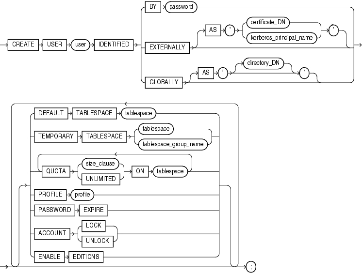

Use the CREATE USER statement to create and configure a database user, which is an account through which you can log in to the database, and to establish the means by which Oracle Database permits access by the user.

Specify the name of the user to be created. This name can contain only characters from your database character set and must follow the rules described in the section "Database Object Naming Rules". Oracle recommends that the user name contain at least one single-byte character regardless of whether the database character set also contains multibyte characters.
Oracle recommends that user names and passwords be encoded in ASCII or EBCDIC characters only, depending on your platform.See Also:
"Creating a Database User: Example"The IDENTIFIED clause lets you indicate how Oracle Database authenticates the user.
The BY password clause lets you creates a local user and indicates that the user must specify password to log on to the database. Passwords are case sensitive. Any subsequent CONNECT string used to connect this user to the database must specify the password using the same case (upper, lower, or mixed) that is used in this CREATE USER statement or a subsequent ALTER USER statement. Passwords can contain any single-byte, multibyte, or special characters, or any combination of these, from your database character set.

Oracle Database Security Guide to for a detailed discussion of password management and protectionSpecify EXTERNALLY to create an external user. Such a user must be authenticated by an external service, such as an operating system or a third-party service. In this case, Oracle Database relies on authentication by the operating system or third-party service to ensure that a specific external user has access to a specific database user.
AS 'certificate_DN' This clause is required for and used for SSL-authenticated external users only. The certificate_DN is the distinguished name in the user's PKI certificate in the user's wallet. The maximum length of certificate_DN is 1024 characters.
AS 'kerberos_principal_name' This clause is required for and used for Kerberos-authenticated external users only. The maximum length of kerberos_principal_name is 1024 characters.

The GLOBALLY clause lets you create a global user. Such a user must be authorized by the enterprise directory service (Oracle Internet Directory).
The directory_DN string can take one of two forms:
The X.509 name at the enterprise directory service that identifies this user. It should be of the form CN=username,other_attributes, where other_attributes is the rest of the user's distinguished name (DN) in the directory. This form creates a private global schema.
A null string (' ') indicating that the enterprise directory service will map authenticated global users to this database schema with the appropriate roles. This form is the same as specifying the GLOBALLY keyword alone and creates a shared global schema.
The maximum length of directory_DN is 1024 characters.

Specify the default tablespace for objects that are created in the user's schema. If you omit this clause, then the user's objects are stored in the database default tablespace. If no default tablespace has been specified for the database, then the user's objects are stored in the SYSTEM tablespace.

Specify the tablespace or tablespace group for the user's temporary segments. If you omit this clause, then the user's temporary segments are stored in the database default temporary tablespace or, if none has been specified, in the SYSTEM tablespace.
Specify tablespace to indicate the user's temporary tablespace.
Specify tablespace_group_name to indicate that the user can save temporary segments in any tablespace in the tablespace group specified by tablespace_group_name.

Use the QUOTA clause to specify the maximum amount of space the user can allocate in the tablespace.
A CREATE USER statement can have multiple QUOTA clauses for multiple tablespaces.
UNLIMITED lets the user allocate space in the tablespace without bound.

size_clause for information on that clause and Oracle Database Security Guide for more information on assigning tablespace quotasSpecify the profile you want to assign to the user. The profile limits the amount of database resources the user can use. If you omit this clause, then Oracle Database assigns the DEFAULT profile to the user.
Oracle recommends that you use the Database Resource Manager rather SQL profiles to establish database resource limits. The Database Resource Manager offers a more flexible means of managing and tracking resource use. For more information on the Database Resource Manager, refer to Oracle Database Administrator's Guide.Specify PASSWORD EXPIRE if you want the user's password to expire. This setting forces the user or the DBA to change the password before the user can log in to the database.
Specify ACCOUNT LOCK to lock the user's account and disable access. Specify ACCOUNT UNLOCK to unlock the user's account and enable access to the account.
This clause is not reversible. Specify ENABLE EDITIONS to allows the user to create multiple versions of editionable objects in this schema using editions. Editionable objects in schemas that are not editions-enabled cannot be editioned.
