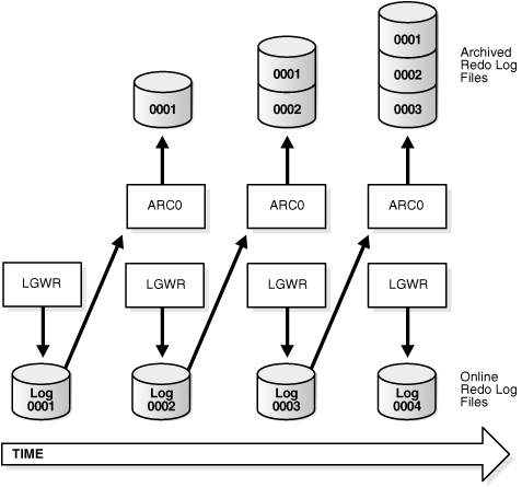

You can configure an instance to archive filled redo log files automatically, or you can archive manually. For convenience and efficiency, automatic archiving is usually best. Figure 13-1 illustrates how the archiver process (ARC0 in this illustration) writes filled redo log files to the database archived redo log.

Figure 13-1 Redo Log File Use in ARCHIVELOG Mode
