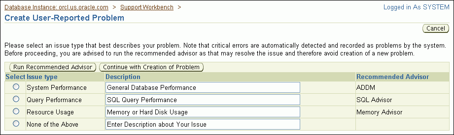

Under Related Links, click Create User-Reported Problem.
The Create User-Reported Problem page appears.
If your problem matches one of the listed issue types, select the issue type, and then click Run Recommended Advisor to attempt to solve the problem with an Oracle advisor.
If the recommended advisor did not solve the problem, or if you did not run an advisor, do one of the following:
If your problem matches one of the listed issue types, select the issue type, and then click Continue with Creation of Problem.
If your problem does not match one of the listed issue types, select the issue type None of the Above, enter a description, and then click Continue with Creation of Problem.
The Problem Details page appears.
Follow the instructions on the Problem Details page.
