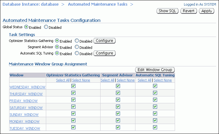

The Automatic Segment Advisor is an automated maintenance task that is configured to run during all maintenance windows.
The Automatic Segment Advisor does not analyze every database object. Instead, it examines database statistics, samples segment data, and then selects the following objects to analyze:
Tablespaces that have exceeded a critical or warning space threshold
Segments that have the most activity
Segments that have the highest growth rate
In addition, the Automatic Segment Advisor evaluates tables that are at least 10MB and that have at least three indexes to determine the amount of space saved if the tables are compressed with the OLTP compression method.
If an object is selected for analysis but the maintenance window expires before the Segment Advisor can process the object, the object is included in the next Automatic Segment Advisor run.
You cannot change the set of tablespaces and segments that the Automatic Segment Advisor selects for analysis. You can, however, enable or disable the Automatic Segment Advisor task, change the times during which the Automatic Segment Advisor is scheduled to run, or adjust automated maintenance task system resource utilization. See "Configuring the Automatic Segment Advisor" for more information.

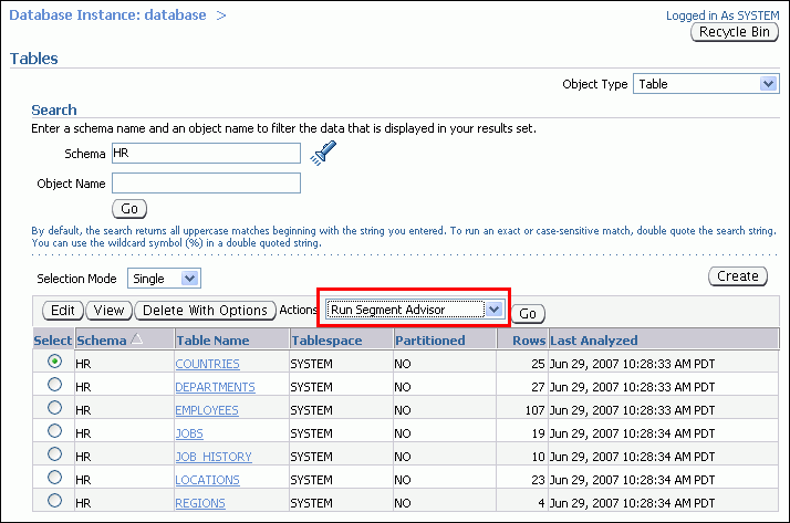

Using the Run Segment Advisor command on a schema object page.
For example, if you display a list of tables on the Tables page (accessible from the Schema page), you can select a table and then select the Run Segment Advisor command from the Actions menu.
This method enables you to include the schema object's dependent objects in the Segment Advisor run. For example, if you select a table and select the Run Segment Advisor command, Enterprise Manager displays the table's dependent objects, such as partitions, index segments, LOB segments, and so on. You can then select dependent objects to include in the run.

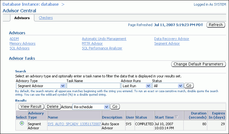

To run the Segment Advisor manually with the Segment Advisor Wizard:
From the database Home page, under Related Links, click Advisor Central.
The Advisor Central page appears. (See Figure 19-2.)
Under Advisors, click Segment Advisor.
The first page of the Segment Advisor wizard appears.
Follow the wizard steps to schedule the Segment Advisor job, and then click Submit on the final wizard page.
The Advisor Central page reappears, with the new Segment Advisor job at the top of the list under the Results heading. The job status is SCHEDULED or RUNNING. (If you do not see your job, use the search fields above the list to display it.)
Check the status of the job. If it is not COMPLETED, click the Refresh button at the top of the page repeatedly. (Do not use your browser's Refresh icon.)
When the job status changes to COMPLETED, select the job by clicking in the Select column, and then click View Result.

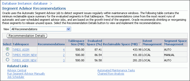

To view Segment Advisor results with Enterprise Manager—All runs:
On the database Home page, under the Space Summary heading, click the numeric link next to the title Segment Advisor Recommendations.
The Segment Advisor Recommendations page appears. Recommendations are organized by tablespace.

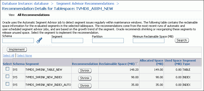

If any recommendations are present, select a tablespace, and then click Recommendation Details.
The Recommendation Details page appears. You can initiate the recommended activity from this page (shrink or reorganize).
Tip:
The list entries are sorted in descending order by reclaimable space. You can click column headings to change the sort order or to change from ascending to descending order.To view Segment Advisor results with Enterprise Manager—Last Automatic Segment Advisor run:
The Segment Advisor Recommendations page appears. (See Figure 19-3.)
In the View list, select Recommendations from Last Automatic Run.
If any recommendations are present, select a tablespace and click Recommendation Details.
The Recommendation Details page appears. (See Figure 19-4.) You can initiate the recommended activity from this page (shrink or reorganize).

Start at the Advisor Central page.
If you ran the Segment Advisor with the Enterprise Manager wizard, the Advisor Central page appears after you submit the Segment Advisor task. Otherwise, to get to this page, on the Database Home page, under Related Links, click Advisor Central.
Check that your task appears in the list under the Results heading. If it does not, complete these steps (See Figure 19-2):
In the Search section of the page, under Advisor Tasks, select Segment Advisor in the Advisory Type list.
In the Advisor Runs list, select All or the desired time period.
(Optional) Enter a task name.
Click Go.
Your Segment Advisor task appears in the Results section.
Check the status of the job. If it is not COMPLETED, click the Refresh button at the top of the page until your task status shows COMPLETED. (Do not use your browser's refresh icon.)
Click the task name.
The Segment Advisor Task page appears, with recommendations organized by tablespace.
Select a tablespace in the list, and then click Recommendation Details.

The ASA_RECOMMENDATIONS procedure in the DBMS_SPACE package returns a nested table object that contains findings or recommendations for Automatic Segment Advisor runs and, optionally, manual Segment Advisor runs. Calling this procedure may be easier than working with the DBA_ADVISOR_* views, because the procedure performs all the required joins for you and returns information in an easily consumable format.
The following query returns recommendations by the most recent run of the Auto Segment Advisor, with the suggested command to run to follow the recommendations:
select tablespace_name, segment_name, segment_type, partition_name,
recommendations, c1 from
table(dbms_space.asa_recommendations('FALSE', 'FALSE', 'FALSE'));

The Automatic Segment Advisor is an automated maintenance task. As such, you can use Enterprise Manager or PL/SQL package procedure calls to modify when (and if) this task runs. You can also control the resources allotted to it by modifying the appropriate resource plans.
You can call PL/SQL package procedures to make these changes, but the easier way to is to use Enterprise Manager.
To configure the Automatic Segment Advisor task with Enterprise Manager:
Log in to Enterprise Manager as user SYSTEM.
On the Database Home page, under the Space Summary heading, click the numeric link next to the label Segment Advisor Recommendations.
Under the Related Links heading, click the link entitled Automated Maintenance Tasks.
The Automated Maintenance Tasks page appears.
Click Configure.
The Automated Maintenance Tasks Configuration page appears.
To completely disable the Automatic Segment Advisor, under Task Settings, select Disabled next to the Segment Advisor label, and then click Apply.
To disable the Automatic Segment Advisor for specific maintenance windows, clear the desired check boxes under the Segment Advisor column, and then click Apply.
To modify the start and end times and durations of maintenance windows, click Edit Window Group.
The Edit Window Group page appears. Click the name of a maintenance window, and then click Edit to change the window's schedule.
The following views display information specific to the Automatic Segment Advisor. For details, see Oracle Database Reference.
| View | Description |
DBA_AUTO_SEGADV_SUMMARY |
Each row of this view summarizes one Automatic Segment Advisor run. Fields include number of tablespaces and segments processed, and number of recommendations made. |
DBA_AUTO_SEGADV_CTL |
Contains control information that the Automatic Segment Advisor uses to select and process segments. Each row contains information on a single object (tablespace or segment), including whether the object has been processed, and if so, the task ID under which it was processed and the reason for selecting it. |

Before invoking online segment shrink, view the findings and recommendations of the Segment Advisor. For more information, see "Using the Segment Advisor".
You invoke online segment shrink with Oracle Enterprise Manager or with SQL commands in SQL*Plus. The remainder of this section discusses the command line method.
You can invoke segment shrink directly from the Recommendation Details page in Enterprise Manager. (See Figure 19-4.) Or, to invoke segment shrink for an individual table in Enterprise Manager, display the table on the Tables page, select the table, and then click Shrink Segment in the Actions list. (See Figure 19-1.) Perform a similar operation in Enterprise Manager to shrink indexes, materialized views, and so on.You can shrink space in a table, index-organized table, index, partition, subpartition, materialized view, or materialized view log. You do this using ALTER TABLE, ALTER INDEX, ALTER MATERIALIZED VIEW, or ALTER MATERIALIZED VIEW LOG statement with the SHRINK SPACE clause.
