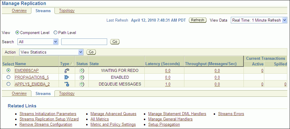

  5. Select the capture process to start or stop in the list of components. If necessary, use the search tool to find the capture process, and then select it.
  6. In the Action list, select Enable to start a disabled or aborted capture process, or select Disable to stop an enabled capture process.
  7. Click Go.
  8. If you are disabling the capture process, then click Yes on the confirmation page to finish disabling it.
You can also use the START_CAPTURE procedure and STOP_CAPTURE procedure in the DBMS_CAPTURE_ADM package to start and stop a capture process.

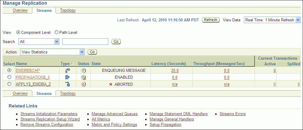

Starting and Stopping an Apply Process
This topic contains instructions for starting and stopping an apply process in Enterprise Manager.
An apply process might stop automatically if it encounters an error, such as attempting to update a row that does not exist in a table. When this happens, the status of the apply process is ABORTED on the Apply subpage of the Manage Replication page in Enterprise Manager. In this case, you should correct the error and restart the apply process.
To start or stop an apply process:
  1. In Oracle Enterprise Manager, log in to the database as the Oracle Streams administrator.
  2. Go to the Database Home page.
  3. Under High Availability, click the number link in Streams Components.
    The Manage Replication page appears, showing the Overview subpage.
  4. Click Streams to open the Streams subpage.
    Description of tdpii_strrms_strms.gif follows
  5. Select the apply process to start or stop in the list of components. If necessary, use the search tool to find the apply process, and then select it.
  6. In the Action list, select Enable to start a disabled or aborted apply process, or select Disable to stop an enabled apply process.
  7. Click Go.
  8. If you are disabling the apply process, then click Yes on the confirmation page to finish disabling it.
You can also use the START_APPLY procedure and STOP_APPLY procedure in the DBMS_APPLY_ADM package to start and stop an apply process.

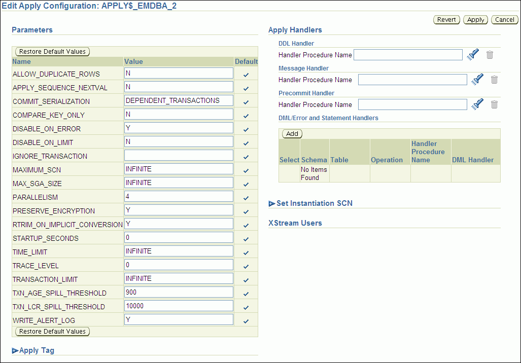

Setting an Apply Process Parameter
This topic contains instructions for setting apply process parameters in Enterprise Manager. Apply process parameters control the way an apply process operates. You can set a parameter to change a specific way in which an apply process operates. For example, you can change the parallelism apply process parameter to control the number of processes that apply changes. Typically, you adjust apply process parallelism to achieve the best apply process performance.
To set an apply process parameter:
  5. Select the apply process to modify in the list of components. If necessary, use the search tool to find the apply process, and then select it.
  6. Select Configurations in Action.
  7. Click Go to open the Configurations subpage.
  8. Click Edit to open the Edit Apply Configuration page.
    Description of tdpii_edit_apply.gif follows
  9. Modify one or more apply process parameters in the Parameters section.
    See Oracle Database PL/SQL Packages and Types Reference for information about the parameters. If you change the parallelism parameter, then the apply process automatically stops and restarts when you click Apply.
  10. Click Apply to save your changes.
You can also use the DBMS_APPLY_ADM.SET_PARAMETER procedure to set an apply process parameter.

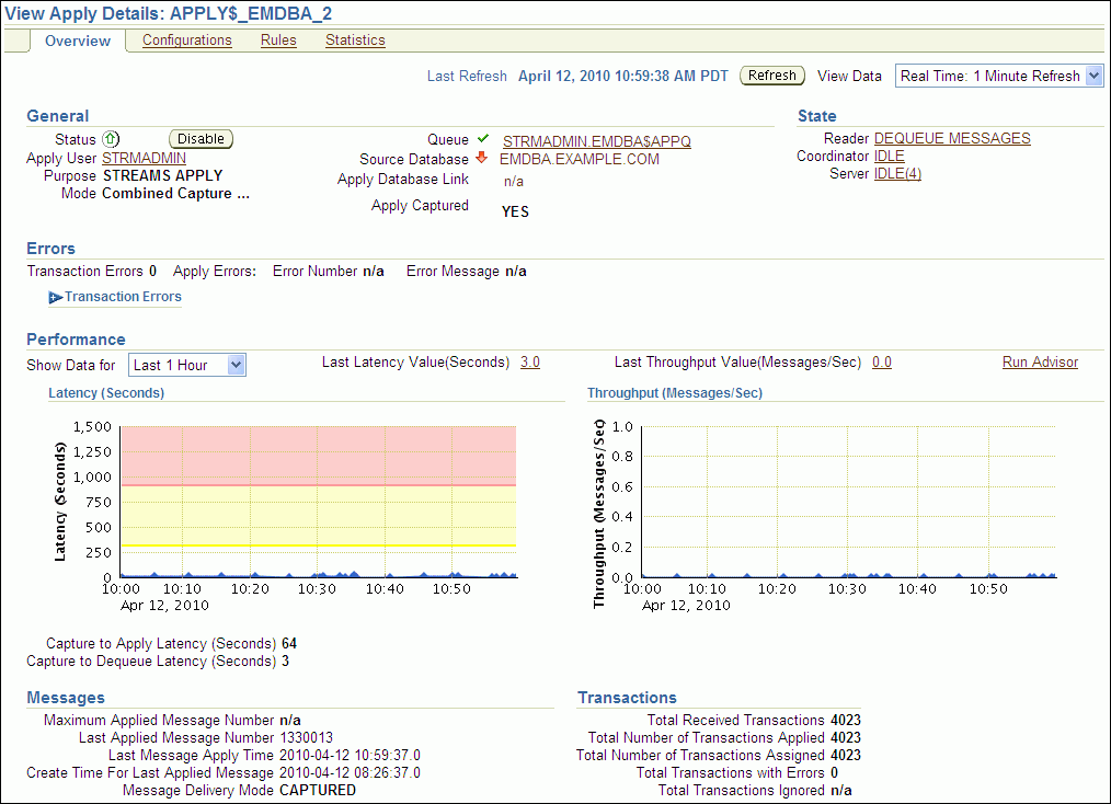

Displaying an Overview of the Replication Components at a Database

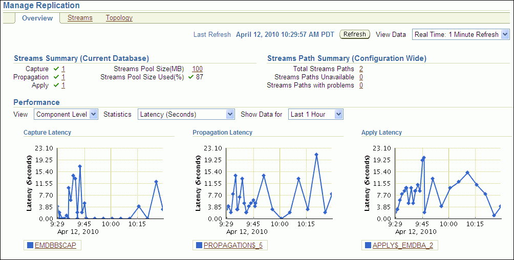

The Overview subpage of the Manage Replication page in Enterprise Manager contains information about the Oracle Streams components in the current database. This information includes:
  • General information about the Streams pool size
  • The number of capture processes, propagations, and apply processes in the local database
  • The number of capture processes, propagations, and apply processes that currently have errors
  • A summary of the Stream paths that flow through the Oracle Streams components at the local database
  • Graphs that show the latency and throughput for capture processes, propagations, and apply processes
You can click a number to drill down to more information about a component or to manage a component.

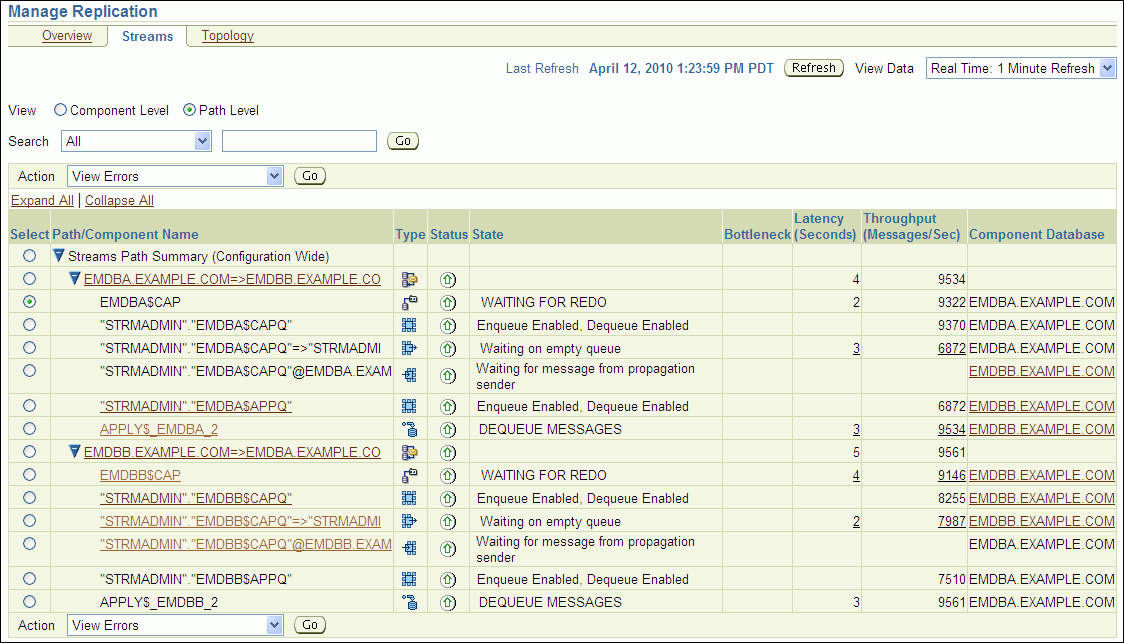

Displaying the Stream Paths
Oracle Enterprise Manager uses the Oracle Streams Performance Advisor to track the stream paths for the Oracle Streams components in a database. The Oracle Streams components include capture processes, queues, propagation senders, propagation receivers, and apply processes. The Oracle Streams Performance Advisor enables you to monitor these components are performing. The Oracle Streams Performance Advisor also tracks the links between the components, and the way information flows from capture to consumption.
A stream path is a flow of messages from a source to a destination. A stream path begins where a capture process, synchronous capture, or application enqueues messages into a queue. A stream path ends where an apply process dequeues the messages. The stream path might flow through multiple queues and propagations before it reaches the apply process. Therefore, a single stream path can consist of multiple source/destination component pairs before it reaches the apply process.
To display a stream paths for the Oracle Streams components in a database:
  5. Select the Path Level option in View.
Description of tdpii_streams_paths.gif follows
Oracle Streams Concepts and Administration contains detailed information about stream paths. You can click the link for a statistic for detailed information about the statistic.
Also, the path level view shows if any components are bottleneck components. A bottleneck component is the busiest component or the component with the least amount of idle time. If there are bottleneck components, then check the status of these components. If they are disabled, then you can enable them. If these components are enabled, then you can examine the components to see if they can be modified to perform better.
In Database Control, links are not available for statistics that are for components that run on a remote database.

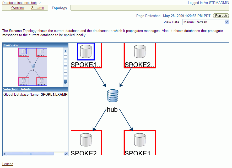

Displaying the Topology of the Oracle Streams Environment at a Database
An Oracle Streams topology displays a graphical representation of the local database and other databases that interact with the local database in the Oracle Streams environment. In a replication environment, the topology shows the following information about the databases displayed:
  • The database links used by propagations from the current database to other databases in the Oracle Streams environment. Each arrow that originates at the current database shows a database link used by a propagation from the current database to another database. Replication environments use database links to send changes made to replicated objects to other databases.
  • The database links used by propagations from other databases in the Oracle Streams environment to the current database for which an apply process at the current database applies the propagated messages. Each arrow that terminates at the current database shows a database link used by a propagation from another database to the current database whose messages are applied at the current database.
To view the Oracle Streams topology:
  4. Click Topology to open the Topology subpage.
You can use the Overview window to select a particular portion of the topology to view in detail and to zoom in and zoom out. You can also select a database in the topology and view the Selection Details window for information about the database.
Click the Legend link for more information about the Oracle Streams topology.
The following graphic shows an example of the Oracle Streams topology for an Oracle Streams replication environment:
Description of tdpii_streams_topology.gif follows
The Oracle Streams topology in the previous figure shows a hub-and-spoke replication configuration. The configuration includes the following elements:
  • The current database is named hub.
  • The spoke1.example.com database is part of the replication environment that interacts with the current database. There is a database link from this database to the hub database and from the hub database to this database.
  • The spoke2.example.com database is part of the replication environment that interacts with the current database. There is a database link from this database to the hub database and from the hub database to this database.

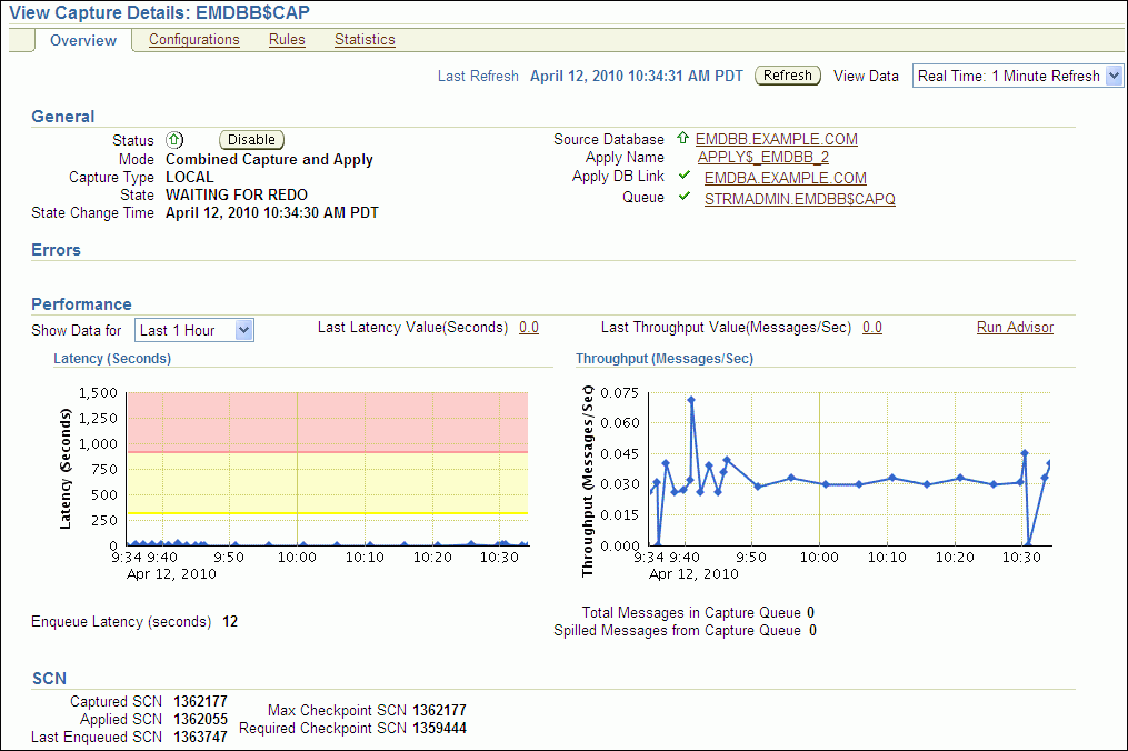

  7. Click Go to open the View Capture Details page.
Description of tdpii_view_capture_details.gif follows
The View Capture Details page includes detailed information about the capture process.

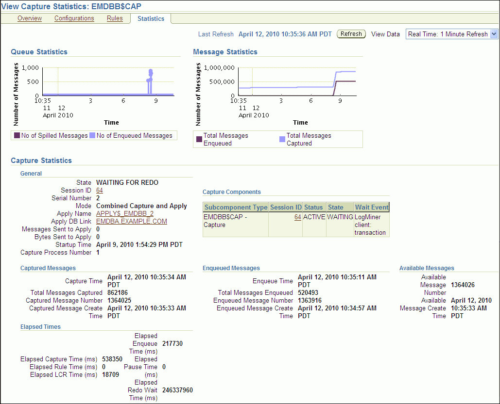

Viewing Statistics for a Capture Process
You can use Enterprise Manager to view statistics for a capture process. The statistics include the number of messages in the capture process's queue, the number of messages captured and enqueued by the capture process, and other statistics relating to the capture process.
To view statistics for a capture process in Enterprise Manager:
    The Streams subpage shows general information about each capture process in the database. This information includes capture process status, state, latency, and throughput.
  5. Select the capture process to monitor in the list of components. If necessary, use the search tool to find the capture process, and then select it.
  6. Select View Statistics in Action.
  7. Click Go to open the View Capture Statistics page.
Description of tdpii_view_capture_stats.gif follows
The View Capture Statistics page includes the following information:
  • The Queue Statistics graph shows the number of messages currently in the capture process's queue. The No of Enqueued Messages line in the graph shows the total number of messages currently in the buffered queue. The No of Spilled Messages line in the graph shows the total number of messages that have spilled from memory into the persistent queue table.
  • The Message Statistics graph shows the total number of changes enqueued and captured by the capture process since it last started. Total Messages Enqueued shows the number of changes enqueued by the capture process. Total Messages Captured shows the number of changes that were evaluated in detail against the capture process rules. If a change does not satisfy the capture process rules, then the change is not enqueued.
  • The Capture Statistics section includes the current state of the capture process, and statistics related to time and changes (messages) captured. See the documentation for the V$STREAMS_CAPTURE dynamic performance view in Oracle Database Reference for more information about these statistics.

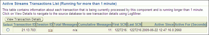

    The Capture subpage shows general information about each capture process in the database. This information includes capture process status, state, latency, and throughput.
  5. Click the number link in the Current Transactions Active field for the capture process to open the View Capture Statistics page.
    The Active Streams Transactions List section displays the active capture process transactions.
    Description of tdpii_active_cap_trans.gif follows
    The Session ID and Total Messages fields do not apply to capture processes.

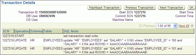

  6. To drill-down for more information about a transaction, select the transaction and click View Transaction Details.
  7. On the LogMiner page, click Continue.
  8. On the LogMiner Results page, click the Transaction ID link in the table in the Transaction Results section.
    The Transaction Details page displays detailed information about the changes in the transaction.
    Description of tdpii_cap_trans_detailes.gif follows

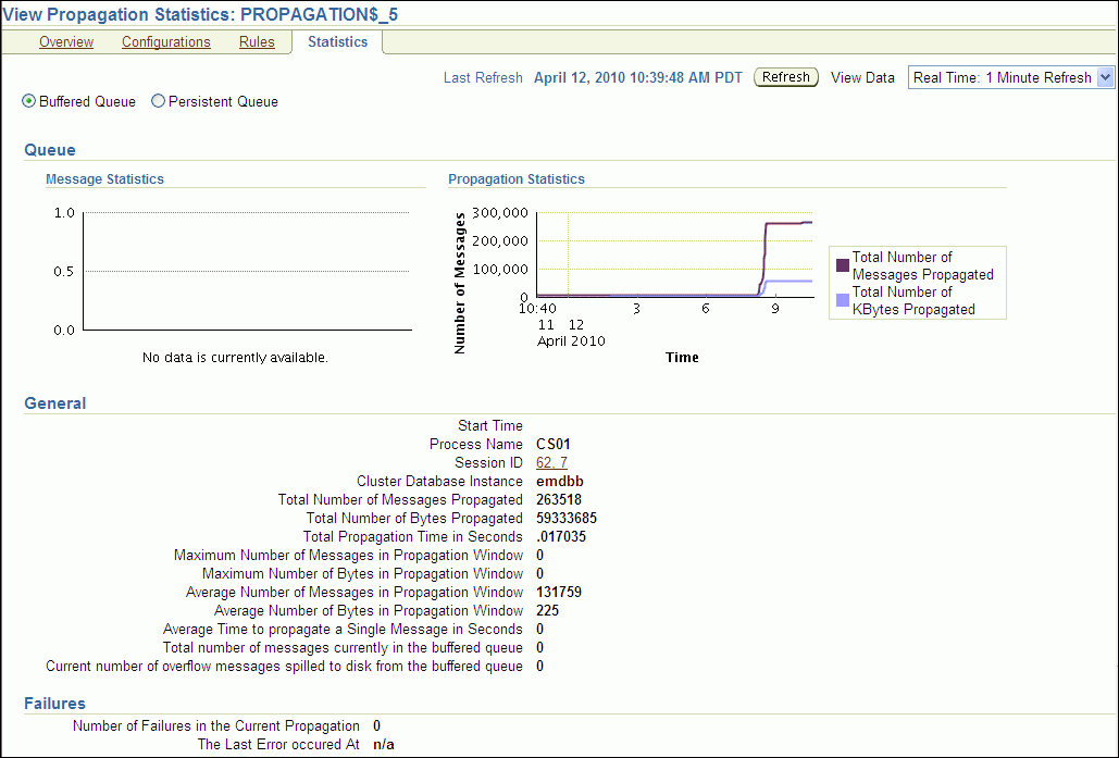

Viewing Statistics for a Propagation
You can use Enterprise Manager to view statistics for a propagation. The statistics include the number of messages in the propagation source queue, the number of messages sent by the propagation, and other statistics relating to the propagation.
To view statistics for a propagation in Enterprise Manager:
  5. Select the propagation to monitor in the list of components. If necessary, use the search tool to find the propagation, and then select it.
  7. Click Go to open the View Propagation Statistics page.
The View Propagation Statistics page includes the following subpages:
  • The Buffered Queue option shows propagation statistics for messages that were enqueued into the buffered queue portion of the queue used by the propagation. Use this subpage to view propagation statistics if the propagation sends changes captured by a capture process.
  • The Persistent Queue option shows propagation statistics for messages that were enqueued into the persistent queue portion of the queue used by the propagation. Use this subpage to view propagation statistics if the propagation sends changes captured by a synchronous capture.
Both options contain graphs that show the number of messages in the queue and the number of messages sent by the propagation over several hours. Both options also contain other propagation statistics, such as the total number of messages and bytes propagated since the propagation was last started.
Description of tdpii_prop_stats.gif follows
You can also query the following dynamic performance views for buffered queue statistics and propagation statistics:

Viewing Information About an Apply Process
You can use Enterprise Manager to view information about an apply process. This information includes the apply process status and state and other information about the apply process.
To view information about an apply process in Enterprise Manager:
  5. Select the apply process to monitor in the list of components. If necessary, use the search tool to find the apply process, and then select it.
  6. Select View Details in Action.
  7. Click Go to open the View Apply Details page.
Description of tdpii_view_apply_details.gif follows
The View Apply Details page includes detailed information about the apply process.
You can also query the following data dictionary views for information about an apply process:

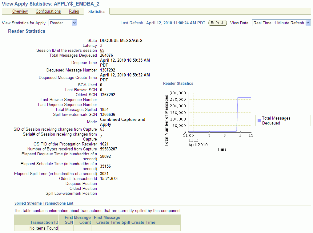

Viewing Statistics for an Apply Process
You can use Enterprise Manager to view statistics for an apply process. The statistics include the number of messages in the apply process's queue, the number of messages applied by the apply process, and other statistics relating to the apply process.
To view statistics for an apply process in Enterprise Manager:
  7. Click Go to open the View Apply Statistics page.
The View Apply Statistics page includes the following subpages:
  • The Queue subpage shows the number of messages over the past several hours in both the persistent queue portion and the buffered queue portion of the apply process's queue. If the apply process applies changes captured by a synchronous capture, then analyze the persistent queue statistics. If the apply process applies changes captured by a capture process, then analyze the buffered queue statistics.
  • The Reader subpage shows statistics for the reader server. The reader server dequeues messages from the apply process's queue and assembles them into separate transactions.
  • The Coordinator subpage shows statistics for the coordinator process. The coordinator process gets transactions from the reader server and passes them to apply servers.
  • The Server subpage shows statistics for the apply servers. The apply servers apply changes to database objects or pass the changes to apply handlers. To view details about a specific apply server, select it and click View Details.
Description of tdpii_apply_co_stats.gif follows
You can also query the following dynamic performance views for buffered queue statistics and apply process statistics:

  5. Perform one of the following actions:
    • To view the active apply process transactions, click the number link in the Current Transactions Active field for the apply process.
      The Active Streams Transactions List section on the View Apply Statistics page displays the active apply process transactions.
      Description of tdpii_active_app_trans.gif follows
    • To view the spilled apply process transactions, click the number link in the Current Transactions Spilled field for the apply process.
      The Spilled Streams Transactions List section on the View Apply Statistics page displays the spilled apply process transactions.
      Description of tdpii_spilled_app_trans.gif follows

Viewing Buffered Queue Statistics
You can use Enterprise Manager to view statistics for a buffered queue that is used by a capture process, propagation, or apply process in your replication environment. In an Oracle Streams replication environment that uses capture processes to capture changes, each capture process enqueues changes into the buffered queue portion of its queue. The changes remain in buffered queues as they are propagated from one queue to another, and apply processes dequeue the changes from a buffered queue.
To view buffered queue statistics:
  3. Click Data Movement to open the Data Movement subpage.
  4. Click Manage Advanced Queues in the Streams section.
    The Manage Advanced Queues page appears.
  5. Select the queue to monitor. If necessary, use the search tool to find the queue, and then select it.
  6. Select Queue Statistics in the Actions list.
  7. Click Go to open the Queue Statistics page.
  8. Click Buffered Queue Statistics to open the Buffered Queue Statistics subpage.
    Description of tdpii_buf_q_stats.gif follows
This Buffered Queue Statistics subpage includes the following information about the buffered queue portion of the selected queue:
  • Information about the number of changes in the queue and the number of changes that have spilled from memory onto disk.
  • The number of changes enqueued by local capture processes. When the capture process is local, the Sender Queue field is empty.
  • The number of changes captured by remote capture processes at a different database and sent to the buffered queue. When a capture process is remote, the Sender Queue field contains the queue and database from which the changes were sent.
  • The number of changes dequeued by local apply processes from the buffered queue.
  • The number of changes sent by propagations from the buffered queue to a different queue.

Apply Aborts Alert
This alert indicates a critical error. The apply process stops, and the messages that are normally dequeued by the apply process remain in the apply process's queue. Replication that depends on the apply process also stops. Eventually, the apply process's queue can grow too large, and messages can spill to disk. Other queues that send messages to the apply process's queue might also grow and spill messages to disk. When messages spill to disk, it degrades Oracle Streams performance.
Response
Obtain the exact error message in one of the following ways:
Take the appropriate action for the error. If the error is an ORA-26714 error, then consider setting the DISABLE_ON_ERROR apply process parameter to N to avoid aborting on future user errors. See "Setting an Apply Process Parameter" for instructions.
After taking the appropriate action, restart the apply process in one of the following ways:
    Description of tdpii_strms_ap_error.gif follows

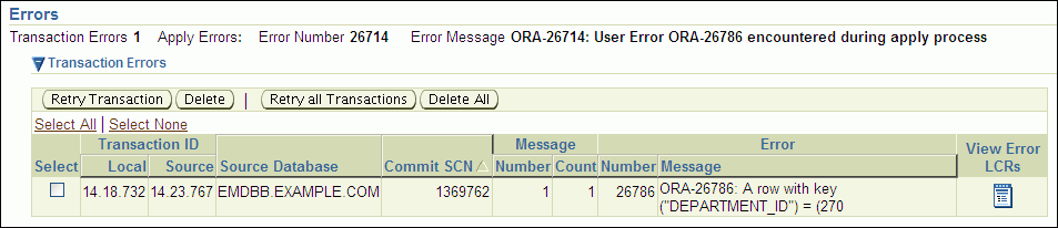

    When an apply process has one or more errors, the Status icon changes to include a warning symbol. Also, an apply error might cause an apply process to abort. When an apply process aborts, the status of the apply process is ABORTED.
  5. Select the apply process with error transactions in the list of components. If necessary, use the search tool to find the apply process, and then select it.
  6. Select View Errors in Action.
    The errors appear in the Errors section, under Transaction Errors.
    Description of tdpii_apply_errors.gif follows

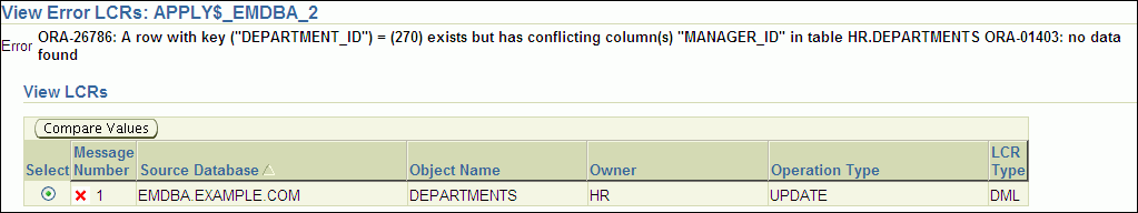

    You can view detailed information about an error by clicking the icon in the View Error LCRs field for the error transaction. The detailed information appears on the View Error LCRs page and includes each change in the transaction.
    Description of tdpii_view_error_lcrs.gif follows

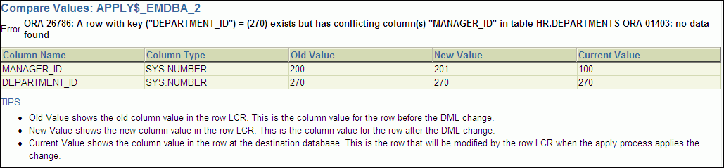

    To drill down further, select a row change and click Compare Values. The Compare Values page appears and compares the row change with the data in the table to which the change should be applied.
    Description of tdpii_compare_error_values.gif follows
