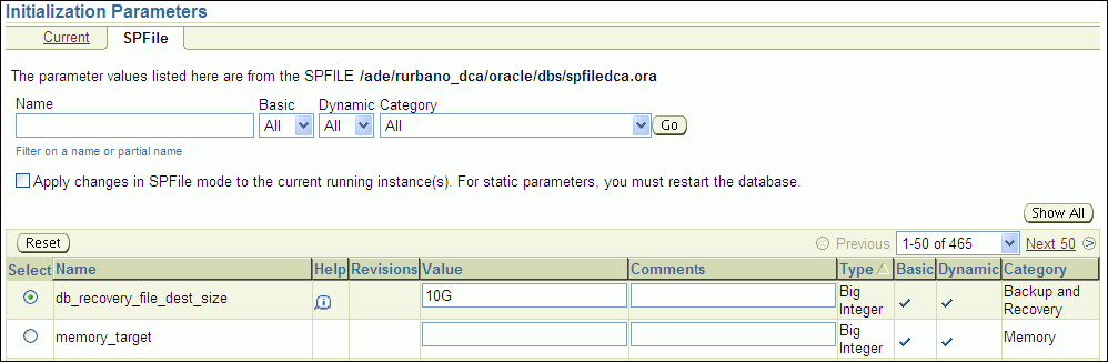

To set the GLOBAL_NAMES initialization parameter to TRUE at a database:
  1. Log in to Enterprise Manager as an administrative user who can change initialization parameters. For example, you can log in as a user with SYSDBA privilege.
  2. Go to the Database Home page for the database instance.
  3. Click Server to open the Server subpage.
  4. Click Initialization Parameters in the Database Configuration section.
  5. If you are using a server parameter file, then click SPFile. Otherwise, proceed to the next step.
  6. On the Initialization Parameters page, enter GLOBAL_NAMES in the search tool.
    Description of tdpii_init_params.gif follows
  7. Click Go.
  8. Set the GLOBAL_NAMES initialization parameter to TRUE.
  9. Click Apply to save your changes.
    Ensure that you set the parameter permanently in either the server parameter file or in your initialization parameter file.
  10. Complete Steps 1 through 9 for each database in your distributed environment. By default, the GLOBAL_NAMES initialization parameter is set to FALSE. Therefore, it must be set to TRUE explicitly at each database.

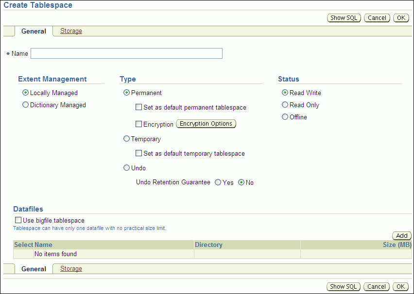

  5. On the Tablespaces page, click Create.
    The Create Tablespace page appears, showing the General subpage.
    Description of tdpii_create_tbs.gif follows
  6. Enter streams_tbs in the Name field.

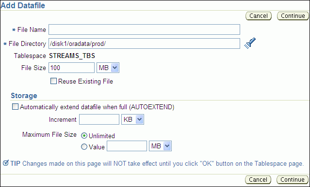

  7. Click Add in the Datafiles section to open the Add Datafile page.
    Description of tdpii_add_datafile.gif follows
  8. Enter streams_tbs.dbf in the File Name field.
  9. Check the directory in the File Directory field and change it if necessary.
  10. Change the size in the File Size field to 25 and ensure that the list is set to MB.
  11. Select Automatically extend datafile when full (AUTOEXTEND) in the Storage section.
  12. Enter 5 in the Increment field and set the list to MB.
  13. Set the maximum file size in the Maximum File Size field. Typically, it is best to leave it set to Unlimited.
  14. Click Continue.
  15. On the Create Tablespace page, click OK.
  16. Complete the steps in "Tutorial: Configuring an Oracle Streams Administrator" to finish creating the Oracle Streams administrator.
You can also use the CREATE TABLESPACE SQL statement to create a tablespace.

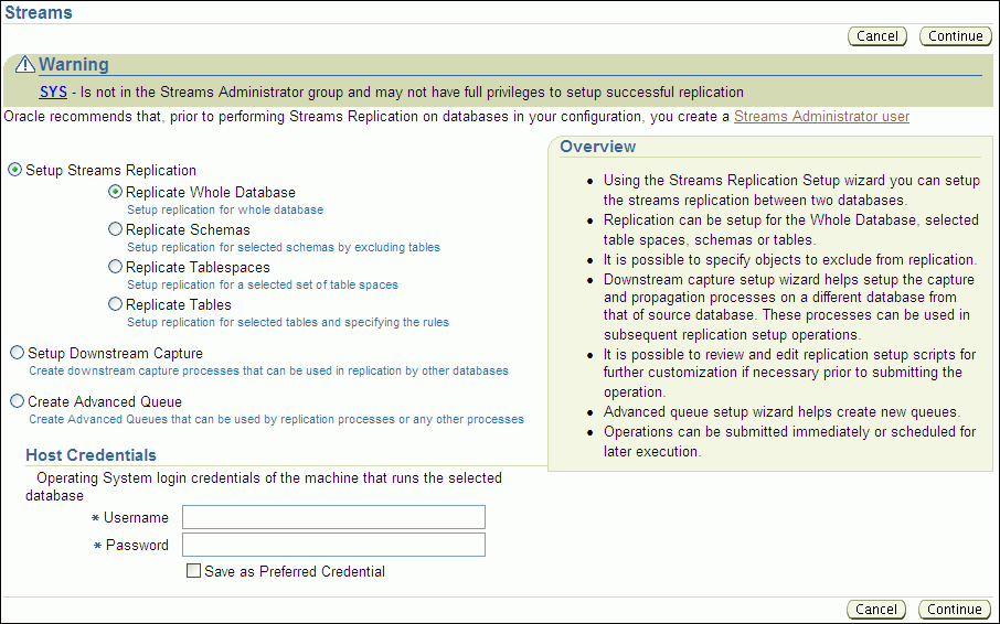

  4. Click Setup in the Streams section.
    The Streams page appears, showing the setup options.
    Description of tdpii_setup.gif follows

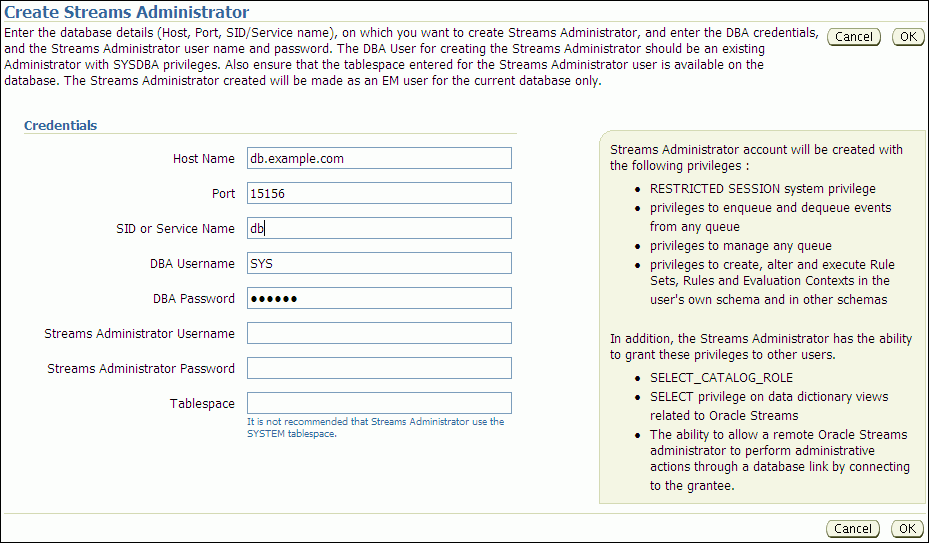

  5. Click Streams Administrator user to open the Create Streams Administrator page.
    Description of tdpii_create_strms_admin.gif follows
  6. Complete the fields in the Credentials section:
    • In the Host Name field, enter the name of the host on which the database is running.
    • In the Port field, enter the port number for the database listener.
    • In the SID or Service Name field, enter the Oracle System Identifier (SID) or service name of the database.
    • In the DBA Username field, enter the username of an administrative user that can create users and grant privileges.
    • In the DBA Password field, enter the password for the DBA user.
    • In the Streams Administrator Username field, enter the username of the Oracle Streams administrator.
    • In the Streams Administrator Password field, enter the password for the new Oracle Streams administrator.
    • In the Tablespace field, enter streams_tbs. This tablespace was created in "Tutorial: Creating the Tablespace for the Oracle Streams Administrator".
    You can identify the current database or a different database in the Host Name, Port, and SID or Service Name fields. The Oracle Streams administrator is created on the database you identify in these fields.
  7. Click OK to finish configuring the Oracle Streams administrator.

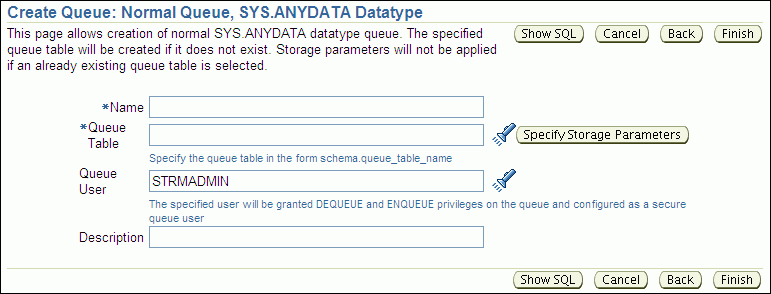

To create an ANYDATA queue and its associated queue table:
  1. In Oracle Enterprise Manager, log in to the database as the Oracle Streams administrator.
  2. Go to the Database Home page.
  3. Click Data Movement to open the Data Movement subpage.
  4. Click Manage Advanced Queues in the Streams section.
  5. On the Manage Advanced Queues page, click Create to open the Create Queue: Queue Type page.
    Description of tdpii_create_queue_type.gif follows
  6. Select Normal Queue, SYS.ANYDATA Datatype.
    A queue of the ANYDATA data type enables you to store messages of almost any type in a single queue.
  7. Click Continue to open the Create Queue: Normal Queue, SYS.ANYDATA Datatype page.
    Description of tdpii_create_queue.gif follows
  8. Enter the name of the queue in the Name field. A typical queue name used in Oracle Streams environments is streams_queue, but you can enter a different name.
  9. Enter the name of the queue table owner and the queue table name in the Queue Table field. Typically, the Oracle Streams administrator owns Oracle Streams queues, and a typical queue table name is streams_queue_table. Therefore, you can enter strmadmin.streams_queue_table, or you can enter a different owner and name.
  10. Ensure that the name of the Oracle Streams administrator is entered in the Queue User field.
  11. Optionally enter a description for the queue in the Description field.
  12. Click Finish to create the queue table and the queue.
You can also use the DBMS_STREAMS_ADM.SET_UP_QUEUE procedure to create an ANYDATA queue.
