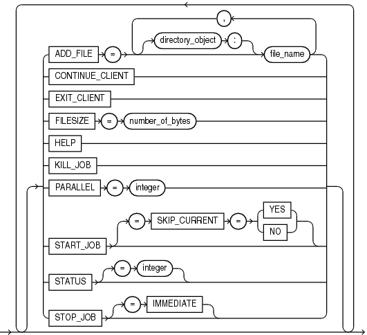

  • Interactive-Command Interface: Stops logging to the terminal and displays the Export prompt, from which you can enter various commands, some of which are specific to interactive-command mode. This mode is enabled by pressing Ctrl+C during an export operation started with the command-line interface or the parameter file interface. Interactive-command mode is also enabled when you attach to an executing or stopped job.
    For a complete description of the commands available in interactive-command mode, see "Commands Available in Export's Interactive-Command Mode".

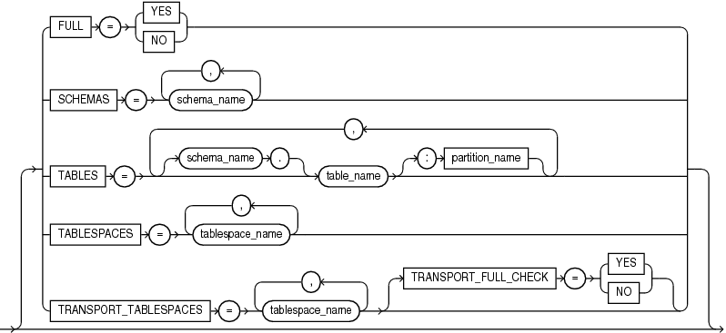

Export provides different modes for unloading different portions of the database. The mode is specified on the command line, using the appropriate parameter. The available modes are described in the following sections:
Several system schemas cannot be exported because they are not user schemas; they contain Oracle-managed data and metadata. Examples of system schemas that are not exported include SYS, ORDSYS, and MDSYS.
Full Export Mode
A full export is specified using the FULL parameter. In a full database export, the entire database is unloaded. This mode requires that you have the DATAPUMP_EXP_FULL_DATABASE role.
See Also:
"FULL" for a description of the Export FULL parameter
Schema Mode
A schema export is specified using the SCHEMAS parameter. This is the default export mode. If you have the DATAPUMP_EXP_FULL_DATABASE role, then you can specify a list of schemas, optionally including the schema definitions themselves and also system privilege grants to those schemas. If you do not have the DATAPUMP_EXP_FULL_DATABASE role, then you can export only your own schema.
The SYS schema cannot be used as a source schema for export jobs.
Cross-schema references are not exported unless the referenced schema is also specified in the list of schemas to be exported. For example, a trigger defined on a table within one of the specified schemas, but that resides in a schema not explicitly specified, is not exported. This is also true for external type definitions upon which tables in the specified schemas depend. In such a case, it is expected that the type definitions already exist in the target instance at import time.
See Also:
"SCHEMAS" for a description of the Export SCHEMAS parameter
Table Mode
A table mode export is specified using the TABLES parameter. In table mode, only a specified set of tables, partitions, and their dependent objects are unloaded.
If you specify the TRANSPORTABLE=ALWAYS parameter with the TABLES parameter, then only object metadata is unloaded. To move the actual data, you copy the data files to the target database. This results in quicker export times. If you are moving data files between releases or platforms, then the data files may need to be processed by Oracle Recovery Manager (RMAN).
See Also:
Oracle Database Backup and Recovery User's Guide for more information on transporting data across platforms
You must have the DATAPUMP_EXP_FULL_DATABASE role to specify tables that are not in your own schema. Note that type definitions for columns are not exported in table mode. It is expected that the type definitions already exist in the target instance at import time. Also, as in schema exports, cross-schema references are not exported.
See Also:
  • "TABLES" for a description of the Export TABLES parameter
  • "TRANSPORTABLE" for a description of the Export TRANSPORTABLE parameter
Tablespace Mode
A tablespace export is specified using the TABLESPACES parameter. In tablespace mode, only the tables contained in a specified set of tablespaces are unloaded. If a table is unloaded, then its dependent objects are also unloaded. Both object metadata and data are unloaded. In tablespace mode, if any part of a table resides in the specified set, then that table and all of its dependent objects are exported. Privileged users get all tables. Unprivileged users get only the tables in their own schemas.

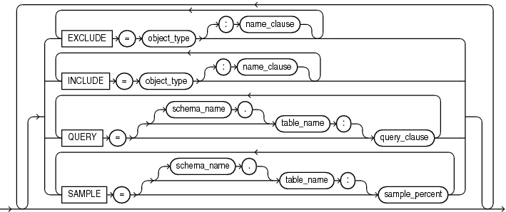

Metadata Filters
Metadata filtering is implemented through the EXCLUDE and INCLUDE parameters. The EXCLUDE and INCLUDE parameters are mutually exclusive.
Metadata filters identify a set of objects to be included or excluded from an Export or Import operation. For example, you could request a full export, but without Package Specifications or Package Bodies.
To use filters correctly and to get the results you expect, remember that dependent objects of an identified object are processed along with the identified object. For example, if a filter specifies that an index is to be included in an operation, then statistics from that index will also be included. Likewise, if a table is excluded by a filter, then indexes, constraints, grants, and triggers upon the table will also be excluded by the filter.
If multiple filters are specified for an object type, then an implicit AND operation is applied to them. That is, objects pertaining to the job must pass all of the filters applied to their object types.
The same metadata filter name can be specified multiple times within a job.

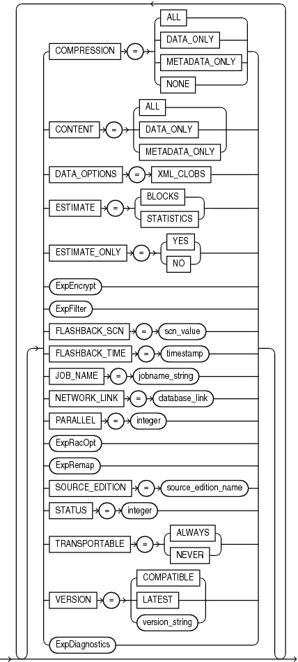

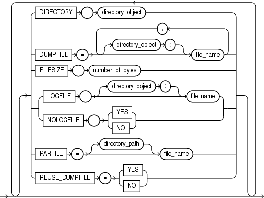

Syntax diagrams of these parameters are provided in "Syntax Diagrams for Data Pump Export".
Unless specifically noted, these parameters can also be specified in a parameter file.

COMPRESSION
Default: METADATA_ONLY
Purpose
Specifies which data to compress before writing to the dump file set.
Syntax and Description
COMPRESSION=[ALL | DATA_ONLY | METADATA_ONLY | NONE]
  • ALL enables compression for the entire export operation. The ALL option requires that the Oracle Advanced Compression option be enabled.
  • DATA_ONLY results in all data being written to the dump file in compressed format. The DATA_ONLY option requires that the Oracle Advanced Compression option be enabled.
  • METADATA_ONLY results in all metadata being written to the dump file in compressed format. This is the default.
  • NONE disables compression for the entire export operation.
See Also:
Oracle Database Licensing Information for information about licensing requirements for the Oracle Advanced Compression option
Restrictions
  • To make full use of all these compression options, the COMPATIBLE initialization parameter must be set to at least 11.0.0.
  • The METADATA_ONLY option can be used even if the COMPATIBLE initialization parameter is set to 10.2.
  • Compression of data using ALL or DATA_ONLY is valid only in the Enterprise Edition of Oracle Database 11g and also requires that the Oracle Advanced Compression option be enabled.
Example
The following is an example of using the COMPRESSION parameter:
> expdp hr DIRECTORY=dpump_dir1 DUMPFILE=hr_comp.dmp COMPRESSION=METADATA_ONLY
This command will execute a schema-mode export that will compress all metadata before writing it out to the dump file, hr_comp.dmp. It defaults to a schema-mode export because no export mode is specified.
CONTENT
Default: ALL
Purpose
Enables you to filter what Export unloads: data only, metadata only, or both.
CONTENT=[ALL | DATA_ONLY | METADATA_ONLY]
  • ALL unloads both data and metadata. This is the default.
  • DATA_ONLY unloads only table row data; no database object definitions are unloaded.
  • METADATA_ONLY unloads only database object definitions; no table row data is unloaded. Be aware that if you specify CONTENT=METADATA_ONLY, then when the dump file is subsequently imported, any index or table statistics imported from the dump file will be locked after the import.
Restrictions
  • The CONTENT=METADATA_ONLY parameter cannot be used with the TRANSPORT_TABLESPACES (transportable-tablespace mode) parameter or with the QUERY parameter.
Example
The following is an example of using the CONTENT parameter:
> expdp hr DIRECTORY=dpump_dir1 DUMPFILE=hr.dmp CONTENT=METADATA_ONLY
This command will execute a schema-mode export that will unload only the metadata associated with the hr schema. It defaults to a schema-mode export of the hr schema because no export mode is specified.
DATA_OPTIONS
Default: There is no default. If this parameter is not used, then the special data handling options it provides simply do not take effect.
Purpose
The DATA_OPTIONS parameter designates how certain types of data should be handled during export operations.
DATA_OPTIONS=XML_CLOBS
The XML_CLOBS option specifies that XMLType columns are to be exported in uncompressed CLOB format regardless of the XMLType storage format that was defined for them.
If a table has XMLType columns stored only as CLOBs, then it is not necessary to specify the XML_CLOBS option because Data Pump automatically exports them in CLOB format.If a table has XMLType columns stored as any combination of object-relational (schema-based), binary, or CLOB formats, then Data Pump exports them in compressed format, by default. This is the preferred method. However, if you need to export the data in uncompressed CLOB format, you can use the XML_CLOBS option to override the default.
See Also:
Oracle XML DB Developer's Guide for information specific to exporting and importing XMLType tables
Restrictions
  • Using the XML_CLOBS option requires that the same XML schema be used at both export and import time.
  • The Export DATA_OPTIONS parameter requires the job version to be set at 11.0.0 or higher. See "VERSION".
Example
This example shows an export operation in which any XMLType columns in the hr.xdb_tab1 table are exported in uncompressed CLOB format regardless of the XMLType storage format that was defined for them.
> expdp hr TABLES=hr.xdb_tab1 DIRECTORY=dpump_dir1 DUMPFILE=hr_xml.dmp
VERSION=11.2 DATA_OPTIONS=XML_CLOBS
DIRECTORY
Default: DATA_PUMP_DIR
Purpose
Specifies the default location to which Export can write the dump file set and the log file.
DIRECTORY=directory_object
The directory_object is the name of a database directory object (not the file path of an actual directory). Upon installation, privileged users have access to a default directory object named DATA_PUMP_DIR. Users with access to the default DATA_PUMP_DIR directory object do not need to use the DIRECTORY parameter at all.
A directory object specified on the DUMPFILE or LOGFILE parameter overrides any directory object that you specify for the DIRECTORY parameter.
Example
The following is an example of using the DIRECTORY parameter:
> expdp hr DIRECTORY=dpump_dir1 DUMPFILE=employees.dmp CONTENT=METADATA_ONLY
The dump file, employees.dmp, will be written to the path that is associated with the directory object dpump_dir1.
See Also:
DUMPFILE
Default: expdat.dmp
Purpose
Specifies the names, and optionally, the directory objects of dump files for an export job.
DUMPFILE=[directory_object:]file_name [, ...]
The directory_object is optional if one has already been established by the DIRECTORY parameter. If you supply a value here, then it must be a directory object that already exists and that you have access to. A database directory object that is specified as part of the DUMPFILE parameter overrides a value specified by the DIRECTORY parameter or by the default directory object.
You can supply multiple file_name specifications as a comma-delimited list or in separate DUMPFILE parameter specifications. If no extension is given for the file name, then Export uses the default file extension of .dmp. The file names can contain a substitution variable (%U), which implies that multiple files may be generated. The substitution variable is expanded in the resulting file names into a 2-digit, fixed-width, incrementing integer starting at 01 and ending at 99. If a file specification contains two substitution variables, both are incremented at the same time. For example, exp%Uaa%U.dmp would resolve to exp01aa01.dmp, exp02aa02.dmp, and so forth.
If the FILESIZE parameter is specified, then each dump file will have a maximum of that size and be nonextensible. If more space is required for the dump file set and a template with a substitution variable (%U) was supplied, then a new dump file is automatically created of the size specified by the FILESIZE parameter, if there is room on the device.
As each file specification or file template containing a substitution variable is defined, it is instantiated into one fully qualified file name and Export attempts to create it. The file specifications are processed in the order in which they are specified. If the job needs extra files because the maximum file size is reached, or to keep parallel workers active, then additional files are created if file templates with substitution variables were specified.
Although it is possible to specify multiple files using the DUMPFILE parameter, the export job may only require a subset of those files to hold the exported data. The dump file set displayed at the end of the export job shows exactly which files were used. It is this list of files that is required to perform an import operation using this dump file set. Any files that were not used can be discarded.
Restrictions
  • Any resulting dump file names that match preexisting dump file names will generate an error and the preexisting dump files will not be overwritten. You can override this behavior by specifying the Export parameter REUSE_DUMPFILES=YES.
Example
The following is an example of using the DUMPFILE parameter:
> expdp hr SCHEMAS=hr DIRECTORY=dpump_dir1 DUMPFILE=dpump_dir2:exp1.dmp,
 exp2%U.dmp PARALLEL=3
The dump file, exp1.dmp, will be written to the path associated with the directory object dpump_dir2 because dpump_dir2 was specified as part of the dump file name, and therefore overrides the directory object specified with the DIRECTORY parameter. Because all three parallel processes will be given work to perform during this job, dump files named exp201.dmp and exp202.dmp will be created based on the specified substitution variable exp2%U.dmp. Because no directory is specified for them, they will be written to the path associated with the directory object, dpump_dir1, that was specified with the DIRECTORY parameter.
See Also:

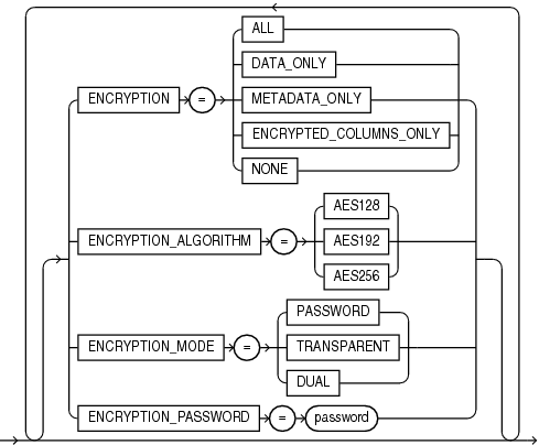

ENCRYPTION
Default: The default value depends upon the combination of encryption-related parameters that are used. To enable encryption, either the ENCRYPTION or ENCRYPTION_PASSWORD parameter, or both, must be specified.
If only the ENCRYPTION_PASSWORD parameter is specified, then the ENCRYPTION parameter defaults to ALL.
If only the ENCRYPTION parameter is specified and the Oracle encryption wallet is open, then the default mode is TRANSPARENT. If only the ENCRYPTION parameter is specified and the wallet is closed, then an error is returned.
If neither ENCRYPTION nor ENCRYPTION_PASSWORD is specified, then ENCRYPTION defaults to NONE.
Purpose
Specifies whether to encrypt data before writing it to the dump file set.
ENCRYPTION = [ALL | DATA_ONLY | ENCRYPTED_COLUMNS_ONLY | METADATA_ONLY | NONE]
ALL enables encryption for all data and metadata in the export operation.
DATA_ONLY specifies that only data is written to the dump file set in encrypted format.
ENCRYPTED_COLUMNS_ONLY specifies that only encrypted columns are written to the dump file set in encrypted format. To use this option, you must have Oracle Advanced Security transparent data encryption enabled. See Oracle Database Advanced Security Administrator's Guide for more information about transparent data encryption.
METADATA_ONLY specifies that only metadata is written to the dump file set in encrypted format.
NONE specifies that no data is written to the dump file set in encrypted format.
If the data being exported includes SecureFiles that you want to be encrypted, then you must specify ENCRYPTION=ALL to encrypt the entire dump file set. Encryption of the entire dump file set is the only way to achieve encryption security for SecureFiles during a Data Pump export operation. For more information about SecureFiles, see Oracle Database SecureFiles and Large Objects Developer's Guide.
Restrictions
  • To specify the ALL, DATA_ONLY, or METADATA_ONLY options, the COMPATIBLE initialization parameter must be set to at least 11.0.0.
  • This parameter is valid only in the Enterprise Edition of Oracle Database 11g.
  • Data Pump encryption features require that the Oracle Advanced Security option be enabled. See Oracle Database Advanced Security Administrator's Guide for information about licensing requirements for the Oracle Advanced Security option.
Example
The following example performs an export operation in which only data is encrypted in the dump file:
> expdp hr DIRECTORY=dpump_dir1 DUMPFILE=hr_enc.dmp JOB_NAME=enc1
ENCRYPTION=data_only ENCRYPTION_PASSWORD=foobar
ENCRYPTION_ALGORITHM
Default: AES128
Purpose
Specifies which cryptographic algorithm should be used to perform the encryption.
ENCRYPTION_ALGORITHM = [AES128 | AES192 | AES256]
See Oracle Database Advanced Security Administrator's Guide for information about encryption algorithms.
Restrictions
  • To use this encryption feature, the COMPATIBLE initialization parameter must be set to at least 11.0.0.
  • The ENCRYPTION_ALGORITHM parameter requires that you also specify either the ENCRYPTION or ENCRYPTION_PASSWORD parameter; otherwise an error is returned.
Example
> expdp hr DIRECTORY=dpump_dir1 DUMPFILE=hr_enc3.dmp
ENCRYPTION_PASSWORD=foobar ENCRYPTION_ALGORITHM=AES128
ENCRYPTION_MODE
Default: The default mode depends on which other encryption-related parameters are used. If only the ENCRYPTION parameter is specified and the Oracle encryption wallet is open, then the default mode is TRANSPARENT. If only the ENCRYPTION parameter is specified and the wallet is closed, then an error is returned.
If the ENCRYPTION_PASSWORD parameter is specified and the wallet is open, then the default is DUAL. If the ENCRYPTION_PASSWORD parameter is specified and the wallet is closed, then the default is PASSWORD.
Purpose
Specifies the type of security to use when encryption and decryption are performed.
ENCRYPTION_MODE = [DUAL | PASSWORD | TRANSPARENT]
DUAL mode creates a dump file set that can later be imported either transparently or by specifying a password that was used when the dual-mode encrypted dump file set was created. When you later import the dump file set created in DUAL mode, you can use either the wallet or the password that was specified with the ENCRYPTION_PASSWORD parameter. DUAL mode is best suited for cases in which the dump file set will be imported on-site using the wallet, but which may also need to be imported offsite where the wallet is not available.
PASSWORD mode requires that you provide a password when creating encrypted dump file sets. You will need to provide the same password when you import the dump file set. PASSWORD mode requires that you also specify the ENCRYPTION_PASSWORD parameter. The PASSWORD mode is best suited for cases in which the dump file set will be imported into a different or remote database, but which must remain secure in transit.
TRANSPARENT mode allows an encrypted dump file set to be created without any intervention from a database administrator (DBA), provided the required wallet is available. Therefore, the ENCRYPTION_PASSWORD parameter is not required, and will in fact, cause an error if it is used in TRANSPARENT mode. This encryption mode is best suited for cases in which the dump file set will be imported into the same database from which it was exported.
Restrictions
  • To use DUAL or TRANSPARENT mode, the COMPATIBLE initialization parameter must be set to at least 11.0.0.
  • When you use the ENCRYPTION_MODE parameter, you must also use either the ENCRYPTION or ENCRYPTION_PASSWORD parameter. Otherwise, an error is returned.
  • When you use the ENCRYPTION=ENCRYPTED_COLUMNS_ONLY, you cannot use the ENCRYPTION_MODE parameter. Otherwise, an error is returned.
Example
> expdp hr DIRECTORY=dpump_dir1 DUMPFILE=hr_enc4.dmp
ENCRYPTION=all ENCRYPTION_PASSWORD=secretwords
ENCRYPTION_ALGORITHM=AES256 ENCRYPTION_MODE=DUAL
ENCRYPTION_PASSWORD
Default: There is no default; the value is user-provided.
Purpose
Specifies a password for encrypting encrypted column data, metadata, or table data in the export dumpfile. This prevents unauthorized access to an encrypted dump file set.
Data Pump encryption functionality changed as of Oracle Database 11g release 1 (11.1). Before release 11.1, the ENCRYPTION_PASSWORD parameter applied only to encrypted columns. However, as of release 11.1, the new ENCRYPTION parameter provides options for encrypting other types of data. This means that if you now specify ENCRYPTION_PASSWORD without also specifying ENCRYPTION and a specific option, then all data written to the dump file will be encrypted (equivalent to specifying ENCRYPTION=ALL). If you want to re-encrypt only encrypted columns, then you must now specify ENCRYPTION=ENCRYPTED_COLUMNS_ONLY in addition to ENCRYPTION_PASSWORD.
ENCRYPTION_PASSWORD = password
Thee password value that is supplied specifies a key for re-encrypting encrypted table columns, metadata, or table data so that they are not written as clear text in the dump file set. If the export operation involves encrypted table columns, but an encryption password is not supplied, then the encrypted columns will be written to the dump file set as clear text and a warning will be issued.
For export operations, this parameter is required if the ENCRYPTION_MODE parameter is set to either PASSWORD or DUAL.
There is no connection or dependency between the key specified with the Data Pump ENCRYPTION_PASSWORD parameter and the key specified with the ENCRYPT keyword when the table with encrypted columns was initially created. For example, suppose a table is created as follows, with an encrypted column whose key is xyz:
CREATE TABLE emp (col1 VARCHAR2(256) ENCRYPT IDENTIFIED BY "xyz");
When you export the emp table, you can supply any arbitrary value for ENCRYPTION_PASSWORD. It does not have to be xyz.
Restrictions
  • If ENCRYPTION_PASSWORD is specified but ENCRYPTION_MODE is not specified, then it is not necessary to have Oracle Advanced Security transparent data encryption enabled since ENCRYPTION_MODE will default to PASSWORD.
  • The ENCRYPTION_PASSWORD parameter is not valid if the requested encryption mode is TRANSPARENT.
  • To use the ENCRYPTION_PASSWORD parameter if ENCRYPTION_MODE is set to DUAL, you must have Oracle Advanced Security transparent data encryption enabled. See Oracle Database Advanced Security Administrator's Guide for more information about transparent data encryption.
  • For network exports, the ENCRYPTION_PASSWORD parameter in conjunction with ENCRYPTION=ENCRYPTED_COLUMNS_ONLY is not supported with user-defined external tables that have encrypted columns. The table will be skipped and an error message will be displayed, but the job will continue.
  • Encryption attributes for all columns must match between the exported table definition and the target table. For example, suppose you have a table, EMP, and one of its columns is named EMPNO. Both of the following situations would result in an error because the encryption attribute for the EMP column in the source table would not match the encryption attribute for the EMP column in the target table:
    • The EMP table is exported with the EMPNO column being encrypted, but before importing the table you remove the encryption attribute from the EMPNO column.
    • The EMP table is exported without the EMPNO column being encrypted, but before importing the table you enable encryption on the EMPNO column.
Example
In the following example, an encryption password, 123456, is assigned to the dump file, dpcd2be1.dmp.
expdp hr TABLES=employee_s_encrypt DIRECTORY=dpump_dir1
DUMPFILE=dpcd2be1.dmp ENCRYPTION=ENCRYPTED_COLUMNS_ONLY
ENCRYPTION_PASSWORD=123456
Encrypted columns in the employee_s_encrypt table, will not be written as clear text in the dpcd2be1.dmp dump file. Note that to subsequently import the dpcd2be1.dmp file created by this example, you will need to supply the same encryption password. (See "ENCRYPTION_PASSWORD" for an example of an import operation using the ENCRYPTION_PASSWORD parameter.)

EXCLUDE
Purpose
Enables you to filter the metadata that is exported by specifying objects and object types to be excluded from the export operation.
EXCLUDE=object_type[:name_clause] [, ...]
The object_type specifies the type of object to be excluded. To see a list of valid values for object_type, query the following views: DATABASE_EXPORT_OBJECTS for full mode, SCHEMA_EXPORT_OBJECTS for schema mode, and TABLE_EXPORT_OBJECTS for table and tablespace mode. The values listed in the OBJECT_PATH column are the valid object types.
All object types for the given mode of export will be included in the export except those specified in an EXCLUDE statement. If an object is excluded, then all of its dependent objects are also excluded. For example, excluding a table will also exclude all indexes and triggers on the table.
The name_clause is optional. It allows selection of specific objects within an object type. It is a SQL expression used as a filter on the type's object names. It consists of a SQL operator and the values against which the object names of the specified type are to be compared. The name_clause applies only to object types whose instances have names (for example, it is applicable to TABLE, but not to GRANT). It must be separated from the object type with a colon and enclosed in double quotation marks, because single quotation marks are required to delimit the name strings. For example, you could set EXCLUDE=INDEX:"LIKE 'EMP%'" to exclude all indexes whose names start with EMP.
The name that you supply for the name_clause must exactly match, including upper and lower casing, an existing object in the database. For example, if the name_clause you supply is for a table named EMPLOYEES, then there must be an existing table named EMPLOYEES using all upper case. If the name_clause were supplied as Employees or employees or any other variation, then the table would not be found.
If no name_clause is provided, then all objects of the specified type are excluded.
More than one EXCLUDE statement can be specified.
Depending on your operating system, the use of quotation marks when you specify a value for this parameter may also require that you use escape characters. Oracle recommends that you place this parameter in a parameter file, which can reduce the number of escape characters that might otherwise be needed on the command line.
See Also:
If the object_type you specify is CONSTRAINT, GRANT, or USER, then you should be aware of the effects this will have, as described in the following paragraphs.
Excluding Constraints
The following constraints cannot be explicitly excluded:
  • NOT NULL constraints
  • Constraints needed for the table to be created and loaded successfully; for example, primary key constraints for index-organized tables, or REF SCOPE and WITH ROWID constraints for tables with REF columns
This means that the following EXCLUDE statements will be interpreted as follows:
  • EXCLUDE=CONSTRAINT will exclude all (nonreferential) constraints, except for NOT NULL constraints and any constraints needed for successful table creation and loading.
  • EXCLUDE=REF_CONSTRAINT will exclude referential integrity (foreign key) constraints.
Excluding Grants and Users
Specifying EXCLUDE=GRANT excludes object grants on all object types and system privilege grants.
Specifying EXCLUDE=USER excludes only the definitions of users, not the objects contained within users' schemas.
To exclude a specific user and all objects of that user, specify a command such as the following, where hr is the schema name of the user you want to exclude.
expdp FULL=YES DUMPFILE=expfull.dmp EXCLUDE=SCHEMA:"='HR'"
Note that in this situation, an export mode of FULL is specified. If no mode were specified, then the default mode, SCHEMAS, would be used. This would cause an error because the command would indicate that the schema should be both exported and excluded at the same time.

       WHERE cust_credit_limit > 10000 AND cust_id = c.cust_id)"'
  • The maximum length allowed for a QUERY string is 4000 bytes including quotation marks, which means that the actual maximum length allowed is 3998 bytes.
Example
The following is an example of using the QUERY parameter:
> expdp hr PARFILE=emp_query.par
The contents of the emp_query.par file are as follows:
QUERY=employees:"WHERE department_id > 10 AND salary > 10000"
NOLOGFILE=YES
DUMPFILE=exp1.dmp
This example unloads all tables in the hr schema, but only the rows that fit the query expression. In this case, all rows in all tables (except employees) in the hr schema will be unloaded. For the employees table, only rows that meet the query criteria are unloaded.

SAMPLE
Purpose
Allows you to specify a percentage of the data rows to be sampled and unloaded from the source database.
SAMPLE=[[schema_name.]table_name:]sample_percent
This parameter allows you to export subsets of data by specifying the percentage of data to be sampled and exported. The sample_percent indicates the probability that a row will be selected as part of the sample. It does not mean that the database will retrieve exactly that amount of rows from the table. The value you supply for sample_percent can be anywhere from .000001 up to, but not including, 100.
The sample_percent can be applied to specific tables. In the following example, 50% of the HR.EMPLOYEES table will be exported:
SAMPLE="HR"."EMPLOYEES":50
If you specify a schema, then you must also specify a table. However, you can specify a table without specifying a schema; the current user will be assumed. If no table is specified, then the sample_percent value applies to the entire export job.
Note that you can use this parameter with the Data Pump Import PCTSPACE transform, so that the size of storage allocations matches the sampled data subset. (See "TRANSFORM".)
Restrictions
  • The SAMPLE parameter is not valid for network exports.
Example
In the following example, the value 70 for SAMPLE is applied to the entire export job because no table name is specified.
> expdp hr DIRECTORY=dpump_dir1 DUMPFILE=sample.dmp SAMPLE=70

TABLES
Purpose
Specifies that you want to perform a table-mode export.
TABLES=[schema_name.]table_name[:partition_name] [, ...]
Filtering can restrict what is exported using this mode (see "Filtering During Export Operations"). You can filter the data and metadata that is exported, by specifying a comma-delimited list of tables and partitions or subpartitions. If a partition name is specified, then it must be the name of a partition or subpartition in the associated table. Only the specified set of tables, partitions, and their dependent objects are unloaded.
If an entire partitioned table is exported, then it will be imported in its entirety, as a partitioned table. The only case in which this is not true is if PARTITION_OPTIONS=DEPARTITION is specified during import.
The table name that you specify can be preceded by a qualifying schema name. The schema defaults to that of the current user. To specify a schema other than your own, you must have the DATAPUMP_EXP_FULL_DATABASE role.
Use of the wildcard character, %, to specify table names and partition names is supported.
The following restrictions apply to table names:
  • By default, table names in a database are stored as uppercase. If you have a table name in mixed-case or lowercase, and you want to preserve case-sensitivity for the table name, then you must enclose the name in quotation marks. The name must exactly match the table name stored in the database.
    Some operating systems require that quotation marks on the command line be preceded by an escape character. The following are examples of how case-sensitivity can be preserved in the different Export modes.
    • In command-line mode:
      TABLES='\"Emp\"'
    • In interactive mode:
      Table(T) to be exported: "Exp"
    • In parameter file mode:
      TABLES='"Emp"'
  • Table names specified on the command line cannot include a pound sign (#), unless the table name is enclosed in quotation marks. Similarly, in the parameter file, if a table name includes a pound sign (#), then the Export utility interprets the rest of the line as a comment, unless the table name is enclosed in quotation marks.
    For example, if the parameter file contains the following line, then Export interprets everything on the line after emp# as a comment and does not export the tables dept and mydata:
    TABLES=(emp#, dept, mydata)
    However, if the parameter file contains the following line, then the Export utility exports all three tables because emp# is enclosed in quotation marks:
    TABLES=('"emp#"', dept, mydata)
    Some operating systems require single quotation marks rather than double quotation marks, or the reverse. See your Oracle operating system-specific documentation. Different operating systems also have other restrictions on table naming.
    For example, the UNIX C shell attaches a special meaning to a dollar sign ($) or pound sign (#) (or certain other special characters). You must use escape characters to get such characters in the name past the shell and into Export.
Using the Transportable Option During Table-Mode Export
To use the transportable option during a table-mode export, specify the TRANSPORTABLE=ALWAYS parameter with the TABLES parameter. Metadata for the specified tables, partitions, or subpartitions is exported to the dump file. To move the actual data, you copy the data files to the target database.
If only a subset of a table's partitions are exported and the TRANSPORTABLE=ALWAYS parameter is used, then on import each partition becomes a non-partitioned table.
Restrictions
  • Cross-schema references are not exported. For example, a trigger defined on a table within one of the specified schemas, but that resides in a schema not explicitly specified, is not exported.
  • Types used by the table are not exported in table mode. This means that if you subsequently import the dump file and the type does not already exist in the destination database, then the table creation will fail.
  • The use of synonyms as values for the TABLES parameter is not supported. For example, if the regions table in the hr schema had a synonym of regn, then it would not be valid to use TABLES=regn. An error would be returned.
  • The export of tables that include a wildcard character, %, in the table name is not supported if the table has partitions.
  • The length of the table name list specified for the TABLES parameter is limited to a maximum of 4 MB, unless you are using the NETWORK_LINK parameter to an Oracle Database release 10.2.0.3 or earlier or to a read-only database. In such cases, the limit is 4 KB.
  • You can only specify partitions from one table if TRANSPORTABLE=ALWAYS is also set on the export.
Examples
The following example shows a simple use of the TABLES parameter to export three tables found in the hr schema: employees, jobs, and departments. Because user hr is exporting tables found in the hr schema, the schema name is not needed before the table names.
> expdp hr DIRECTORY=dpump_dir1 DUMPFILE=tables.dmp
TABLES=employees,jobs,departments
The following example assumes that user hr has the DATAPUMP_EXP_FULL_DATABASE role. It shows the use of the TABLES parameter to export partitions.
> expdp hr DIRECTORY=dpump_dir1 DUMPFILE=tables_part.dmp
TABLES=sh.sales:sales_Q1_2008,sh.sales:sales_Q2_2008
This example exports the partitions, sales_Q1_2008 and sales_Q2_2008, from the table sales in the schema sh.
TABLESPACES
Purpose
Specifies a list of tablespace names to be exported in tablespace mode.
TABLESPACES=tablespace_name [, ...]
In tablespace mode, only the tables contained in a specified set of tablespaces are unloaded. If a table is unloaded, then its dependent objects are also unloaded. Both object metadata and data are unloaded. If any part of a table resides in the specified set, then that table and all of its dependent objects are exported. Privileged users get all tables. Unprivileged users get only the tables in their own schemas
Restrictions
  • The length of the tablespace name list specified for the TABLESPACES parameter is limited to a maximum of 4 MB, unless you are using the NETWORK_LINK to an Oracle Database release 10.2.0.3 or earlier or to a read-only database. In such cases, the limit is 4 KB.
Example
The following is an example of using the TABLESPACES parameter. The example assumes that tablespaces tbs_4, tbs_5, and tbs_6 already exist.
> expdp hr DIRECTORY=dpump_dir1 DUMPFILE=tbs.dmp
TABLESPACES=tbs_4, tbs_5, tbs_6
This results in a tablespace export in which tables (and their dependent objects) from the specified tablespaces (tbs_4, tbs_5, and tbs_6) will be unloaded.
TRANSPORT_FULL_CHECK
Default: NO
Purpose
Specifies whether to check for dependencies between those objects inside the transportable set and those outside the transportable set. This parameter is applicable only to a transportable-tablespace mode export.
TRANSPORT_FULL_CHECK=[YES | NO]
If TRANSPORT_FULL_CHECK=YES, then Export verifies that there are no dependencies between those objects inside the transportable set and those outside the transportable set. The check addresses two-way dependencies. For example, if a table is inside the transportable set but its index is not, then a failure is returned and the export operation is terminated. Similarly, a failure is also returned if an index is in the transportable set but the table is not.
If TRANSPORT_FULL_CHECK=NO, then Export verifies only that there are no objects within the transportable set that are dependent on objects outside the transportable set. This check addresses a one-way dependency. For example, a table is not dependent on an index, but an index is dependent on a table, because an index without a table has no meaning. Therefore, if the transportable set contains a table, but not its index, then this check succeeds. However, if the transportable set contains an index, but not the table, then the export operation is terminated.
There are other checks performed as well. For instance, export always verifies that all storage segments of all tables (and their indexes) defined within the tablespace set specified by TRANSPORT_TABLESPACES are actually contained within the tablespace set.
Example
The following is an example of using the TRANSPORT_FULL_CHECK parameter. It assumes that tablespace tbs_1 exists.
> expdp hr DIRECTORY=dpump_dir1 DUMPFILE=tts.dmp
TRANSPORT_TABLESPACES=tbs_1 TRANSPORT_FULL_CHECK=YES LOGFILE=tts.log
This section provides syntax diagrams for Data Pump Export. These diagrams use standard SQL syntax notation. For more information about SQL syntax notation, see Oracle Database SQL Language Reference.
ExpInit
Description of expinit.gif follows

ExpModes
Description of expmodes.gif follows

ExpEncrypt
Description of expencrypt.gif follows
ExpFilter
Description of expfilter.gif follows

ExpFileOpts
Description of expfileopts.gif follows
ExpDynOpts
Description of expdynopts.gif follows
