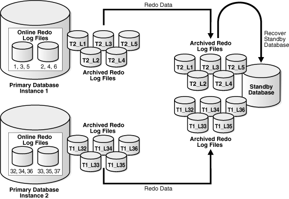

Figure D-1 illustrates an Oracle RAC database with two primary database instances (a multi-instance primary database) transmitting redo data to a single-instance standby database.
Figure D-1 Transmitting Redo Data from a Multi-Instance Primary Database
Description of Figure D-1 follows
Description of "Figure D-1 Transmitting Redo Data from a Multi-Instance Primary Database"
In this case, Instance 1 of the primary database archives redo data to local archived redo log files 1, 2, 3, 4, 5 and transmits the redo data to the standby database destination, while Instance 2 archives redo data to local archived redo log files 32, 33, 34, 35, 36 and transmits the redo data to the same standby database destination. The standby database automatically determines the correct order in which to apply the archived redo log files.
