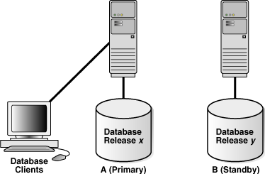

Figure 12-1 shows a Data Guard configuration before the upgrade begins, with the primary and logical standby databases both running the same Oracle Database software release.
Figure 12-1 Data Guard Configuration Before Upgrade
Description of Figure 12-1 follows
Description of "Figure 12-1 Data Guard Configuration Before Upgrade"
During the upgrade process, the Data Guard configuration operates with mixed database releases at several points in this process. Data protection is not available across releases. During these steps, consider having a second standby database in the Data Guard configuration to provide data protection.
The steps and figures describing the upgrade procedure refer to the databases as Database A and Database B rather than as the primary database and standby database. This is because the databases switch roles during the upgrade procedure. Initially, Database A is the primary database and Database B is the logical standby database, as shown in Figure 12-1.

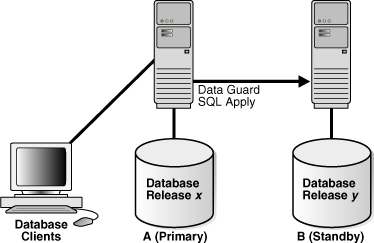

Figure 12-2 shows Database A running release x, and Database B running release y. During the upgrade, redo data accumulates on the primary system.
Figure 12-2 Upgrade the Logical Standby Database Release
Description of Figure 12-2 follows
Description of "Figure 12-2 Upgrade the Logical Standby Database Release"

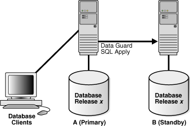

Restart SQL Apply and operate with release x on Database A and release y on Database B. To start SQL Apply, issue the following statement on Database B:
SQL> ALTER DATABASE START LOGICAL STANDBY APPLY IMMEDIATE;
The redo data that was accumulating on the primary system is automatically transmitted and applied on the newly upgraded logical standby database. The Data Guard configuration can run the mixed releases shown in Figure 12-3 for an arbitrary period while you verify that the upgraded Oracle Database software release is running properly in the production environment.
Figure 12-3 Running Mixed Releases
Description of Figure 12-3 follows
Description of "Figure 12-3 Running Mixed Releases"

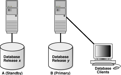

Figure 12-4 shows Database B, the former standby database (running release y), is now the primary database, and Database A, the former primary database (running release x), is now the standby database. The users are connected to Database B.
If Database B can adequately serve as the primary database and your business does not require a logical standby database to support the primary database, then you have completed the rolling upgrade process. Allow users to log in to Database B and begin working there, and discard Database A when it is convenient. Otherwise, continue with step 8.
Figure 12-4 After a Switchover
Description of Figure 12-4 follows
Description of "Figure 12-4 After a Switchover"

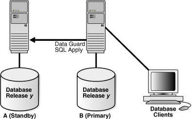

Figure 12-5 shows the system after both databases have been upgraded.
Figure 12-5 Both Databases Upgraded
Description of Figure 12-5 follows
Description of "Figure 12-5 Both Databases Upgraded"
