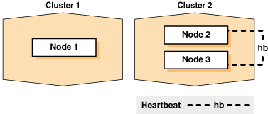

Figure 5-2 Cloning to Add Nodes to a Cluster
Using Figure 5-2 as an example, the following procedure explains how to add nodes to a cluster using cloning. In this procedure, Node 1 is the source node from which you obtain the cloned copy, and Node 2 is the destination node, to which you copy the clone of Node 1:
Prepare Node 2 as described in "Step 1: Prepare the New Cluster Nodes".
Deploy the Oracle Grid Infrastructure home on Node 2, as described in "Step 2: Deploy the Oracle Grid Infrastructure Home on the Destination Nodes".
Run the clone.pl script located in the Grid_home/clone/bin directory on Node 2.
The following example is for Linux or UNIX systems:
$ perl clone.pl ORACLE_HOME=/u01/app/11.2.0/grid ORACLE_HOME_NAME=OraHome1Grid
ORACLE_BASE=/u01/app/oracle -O'"CLUSTER_NODES={node1, node2}"'
