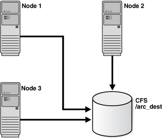

RMAN Archiving Configuration Scenarios
This section describes the archiving scenarios for an Oracle RAC database. The two configuration scenarios in this chapter describe a three-node UNIX cluster for an Oracle RAC database. For both scenarios, the LOG_ARCHIVE_FORMAT that you specify for the instance performing recovery must be the same as the format that you specified for the instances that archived the redo log files.
This section includes the following topics:
Oracle Automatic Storage Management and Cluster File System Archiving Scheme
The preferred configuration for Oracle RAC is to use Oracle Automatic Storage Management (Oracle ASM) for a recovery area using a disk group for your recovery set that is different from the disk group used for your data files. When you use Oracle ASM, it uses an Oracle Managed Files naming format.
Alternatively, you can use a cluster file system archiving scheme. If you use a cluster file system, then each node writes to a single location on the cluster file system when archiving the redo log files. Each node can read the archived redo log files of the other nodes. For example, as shown in Figure 6-1, if Node 1 archives a redo log file to /arc_dest/log_1_100_23452345.arc on the cluster file system, then any other node in the cluster can also read this file.
See Also:
Oracle Database Backup and Recovery User's Guide for more information about managing space in the recovery area and backing up archived redo logs with RMAN
Figure 6-1 Cluster File System Archiving Scheme
Description of Figure 6-1 follows
Description of "Figure 6-1 Cluster File System Archiving Scheme"
The archive log naming format in this example is only for a cluster file system example.
If you do not use a cluster file system, then the archived redo log files cannot be on raw devices. This is because raw devices do not enable sequential writing of consecutive archive log files.
Advantages of the Cluster File System Archiving Scheme
The advantage of this scheme is that none of the nodes uses the network to archive logs. Because the file name written by a node can be read by any node in the cluster, RMAN can back up all logs from any node in the cluster. Backup and restore scripts are simplified because each node has access to all archived redo logs.
Initialization Parameter Settings for the Cluster File System Archiving Scheme
In the cluster file system scheme, each node archives to a directory that is identified with the same name on all instances within the cluster database (/arc_dest, in the following example). To configure this directory, set values for the LOG_ARCH_DEST_1 parameter, as shown in the following example:
*.LOG_ARCHIVE_DEST_1="LOCATION=/arc_dest"
The following list shows archived redo log entry examples that would appear in the RMAN catalog or in the control file based on the previous example. Note that any node can archive logs using any of the threads:
/arc_dest/log_1_999_23452345.arc
/arc_dest/log_1_1000_23435343.arc
/arc_dest/log_1_1001_23452345.arc <- thread 1 archived in node3
/arc_dest/log_3_1563_23452345.arc <- thread 3 archived in node2
/arc_dest/log_2_753_23452345.arc <- thread 2 archived in node1
/arc_dest/log_2_754_23452345.arc
/arc_dest/log_3_1564_23452345.arc
Location of Archived Logs for the Cluster File System Archiving Scheme
Because the file system is shared and because each node is writing its archived redo logs to the /arc_dest directory in the cluster file system, each node can read the logs written by itself and any other node.
