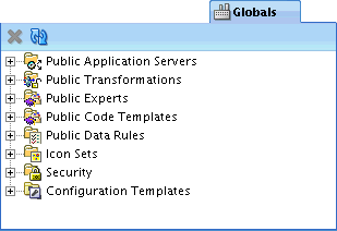

When you log in to the Oracle Warehouse Builder Design Center as the design repository owner, it displays the Globals Navigator.
This illustration is described in the surrounding text.

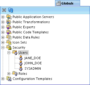

To view default security settings:
  1. In Globals Navigator, expand Security.
  2. Expand Users, and then expand Roles.
    Description of security_01.gif follows
  3. Notice that there are two predefined roles, ADMINISTRATOR and EVERYONE.
  4. The one predefined user is the design repository owner; it is assigned the ADMINISTRATOR role by default.
    To view or edit the details for a user, in the globals Navigator, under Security and then under Users, select that and double-click the user. The Edit User screen appears.

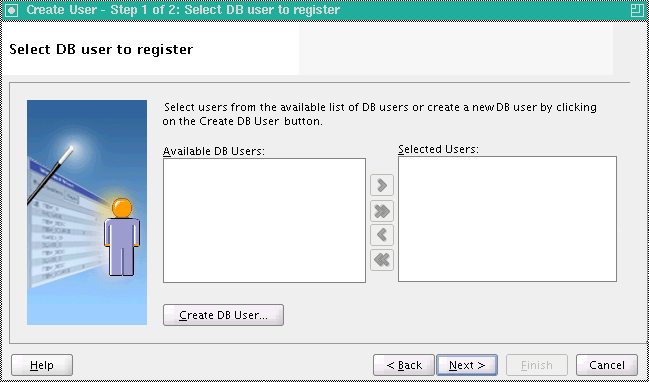

Registering Existing Database Users
This section explains how to register existing database users.
To register existing database users:

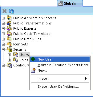

  1. In the Globals Navigator, under Security, right-click Users and select New User.
    Description of new_user_01.gif follows

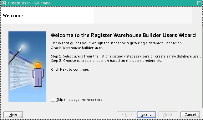

    The Create User: Welcome screen appears.
  2. On the Create User Welcome screen, click Next.
    Description of new_user_02.gif follows

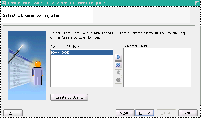

  3. On the Select DB user to register screen, under Available DB Users, select the user or users you want to register, and click the appropriate transfer icon to add the user or users to the Selected Users list.
    Click Next.
    Description of new_user_03.gif follows

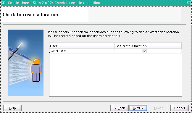

  4. On the Check to create a location screen, check Create option next to the user you are registering.
    Click Next.

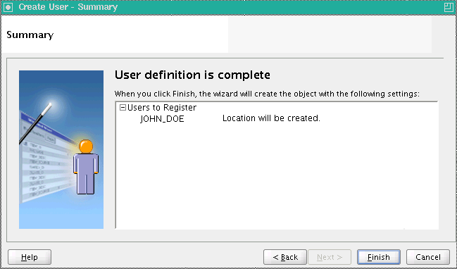

  5. On the Summary screen, review the new user definition.
    Click Finish.

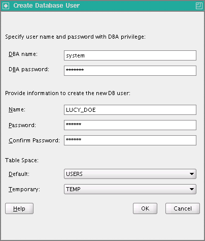

Creating New Oracle Database Users
This section explains how to create new database users. You must have the database system privilege CREATE USER.
To create a database user:
  3. On the Select DB user to register screen, click Create DB User.
    Description of new_user_08.gif follows
  4. On the Create Database User screen, enter the DBA password, and the Name and Password (with confirmation) of the new user.
    Click OK.
    You must specify a valid user name and password, and adhere to the security standard implemented on the Oracle Database. For more information about user names, passwords, and password complexity verification routines, refer to Oracle Database Security Guide.
    Description of new_user_09.gif follows
  5. On the Select DB user to register screen, the new user is automatically added to the Selected Users list.

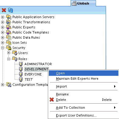

Roles
You can assign a user to one or more roles. If you assign multiple roles with conflicting privileges, then the user is granted the more permissive privilege, which is the union of all the privileges granted to the multiple roles. For example, if you assign to the same user a role that allows creating a snapshot and a role that restricts it, then the user is allowed to create snapshots.
To assign a user to a role that does not display on the Available Roles List, close the editor, create the new role, and then edit the user account. To create a role, right-click Roles under the Security node in the Globals Navigator and select New Role. For information on creating and editing roles, see Defining Security Roles and Editing Role Profiles.

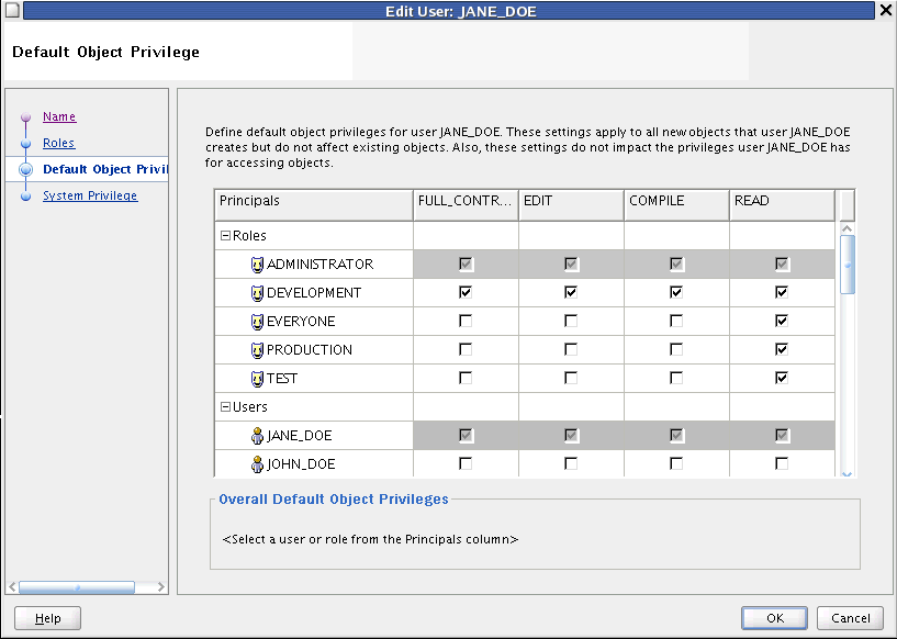

Default Object Privilege
Default object privileges define the access other users and roles have to objects that the selected user creates. These privileges do not impact the privileges the user has for accessing objects created by other users.
For example, for all objects that JANE_DOE creates, JANE_DOE, and ADMINISTRATOR and DEVELOPMENT roles, have full access. EVERYONE, PRODUCTION, and TEST roles are restricted to read-only.
Description of object_priv_01.gif follows
If you are familiar with UNIX operating system security, the default object privilege is similar to the UMASK command. When you edit the default object privilege, the change only effects objects the user creates subsequently; there is no effect on previously created objects. Therefore, if you set default object privileges early, you can expect little or no additional object-level security management.
To define the privileges other users have to objects the selected user creates, check the appropriate box for each role or user. You can grant the following privileges: FULL CONTROL, EDIT, COMPILE, and READ. All the privileges are additive. If you select COMPILE, then you apply both the compile and read privileges.
Access may be granted both to roles and to individual users. Note, however, that when you grant access to a role, the privilege is extended to all users in that role. For example, even though JOHN_DOE is not specifically granted access, he has read access through the EVERYONE role. Furthermore, if JOHN_DOE is a member of the DEVELOPMENT role, he has full control and access.
By default, when you create a new user, the EVERYONE role has full control on all objects. To enable metadata security, edit all user profiles and restrict the access the EVERYONE role has to objects each user creates.

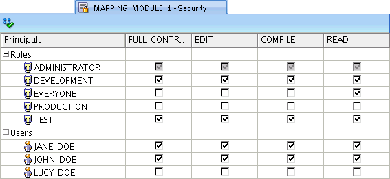

Securing Metadata Objects Throughout their Life Cycle
Default object privileges work with object security properties to provide security options throughout the life cycle of a given metadata object. Settings you specify on the Default Object Privilege tab persist until a qualified user overrides the restrictions, on an object-by-object basis.
Assume that JANE_DOE creates several mappings. When JANE_DOE designs and develops these objects, the security policy described earlier in this section may be desirable. However, assume that JANE_DOE completes the mappings and releases the objects to the testing team. In this case, the default object privilege is too restrictive. To extend access to the TEST role, JANE_DOE can select the mapping, then from the View menu, select Security. She can then manually add all necessary privileges to the TEST role.
Description of object_priv_02.gif follows
For more details on overriding the default security on an object by object basis, see "Applying Security Properties on Specific Metadata Objects".

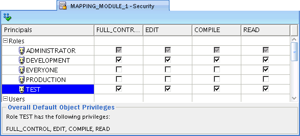

Object Privileges
Object privileges apply to all metadata objects in the repository including projects, modules, and collections.
FULL CONTROL
Full control includes all the other privileges plus the ability to grant and revoke privileges on an object. Only users with full control over an object can override default security on an object-by-object basis as described in "Applying Security Properties on Specific Metadata Objects".
EDIT
The edit privilege includes the compile, and read privileges. Additionally, edit allows users to delete, rename, and modify an object.
COMPILE
The compile privilege includes the read privilege and enables you to validate and generate an object.
READ
The read privilege enables you to view an object.

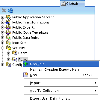

To create a role:
  1. In the Globals navigator, expand Security.
  2. Under Security, select Roles.
  3. Right-click Roles, and select New Role.
    Description of new_role_01.gif follows

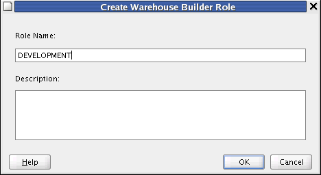

  4. On the Create Warehouse Builder Role screen, enter the Role Name.
    Description of new_role_02.gif follows
  5. Click OK.

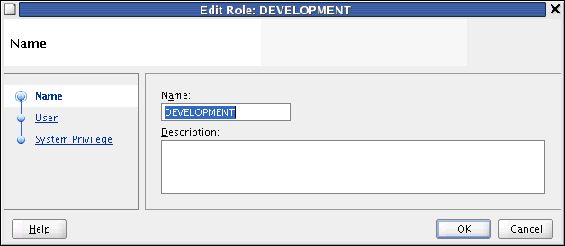

To alter default security privileges for a role:
  2. Under Security, expand Roles.

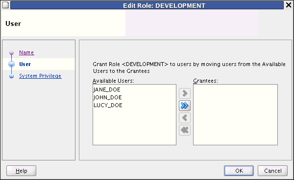

  3. Select the role to edit, and right-click. From the menu, select Open.
    Description of edit_role_01.gif follows
  4. In the Edit Role: RoleName window, you may do any following:
  5. When the edits are complete, click OK.
Users
You can assign multiple users to a role. To assign a user that does not display on the Available Users list, then close the editor, create the user from the Security node in the Globals Navigator, and then edit the role. To create a user, right-click Users from the Security node and select New User. For information on creating and editing users, see Registering Database Users and Editing User Profiles.
You can grant or restrict access to metadata objects on an object-by-object basis.
To change security properties of a specific metadata object:
  1. Select the metadata object for changing.
  2. From the View menu, select Security.
  3. Edit the security privileges for the object, granting and revoking them either at Role level, or at User level.
    Description of object_priv_03.gif follows
  4. When all changes are made, from the File menu, select Save All.
    Confirm changes.
Security Tab
Use the Security tab to define metadata security on an object-by-object basis. Only users that have full control privileges on an object can change the metadata access controls on the Security tab. Security properties are important in managing the life cycle of your projects, as described in "Example: Using Security Properties to Freeze a Project Design".
While the Default Object Privilege defines metadata security for objects a specific user creates, the Security tab overrides that metadata security policy on an object-by-object basis. Assume that JANE_DOE is a developer that creates mappings and process flows. If you want all objects created by JANE_DOE made available to another developer, such as JOHN_DOE, then use the Default Object Privilege. However, to make only a few objects created by JANE_DOE available to JOHN_DOE or even every user who has a TEST role, locate each object in the Design Center and alter its security options.
To enforce a full metadata strategy, edit the security properties for all projects in the Project navigator. By default, the EVERYONE role has its object privileges set to full control. Change the EVERYONE role privilege to be more restrictive and select Propagate Security Settings icon to apply the changes to all children.
