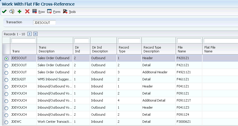

5.2 Setting Up Flat File Cross-Reference
When you enable Z events, you also update the Flat File Cross-Reference (F47002) table. The transaction type that you entered in the processing option maps to table F47002 to determine which interface tables to use to retrieve the information. You use the Flat File Cross-Reference program (P47002) to update table F47002.
Setting up flat file cross-reference
This image is described in surrounding text
Refer to the JD Edwards EnterpriseOne Applications Data Interface for Electronic Data Interchange Implementation Guide for instructions on setting up the flat file cross-reference application.

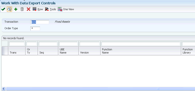

5.3 Setting Up Data Export Controls
You must create a Data Export Control (F0047) record for each transaction type. The record specifies the vendor-specific UBE or function to call to process the transaction. For example, for transaction type JDESOOUT you must set up a record for each order type that you want to export.
On JD Edwards EnterpriseOne Menu, select JD Edwards EnterpriseOne Menus > Order Management > Sales Order Management > Sales Order Advanced & Technical Ops > Sales Interoperability > Data Export Controls.
An alternative way to access the Data Export Controls program is to type P0047 on the Fast Path.
  • This image is described in surrounding text
Values for fields shown in the diagram above include:
Form Element Description
Trans The values you specify in this field must match the values you have configured for JD Edwards EnterpriseOne outbound processing in the various JD Edwards EnterpriseOne applications. These are example transaction types:
JDEAB
JDEIL
JDEPRICE
JDESOOUT
Or Ty The values you specify in this field must match the values that are required for your system. For example, for WCS these order types are required:
JDESOOUT S4
JDESOOUT SO
Seq 1.00
UBE Name Leave this field blank.
Version Leave this field blank.
Function Name MQOutboundNotify
Function Library: MQSNTFY
This function library is the name of the service program for the JD Edwards EnterpriseOne Adapter for IBM WebSphere MQ running on iSeries.
Execute for Add: 1
Execute for Update: 1
Execute for Delete: 1
Execute for Inquiry: 1
Flat File Export Mode: 0
External Database Export Mode 0
External API Export Mode: 0
Launch Immediately 1

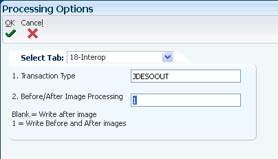

5.4 Setting Up the Sales Order Entry Application
You set up the JD Edwards EnterpriseOne Sales Order Entry (P4210) program to enable it for interoperability operations.
To set up the processing options for Sales Order Entry
On EnterpriseOne Menu, select JD Edwards EnterpriseOne Menus > Order Management > Sales Order Management > Daily Processing > Sales Order Processing > click the arrow to the right of Sales Order Detail and then select Values > on Processing Options, select Interop from the Select Tab options.
  1. To define the transaction type, type JDESOOUT in the Transaction Type field.
  2. To define before or after image processing, enter the appropriate value in the Before/After Image Processing field.
  3. Click OK.

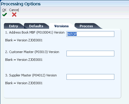

5.5 Configuring the Address Book Revisions Application
You set up the JD Edwards EnterpriseOne Address Book Revision (P01012) program to enable it for interoperability operations.
To setup processing options for Address Book Revisions
On the JD Edwards EnterpriseOne Menu, select JD Edwards EnterpriseOne Menus > Foundation Systems > Address Book > Daily Processing > select the arrow to the right of Address Book Revisions and then select Values > on Processing Options, select the Versions tab.
  1. On Processing Options, type INTOP in the Address Book MBF (P0100041) Version field.
  2. Click OK.
  3. On Work With Addresses, click Close.

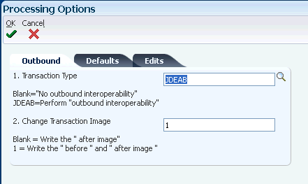

5.6 Configuring the Address Book Master Business Function
You set up the Address Book Master Business Function (P0100041) to enable interoperability operations.
To set up the processing options for the Address Book Master Business Function
  1. Type IV in the Fast Path.
  2. On Interactive Versions -- Work With Versions, type P0100041 in the Application field, and then click Find.
  3. Select the INTOP version, and then select Processing Options from the Row menu.
    If there is not a version called INTOP, select version ZJDE0001 and copy it. Call the new version INTOP and then click OK.
  4. On Processing Options, select the Outbound tab.
  5. Type JDEAB in the Transaction Type field.
  6. To define before or after image processing, enter the appropriate value in the Before/After Image Processing field.
  7. Click OK.
  8. Click Close.
