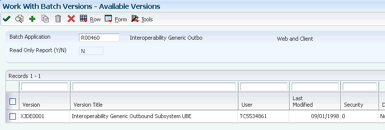

Before you start the R00460 subsystem, you should have already updated the jde.ini file on the JD Edwards EnterpriseOne server to point to the new queue.Type BV in the Fast Path.
On Work With Batch Versions, type R00460 in the Batch Application field, and then select Find.
Select version XJDE0001, and then click Select.
On Version Prompting, click Submit.
On Report Output Destination, select the destination option for your report, and then click OK.
