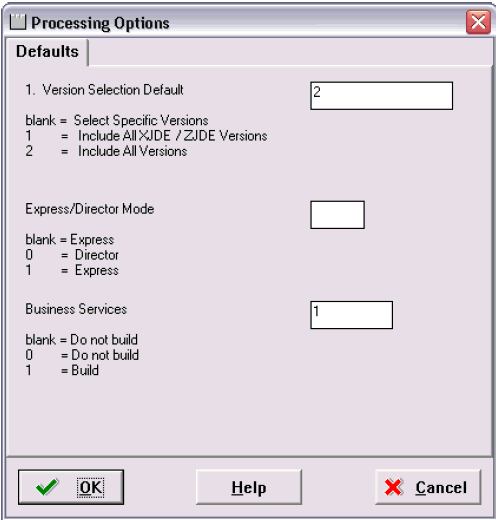

To assemble a Business Services package:
Navigate to the processing options for Package Assembly from to the Package and Deployment Tools menu by right-clicking the Package Assembly application (P9601), and selecting prompt for values.
Set the processing option entitled Business Services to a value of 1.
This processing option is blank by default.Click OK.
