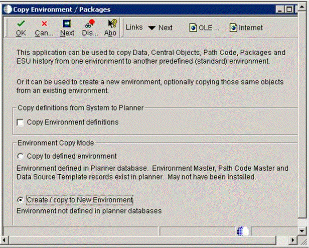

If you have environment definitions, data source definitions, or path code definitions that exist in your System - 910 data source, but which are not defined on the Deployment Server which you will be using in this process, you can check the radio button for Copy Environment Definitions to copy the missing records from System - 910 to Planner - 910.On P989400 - Copy Environment / Packages, click Next.

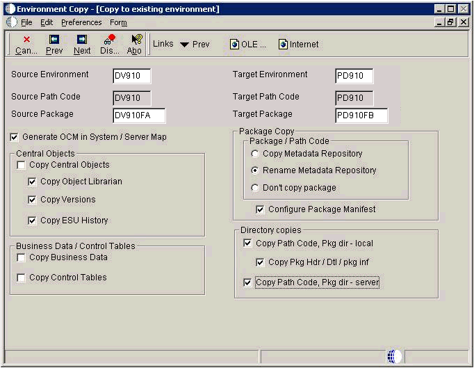

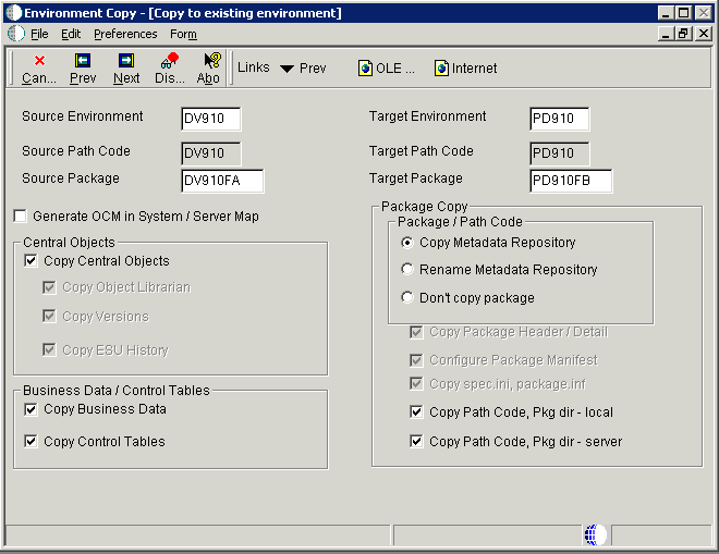

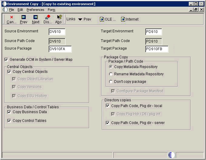

On Environment Copy [Copy to existing environment], complete these fields:
Source Environment
Target Environment
Source Package
Target Package
Any environment copy is dependent on the OCM for the target environment. If the OCM does not currently exist, you can enable the checkbox for Generate OCM in System / Server Map to create data sources and OCM for your target environment before doing the copies.Note:
The Copy Metadata Repository and Rename Metadata Repository options are dependent on certain components having been copied before they are run:The package definition records for the target package must exist before the Copy Metadata Repository or Rename Metadata Repository runs. It is recommended that you allow the Copy Environment process to copy the path code and package on the Deployment Server, because that UBE (which runs before the Copy Metadata Repository or Rename Metadata Repository) also copies the package records and the package.inf.
The Configure Package Manifest option (which is only selectable by running the following step in this procedure) is dependent on both local and enterprise package repositories having been created, and also depends on the target package definition records.
The Rename Metadata Repository option assumes that you have used system or database utilities to copy all the tables in Central Objects to the new database / owner / library.

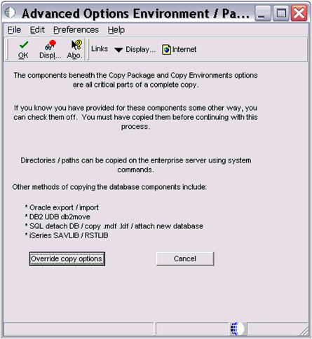

You can override the default copy flags by clicking on the Advanced Copy form exit which displays this screen:
On Advanced Options Environment / Path Codes, if you want to override the default flags, click the Override copy options button.
You are returned to the preceding screen where all the default copy options are unprotected, allowing you to pick and choose which components the process will copy. This non-default method is only recommended if you have provided for the copies in a non-standard way. For example, if you used export / import for Oracle in order to make your own copies of Central Objects.

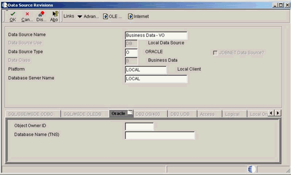

If the data source definitions and OCM for the target environment do not exist, the application generates data source definitions for Business Data, Control Tables, Central Objects and Versions for the target environment. It assumes that the data will be on the same server as the corresponding data sources for the source environment, but you can change this on the Data Source Revisions screens. Below is a sample screen for Business Data:

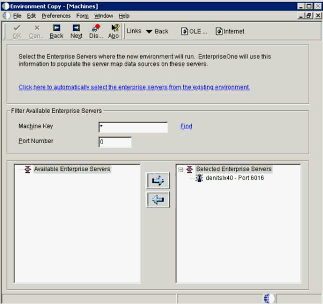

Following the series of Data Source Revisions screens, the next screen Copy Environments - [ Machines].
This screen shows a list of enterprise servers that allows you to select to which enterprise servers you want to copy the package / path codes.
The process submits a UBE to each selected server. The source path code and package must exist on the selected servers.On Copy Environments - [ Machines], highlight the desired machine from the node that lists Available Enterprise Servers and click the large right arrow to add the machine to the node that lists Selected Enterprise Servers.
Click Next.

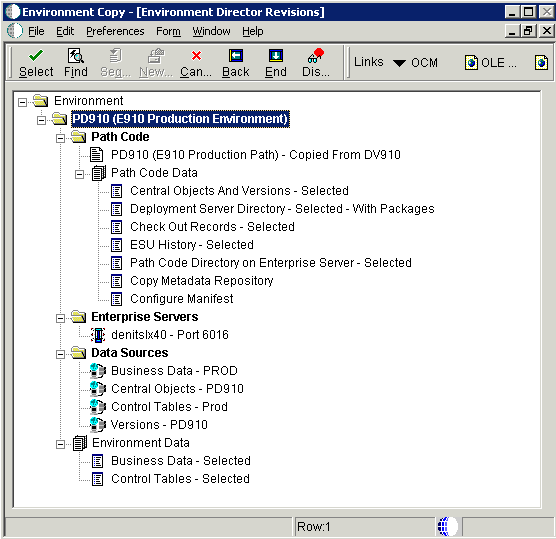

This screen shows lists all the planned function of the processes of running the business functions and UBEs when you click the End button. All UBEs run locally except for the Enterprise Server Path Code copy, which is submitted to the Enterprise Server.
If you selected Generate OCM, a business function runs that generates data sources and OCM in Planner - 910 and copies them up to System - 910. This business function uses the template data source records in F98511, which can be viewed or revised using the Data Source Templates By Environment application on GH9611. The data source template records for the standard environments (DV910, PD910, PS910, PY910) are shipped with the Deployment Server install.

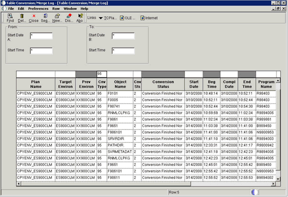

The application writes history records into F984052. To view the history, run the Table Conversion / Merge Log (P984052) on menu GH9611 by filtering on conversion type 95. This screen shows a sample conversion log:

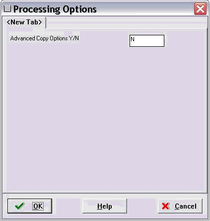

To access the processing options of the Copy Environment Application (P989400), from menu GH9611 right click on the application and select Prompt for Values.
In order to activate the Advanced Copy button, enter a value of Y in this field:
Advanced Copy Options Y/N
Click OK to return to the Environment Copy application and note that a new section with advanced options is available:

For example, if you choose to do all the database copies using database / system tools, you would set the copy options like this:
