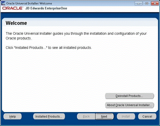

On Oracle Universal Installer: Welcome, select the Deinstall Products ... button.

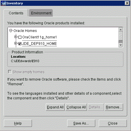

On Inventory, with the Contents tab select, put a check mark next to the Oracle Homes for the Deployment Server Home.
For example, if you followed recommendation in this guide the Oracle Home for your Deployment Server is:
JDE_DEP910_HOME
Select the Remove button.

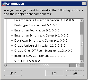

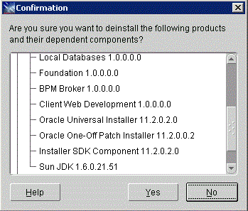

On Confirmation, verify that you want to deinstall the listed components and their dependent components and if so, select the Yes button.

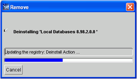

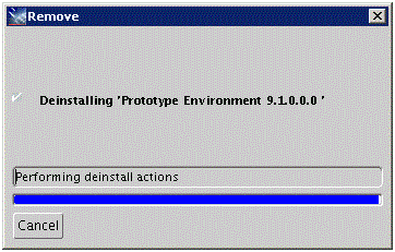

The Remove dialog indicates the progress of the deinstall action.
When the deinstallation process completes, the Inventory is shown again. The products you selected for deinstallation should no longer be displayed in the inventory.

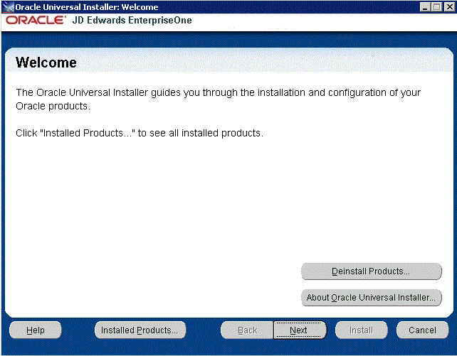

On Oracle Universal Installer, Welcome, click the Deinstall Products… button.

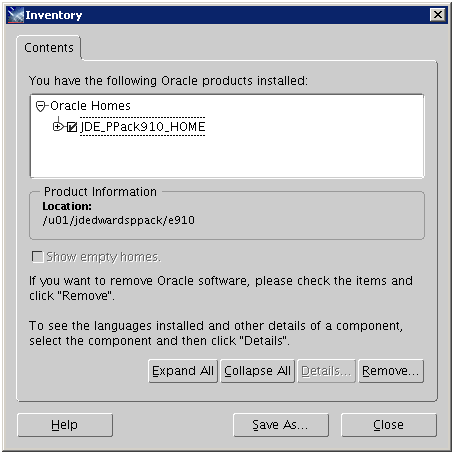

Turn on the check box next to the Oracle Home for the Platform Pack and expand the node to show all installed components. For example, the Oracle Home might be named JDE_PPack910_Home.
At this step, you should select only the Oracle Home that is associated with this particular OUI. That is, the Oracle Home name that you select on this screen should match the Oracle Home name that you selected from Start > Programs.Click the Remove… button.

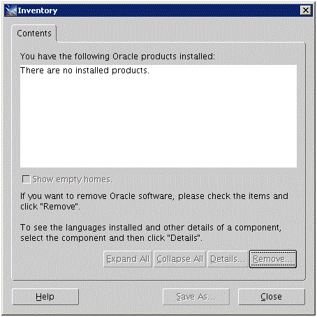

When the deinstallation process complete, the Inventory is shown again. The products you selected for deinstallation should no longer be displayed in the inventory.
