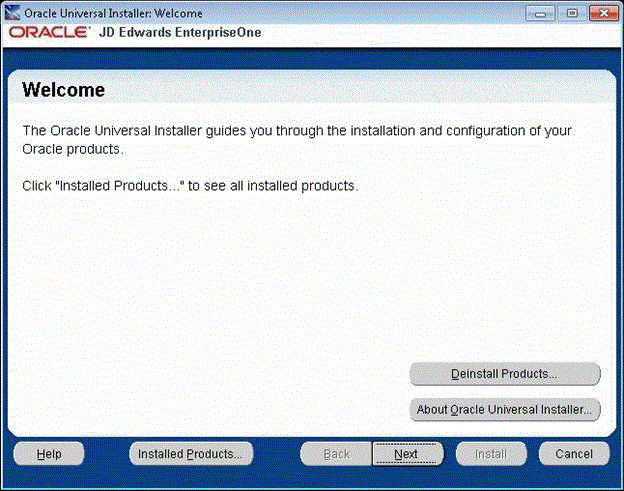

  3. Go to Start > All Programs > Oracle - JDE_DEP910_Home > Oracle Installation Products > Universal Installer.
    Surrounding text describes oui_dep_svr_deinstall_wel.gif.
  4. On Oracle Universal Installer: Welcome, select the Deinstall Products ... button.

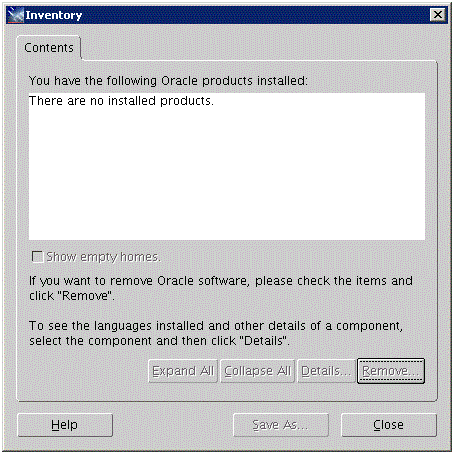

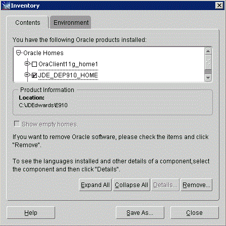

  5. On Inventory, with the Contents tab select, put a check mark next to the Oracle Homes for the Deployment Server Home.
    For example, if you followed recommendation in this guide the Oracle Home for your Deployment Server is:
    JDE_DEP910_HOME
  6. Select the Remove button.

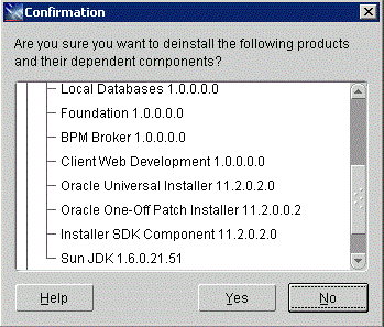

    Surrounding text describes oui_dep_svr_deinstall_con.gif.
  7. On Confirmation, verify that you want to deinstall the listed components and their dependent components and if so, select the Yes button.

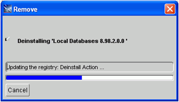

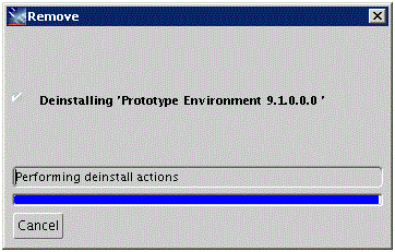

    Surrounding text describes oui_dep_svr_deinstall_prog.gif.
    The Remove dialog indicates the progress of the deinstall action.
    Surrounding text describes oui_dep_svr_deinstall_done.gif.
  8. When the deinstallation process completes, the Inventory is shown again. The products you selected for deinstallation should no longer be displayed in the inventory.
  9. Select the Close button.

  4. On Oracle Universal Installer, Welcome, click the Deinstall Products… button.

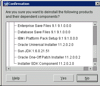

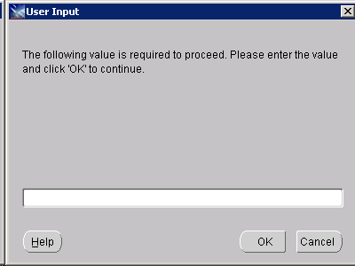

  8. On User Input, you must enter the password for the account you used to run the install. For example, enter the password for QSECOFR. Then click on OK
  9. Click the OK button.
