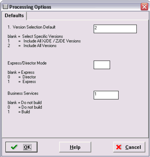

12.7 Assembling a Package that Contains Published Business Services
To assemble a Business Services package:
  1. Navigate to the processing options for Package Assembly from to the Package and Deployment Tools menu by right-clicking the Package Assembly application (P9601), and selecting prompt for values.
    Surrounding text describes packg_assembly_proc_opts.gif.
  2. Set the processing option entitled Business Services to a value of 1.
    This processing option is blank by default.
  3. Click OK.
