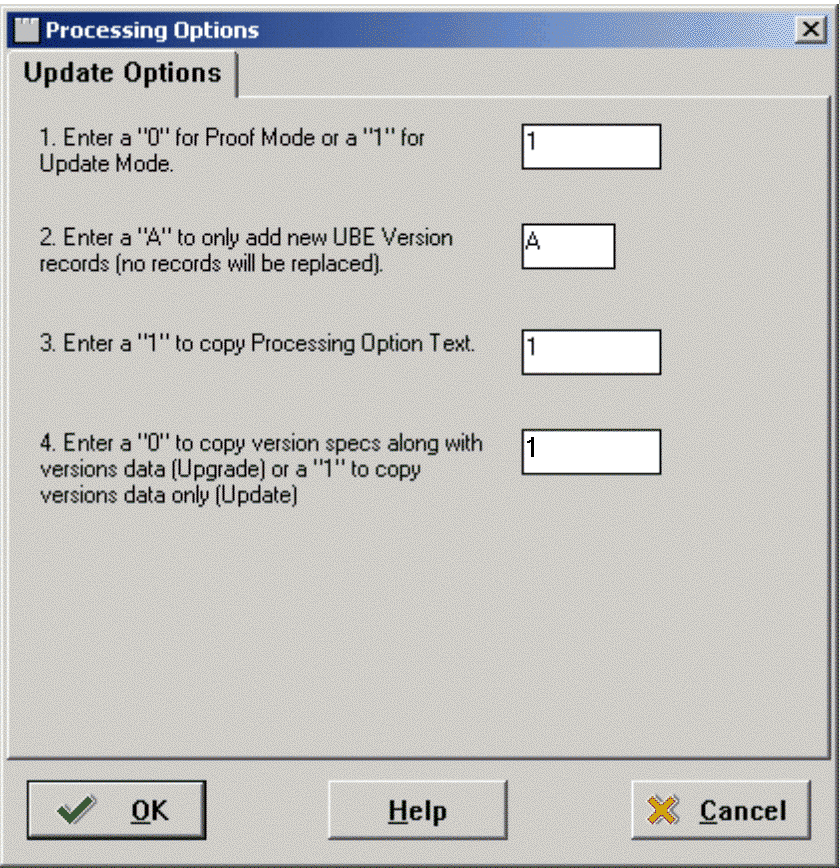

Transfer PD versions to prototype so the two environments are the same.
Run R9830512.
Select ZJDE0001 and click Copy.
Create a new version name and a new version title.
Leave security set at 0.
To select the new version on the version prompting form, check the Data Selection box.
Select the advanced options to bring up the Advanced version prompting form and select to Override Location.
Click Submit.
When prompted for the override location, select LOCAL.
Modify the data selection logic like this:
where BC Version History (F983051) is not equal to "XJDE0000-XJDE9999", and BC Version History (F983051) is not equal to "XJDEAAAA - XJDEZZZZ"
When prompted to enter processing options, ensure that they are set at 1, A, 1, and 1, as shown on this screen:
Click OK on printer selection.
Click OK.

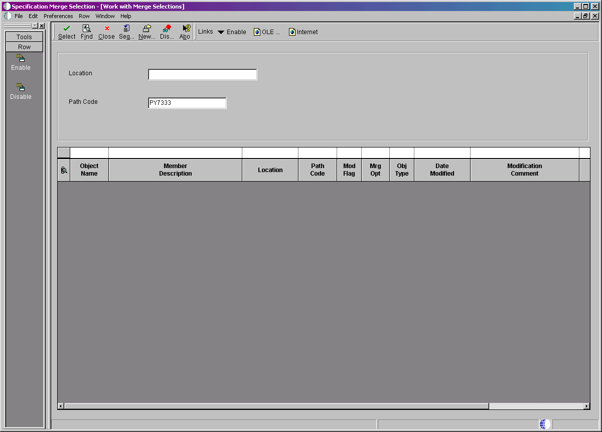

This task ensures that your modifications are carried forward to the new release. Before you upgrade, perform the steps to review or set the modification flags on the Object Librarian records for all modified objects.
Caution:
Do not run the Specification merges until you check the flags for all pathcodes containing modified objects.To check modification and merge flags:
Logon to the workstation or to the deployment environment on the Deployment Server.
On the menu (GH9611), select Specification Merge Selection.
On the Specification Merge Selection form, complete these fields:
Location
Enter the name of the Deployment Server that is the check-in location for this pathcode.
Path Code
Enter the name of the associated pathcode (prototype or development).
On the QBE line, enter C in the Mod Flag field to list the changed objects, and then click Find.
Set the MrgOpt field to 1 for all objects except those you do not want to merge; use Enable to carry changed objects and use Disable to not carry changed objects.
When you finish reviewing or modifying the records, click Close.
