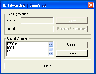

Below is an example of SnapShot managing multiple tools releases including Xe, 8.11 SP1, and 9.0 (B9PD).

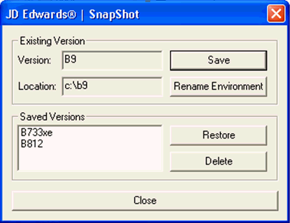

On JD Edwards | SnapShot, click the Save button.
On Make a New SnapShot, complete these fields:
SnapShot Name
Enter a name for the SnapShot that will be saved. You may choose any name, but a recommended scheme is to make it release specific, for example, Xe, B9, or E910.
New Folder Name
SnapShot does not rename or move the installed directory on the Deployment Server; therefore, do not change this value.
Click the OK button.
SnapShot saves a snapshot of the Deployment Server.
