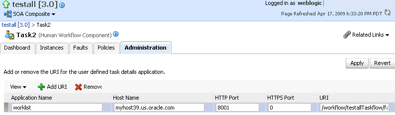

You can add or remove the URI of the task details application used in human workflow.
To manage the URI of the human task service component task details application:
Access this page through one of the following options:
| From the SOA Infrastructure Menu... | From the SOA Folder in the Navigator... |
Select the human task service component in the Component Metrics table.
Click Administration.
The Administration page shows the URI for the task details application.
If the SOA server is SSL enabled or disabled, then you must manually enable or disable SSL for any already deployed workflow task detail applications. Change the workflow task display URL to use the correct protocol and port number. To enable the use of the SSL (HTTPS) URL, ensure that the HTTP port setting is left blank.Click the Add icon to specify the following details for the URI:
Application name
Hostname
HTTP port
HTTPS port (optional)
URI
Click Apply.
