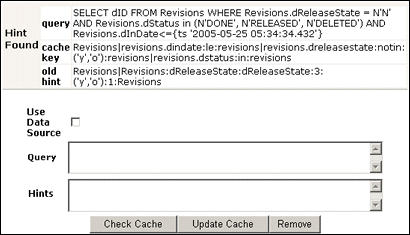

Example: Batchloading Unindexed Content
If you have just batchloaded 100K content items into the Content Server and they are not yet indexed, the index-based query used above (Example 2: Using Different Hint Cache Entries) would match all of the batchloaded documents.
QueryA:
If most of the batchloaded documents have not been indexed, the dReleaseState index that is used in this query is not the best choice. For the best results in this case, you should fine tune the hint cache entry to use both the dReleaseState and the dStatus indexes. Use the Hint Cache Updater Page to update hint cache entries.
SELECT dID
FROM Revisions
WHERE Revisions.dReleaseState = N'N' AND Revisions.dStatus in (N'DONE', N'RELEASED', N'DELETED') AND Revisions.dInDate<={ts '2005-02-23 17:46:38.321'}
QueryB:
After updating the hint cache entry, the new optimized query is:
SELECT/*+ LEADING(revisions) INDEX (revisions dReleaseState dStatus)*/ dID
FROM Revisions

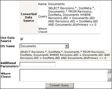

To access the Query Converter page, select Administration, then Oracle Query Optimizer, then Query Converter. The Query Converter Page is displayed.
The following tasks are involved when you use the Query Converter:
To convert a data source query.
If applicable, select Use Data Source.
The data source-related fields are displayed on the Query Converter page.
Select the desired data source from the DS Name menu.
The data source query is displayed in below the DS Name field.
Enter the applicable information for additional parameters and WHERE clauses.
Click Convert Query.
The data source is converted and the results are displayed in a text area above the Use Data Source checkbox. To view an example of a converted data source query, see Figure 4-4.

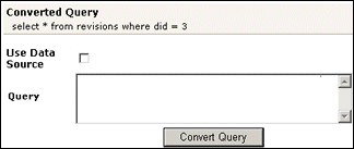

To convert a query:
If applicable, unselect Use Data Source.
The data source-related fields are hidden from the Query Converter page.
Enter the applicable information for the query.
The query is converted and the results are displayed in a text area above the Use Data Source checkbox. To view an example of a converted query, see Figure 4-5.
Figure 4-4 Example of Converted Data Source Screen
Figure 4-5 Example of Converted Query Screen

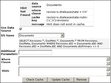

To check the hint cache using a data source:
On the Hint Cache Update page, select Use Data Source.
The data source-related fields are displayed on the Hint Cache Updater page.
Enter the applicable information for the additional parameters, WHERE clause, and hints.
Click Check Cache.
The results are displayed above the Use Data Source checkbox. To view an example of an unsuccessful hint search, see Figure 4-6.
Figure 4-6 Example of Hint Cache Updater Results with Data Source

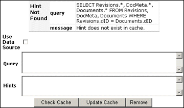

To check the hint cache using a query:
On the Hint Cache Update page, ensure the Use Data Source checkbox is unselected.
Enter the applicable information.
Click Check Cache.
The results are displayed above the Use Data Source checkbox. To view an example of an unsuccessful hint search, see Figure 4-7. To view an example of a successful hint search, see Figure 4-8.
Figure 4-7 Example of Hint Cache Updater Results without Data Source

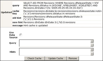

To modify a hint cache query using a data source:
On the Hint Cache Updater page, select Use Data Source.
Click Update Cache to overwrite the previous hint cache.
The results are displayed in a text box above the Use Data Source checkbox. To see an example of successfully adding a new hint to a query and updating the hint cache, see the screen capture included in this section.
To modify a hint cache using a query:
On the Hint Cache Page, ensure that the Use Data Source checkbox is unselected.
The results are displayed above the Use Data Source checkbox. In the screen capture note that the new hint was added and the hint cache was updated.
Figure 4-9 New hint added, hint cache updated

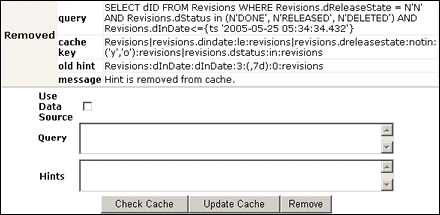

To remove a hint cache query:
On the Hint Cache Updater page, ensure that the Use Data Source checkbox is unselected.
Enter the applicable information for the query and hints.
Click Remove.
The results are displayed above the Use Data Source checkbox. In the screen capture note that the previously added hint was deleted from the query and hint cache.
Figure 4-10 Example of a deleted hint from cache
