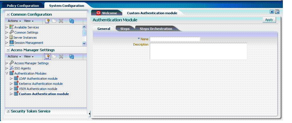

Figure 8-8 shows the Custom Authentication Module within the Access Manager Settings section of the System Configuration tree. You can also see three subtabs where you enter information for the module.
Figure 8-8 Custom Authentication Modules Node and General Subtab
Description of "Figure 8-8 Custom Authentication Modules Node and General Subtab"
The General subtab provides space for the module Name and an optional description. The name can be up to 60 characters. The optional description can be up to 250 characters.

Creating a Custom Authentication Module
Users with valid Administrator credentials can use the following procedure to create custom authentication module that uses one or more authentication plug-ins.
Prerequisites
Ensure that any user identity store associated with the module is running and includes the required user population.
To create a custom authentication module using bundled plug-ins
  1. From System Configuration tab, Access Manager Settings section, expand the Authentication Modules node.
  2. Create New:
    1. Click the Custom Authentication Module node.
    2. Click the Create (+) button.
    3. Add General Information: Name and optional Description. For example: CustomX509Plugin and Plugin for X509, respectively.
      Click Apply to save general information.
  3. Add Steps:
    1. Click the Steps subtab.
    2. Click the Add (+) button above the Steps table.
    3. In the Add New Step dialog box, enter a unique Step Name and optional Description.
    4. Browse for and select the desired plug-in name and click OK.
    5. Confirm information in the results table.
    6. Repeat b through e to add other steps until you have listed all required plug-ins for your module.
  4. Configure Details for Each Step: Use appropriate values for requested parameters (Table 8-11 and Table 8-13):
    1. Click a StepName in the table to reveal required details.
    2. Enter appropriate values for the requested details.
    3. Click the Save button.
    4. Repeat a through d to configure each step appropriately.
    5. Ensure that users are provisioned in any user identity stores assigned in steps.
  5. Orchestrate Steps: See Table 8-12 as you perform following steps.
    1. Click the Steps Orchestration subtab.
    2. From the InitialStep list, choose the name of the first step to be used.
    3. Select a StepName in the table.
    4. From the OnSuccess List, choose a condition (success or failure) or a step name name.
    5. From the OnFailure List, choose the desired condition or a StepName.
    6. From the OnError List, choose the desired condition or a StepName.
    7. Repeat c through e to orchestrate operations for each plug-in this module.
    8. Review your orchestration.
  6. Initiate Strategy Validation: Click Apply to initiate validation of your orchestration strategy:
    • Successful Strategy: The orchestration strategy is applied and the module is ready to include in an authentication scheme. Continue with Steps 9 and 10.
    • Invalid Strategy: Click OK in the Error box, then edit your OnSuccess, OnFailure, OnError strategies (or add or remove plug-ins) to correct the problem. Repeat this step until your strategy is successful.
  7. In the navigation tree, confirm the new Custom Authentication Module is listed, and then close the page when you finish.
  8. You are ready to use the custom module in an authentication scheme.
